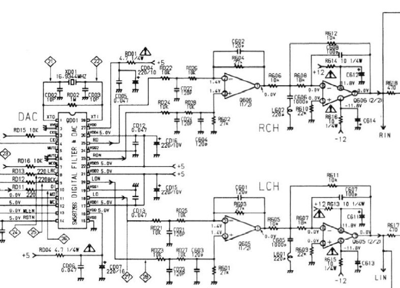

Alien8,
Thank you for your advice. I have done some mods recommended by TNT-Audio including replacing the OPamp with the LM6172. There were significant improvements.
However once tried connect the DAC output directly I found the sound was much much better but the high frequency noise was also there. That's why I want to build a passive filter.
Here is the schematic:

Well I was right about the summation, so unless you have a full symmetric system, you're one way or the other are going to have to sum them together. That means you need the summing opamp.
One thing you could try is to tap in at the output of the summing opamp and use the rc there, try 400 ohm + 10 nF to the output.
That *should* work as your pic says it is 0V offset.
The neat thing is you can leave the rest in as you try...
That should give you 6dB/oct filtering, probably the rest of your system and your ears will do the rest.

Alien8 and Zombie,
Thanks a lot for your advice.
One guy on AA wrote:
"I bypass op-amp too and it's improvement too. SM5872 have 2V output and I used tube amp. I directly connect Pin 18 and 25 to RCA with just shunt R on each."
He also said that a coupling capacitor is needed.
It seems that he does not sum the + and -. Are there any problem with this approach?

Hmm
come to think of it, that might work. The difference between + & - terminals is the signal's 180 deg out of phase. I just wonder if the dac chip will be ok with asymmetric loading ?
you'll for sure need a coupling cap, your service manual says there's 1.4 V dc there, you'd rather get rid of that if you don't want to see smoke somewhere
Well, go ahead and try it I'd say !

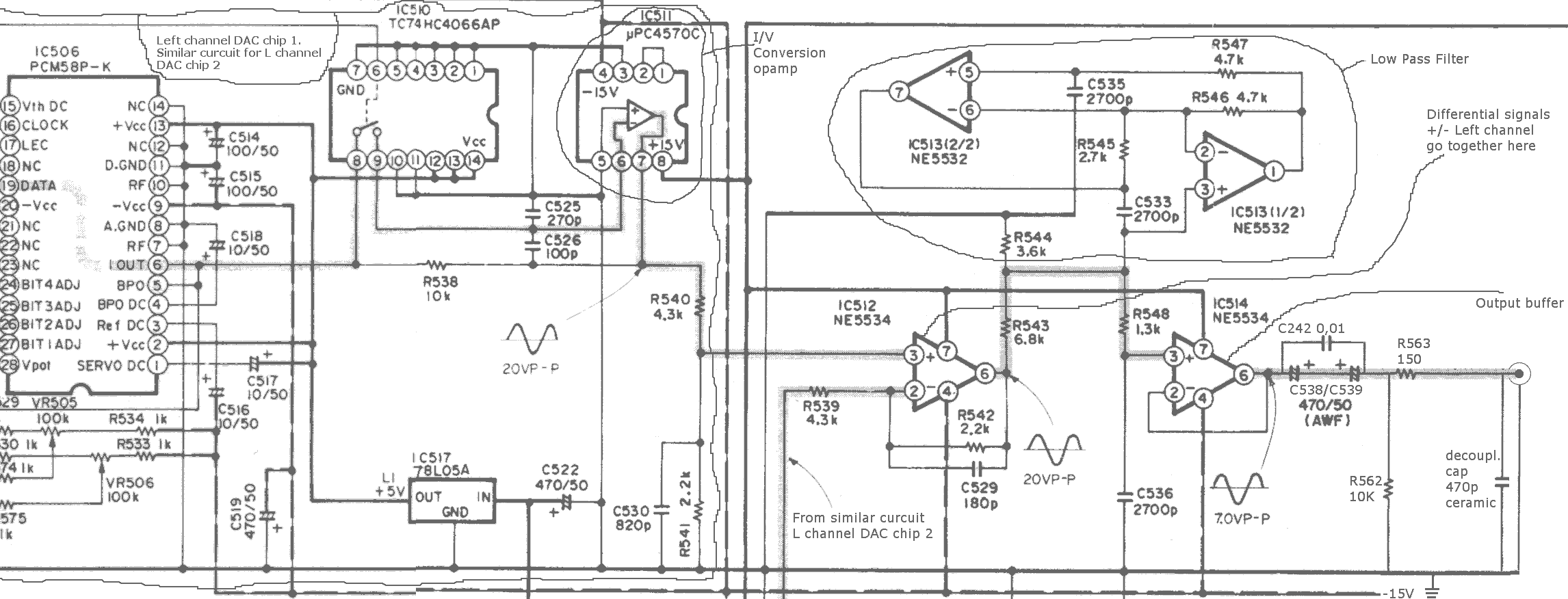

The Dac’s outputs are not simply an inverted complementary pair; the modulation scheme used by the SM5872 (which uses commentary offset PWM modulation to gain an extra 0.5 bits resolution) requires outputs to be differentially summed to correctly reconstruct the audio signal. Therefore, you MUST use some form of differential summer to gain the full resolution and performance of the DAC.

you have to know the impedance -- but an RC filter will be of some help.
you might want to take a look at the FDNR (frequency dependent negative resistor) threads -- or the spec sheet for the AD713, or Burr-Brown (Texas Instruments) spec sheets on low distortion, low noise anti-aliasing filters.
The only way I know of to differentially sum with Passive components, is to use a transformer, but IMHO these are worst then opamps.
You could increase the order of the passive filter between the DAC outputs and the differential sum Opamp, there by reducing the “RF levels” seen by the Opamp input stage, then take the audio output directly from this Opamp - so there’s only one Opamp in the signal path.
I have always found the AD711 to be a well-behaved Opamp in the presents of RF.
See Cirrus Logic App Note AN48 for 2 Pole filter with differential input.

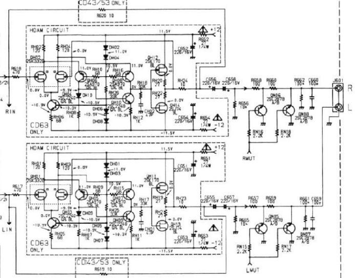

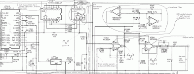

I would like to try to take the signal directly from diff. summing IC512 at pin 6 before R543 and leave out the LPF (IC513) and output buffer (IC514) completely in my Denon DCD3560.
But to avoid the worst HF I want to make a passive LowPassFilter. Can I do that just by replacing R544 with a cap? And which value should it be?
I plan to use OPA627 for IC511 and IC512. Any points of view on this project?
