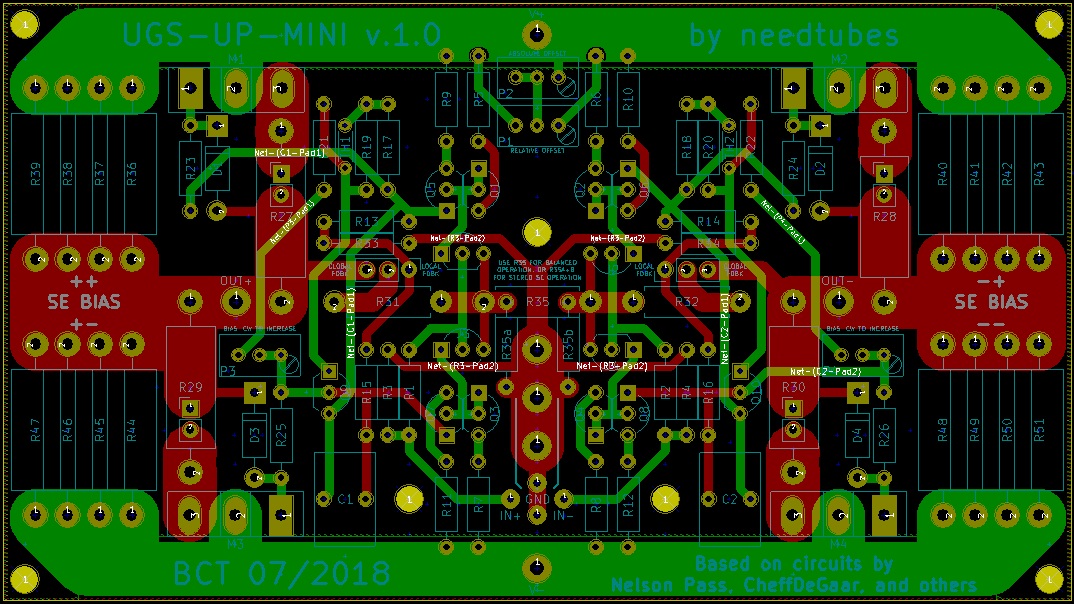

  11. Small-sized PCB to allow compact builds.
  12. Option to use the PCB to build a stereo amplifier instead of an X-amp.

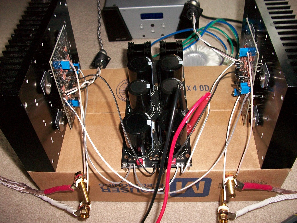

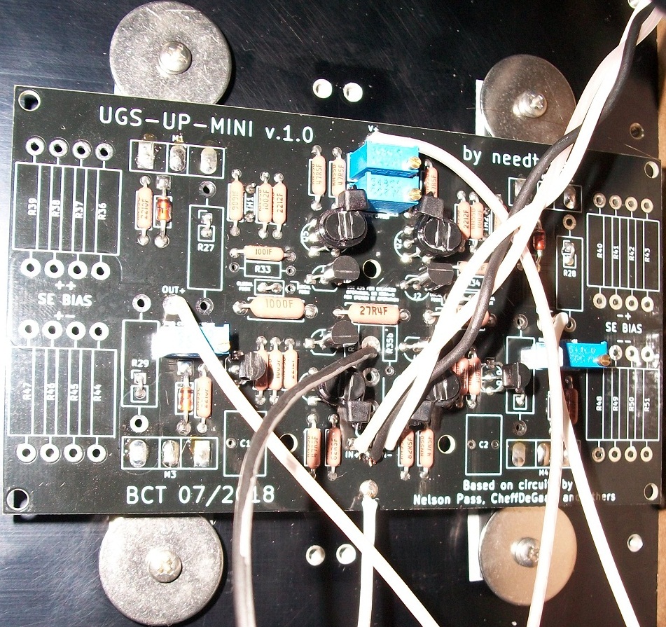

Attached are images of my boards and temporary test build. Circuit description to follow...

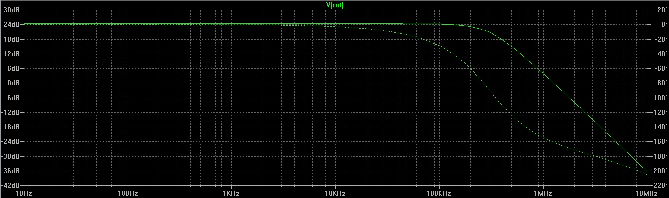

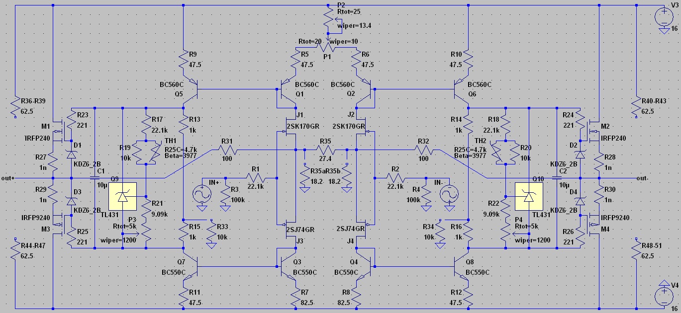

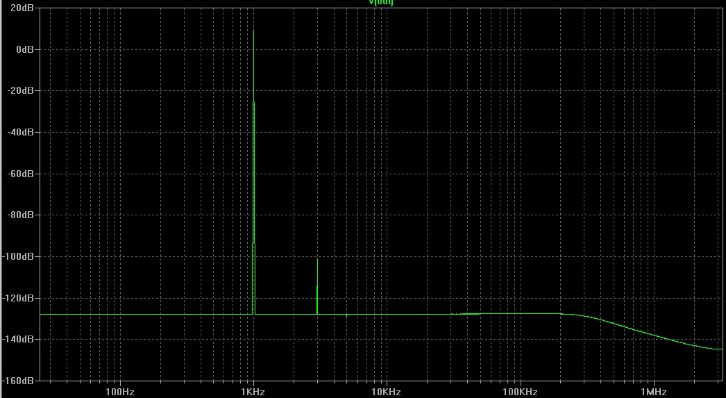

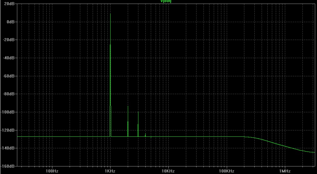

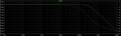

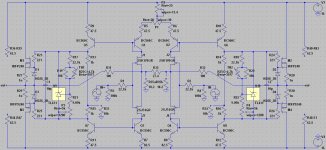

Schematic for the UGS-UP-mini and SPICE predictions (frequency response, FFT for circuit as pictured, and FFT with 10k resistor on negative phase driver stage) are attached. My measurement rig doesn't do balanced output, so I cannot measure the true performance of the amp. Some notes:
  • R35 is used for SUSY operation.
  • R35a and R35b are used instead of R35 to create two separate channels on one board.
  • R33 and R34 are option front-end load resistors to alter the THD spectrum.
  • GR grade JFETs with IDSS around 5mA were chosen since I have these in stock. BL can be used with some changes.
  • The thermistors should be in contact with the heatsink (mount on bottom of PCB).
My heatsinks are around 5" tall by 9" long with 1.25" fins. This gives just enough dissipation for 1A bias per channel (so, 0.5A per phase) on ~16V rails with a 25C rise. One could, of course, scale up the heatsink size and increase the bias. Bias is rock solid, even with no source degeneration (as pictured).
And, lastly, the amp sounds great. Very detailed, clean sound from top to bottom, nice soundstage, although a little forward in its current configuration. Now to experiment with SE bias and different loads on the driver stage...
My thanks to Nelson Pass, CheffDeGaar, and others for inspiring the various pieces of this project.

What prompted the query...
The bias circuit comes from F4 but you can just as well use a Vbe multiplier.
It is not all FET anyhow, unless you change the current mirror BJTs to MOSFETs.
If you are not using NFB, then making R13,14 trimable will allow you to have slightlay different Vgs for P- and N-MOS.
Patrick
I was just idly wondering really. I've seen quite a few variations in something close to this exact circuit from the gr25 double bjt, to the usual Vbe multiplier, to the f4 tl based option to Zen Mod's new hall effect/M2 bias. Needtubes called out the TL in particular and I was intrigued as to why?
ZM's recent effort is pretty cool. :)
The M2 bias is self biasing. No adjustment required.
But you have to have a certain voltage across the source resistors for the optocoupler to work.
It might be a limitation (design constraint) that you do not want.
The TL431 is stable and does not drift with temperature, as a Vbe multiplier does.
But for my taste it is rather noisy, unless you use the On Semi version and bypass one of the resistors.
The right BJT can be very low noise, and it has a negative tempco.
Since most FETs has a positive tempco, so the reduced bias voltage of a Vbe multiplier might not be a bad thing.
Or you just use two resistors and trim them both for bias AND offset.
This is especially useful with lateral FETs as they have a negative tempco and hence self stabilise.
