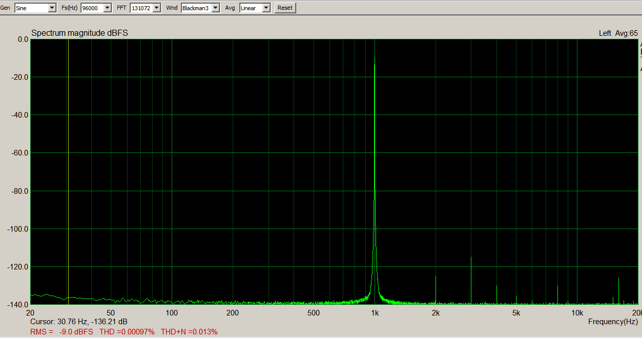

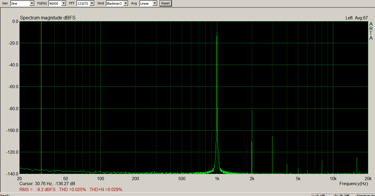

The important thing with the focusrite 2i2 is to ensure that the input is not referenced to ground. fully differential the distortion performance is very good. But if running single ended the distortion goes up significantly.
Using a SE to differential circuit on the input, or even just simply using a TRS plug with only T connected to hot and R connected to earth with no connection to sleeve should improve the results.
I made a simple breadboard differential to SE for the output, thinking the problem was output distortion when in SE mode but that was not enough to fix the problem, the input seems to be key to getting good results.

Example of the difference between balanced loopback and SE loopback on the focusrite 2i2.
I was going to post results with balanced to SE converter and TR connection comming back but I did not get any better than with just an SE loopback, so not sure what happened there as I was sure I had much better results in the past. I'll have to delve a bit deeper.
Balanced was done with physical volume control at max, arta generator output at -6db and input level pot set to get -9db
SE was done without changing anything except the loopback cable.
Tony.
