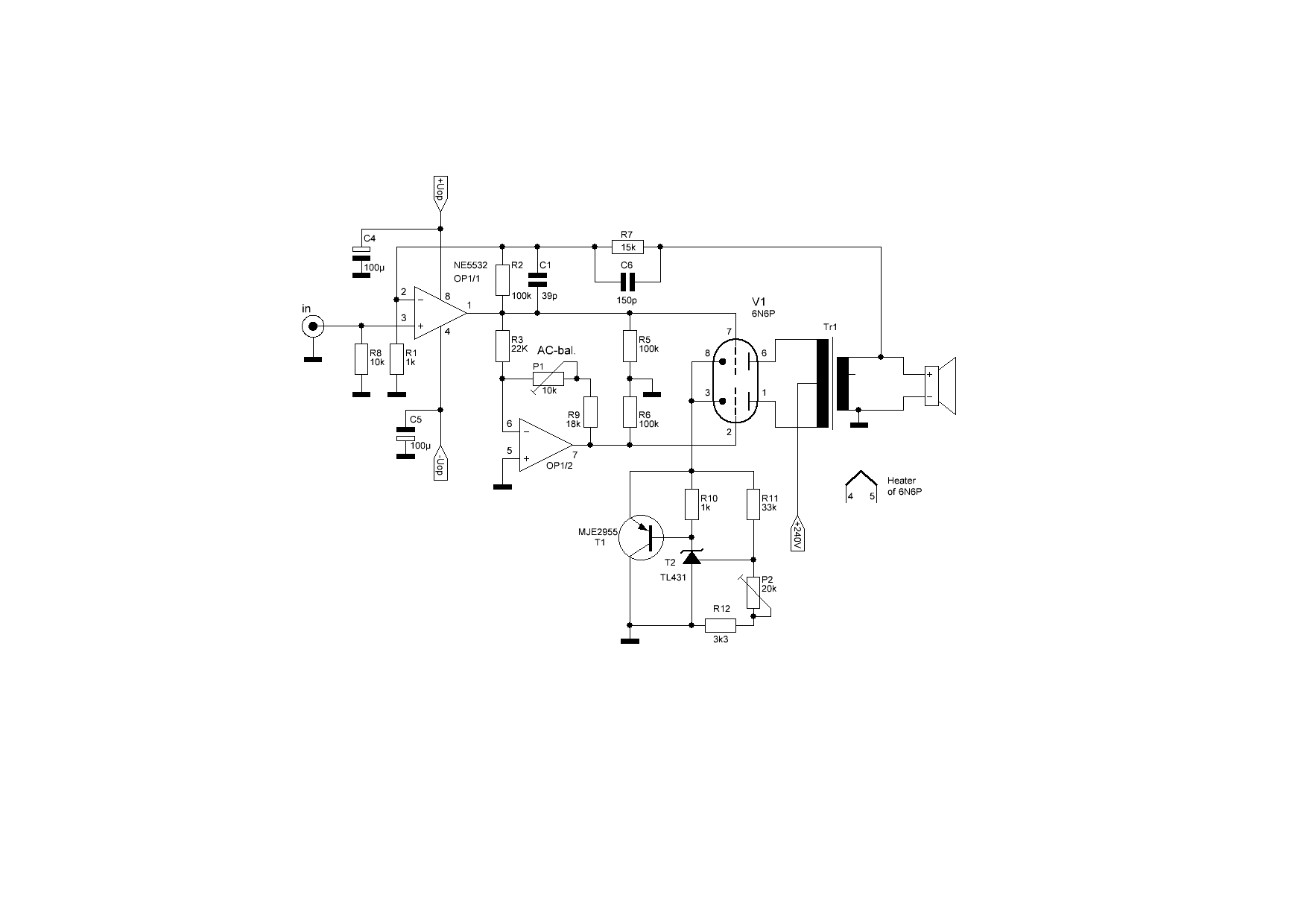

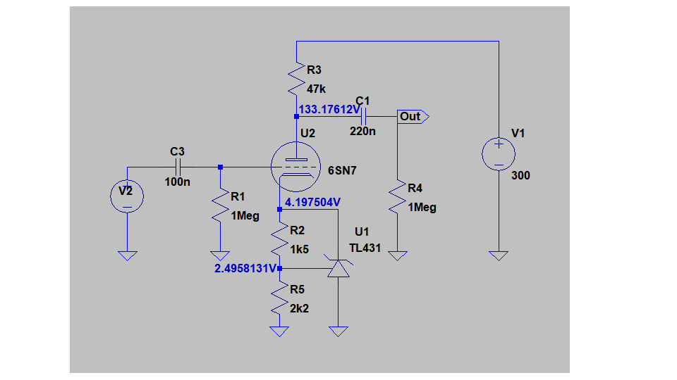

Like this. The desired bias voltage is adjusted with R2 and R5.
The reference voltage at TL431 is always 2.5 V.

TL431 would be excellent replacement for a LED and adjustable between 2.5 V up to 37 V.
Good one! And its data sheet says it can sink up to 100mA. I wonder why we don't see this mentioned more often.
However, wouldn't TL431 have the same problem at low voltages that something like an LM317 (used as a ccs) would have? TL431 reference voltage is 2.5V, so at least that plus a little more must be dropped across the device for it to function. Let's say you use it in this hypothetical 6J5 drawing 4mA plate current, with +4V at the 6J5 cathode. Doesn't that mean the resulting 6J5 with Ip=4mA using TL431 for cathode bias can only accept 1.5V of input signal before the TL431 is in danger of dropout?
But for a driver stage with a 'tall' bias, like a 6J5 with more like Vk=6V and Ip=8mA, a TL431 looks like a great option. Thanks for the tip!
No it does not, because it is not connected as a CCS. It is a CVS and keeps the grid to cathode voltage fixed as long as some (less than) 0.5 mA current flows thru it (and the tube).

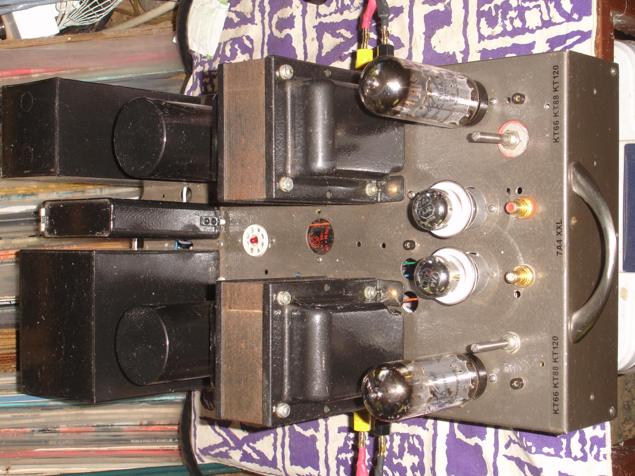

Thanks for the info! Yes, that is a very attractive part for this application. I could have used a couple of those for the headphone amp I just built, to get +2V at the cathode with plate current of 55mA. Better yet, I could have experimented with slightly different grid-cathode voltages instead of accepting the +2.2V I got from paralleled green LEDs. Next time...
Thanks for all the replies! I have read about LEDs here and there, but a more in depth discussion was just what i was interested in. I will give it a go when i get my son who is over 6 foot to move my 60lb amp to the shop . Cheers.
