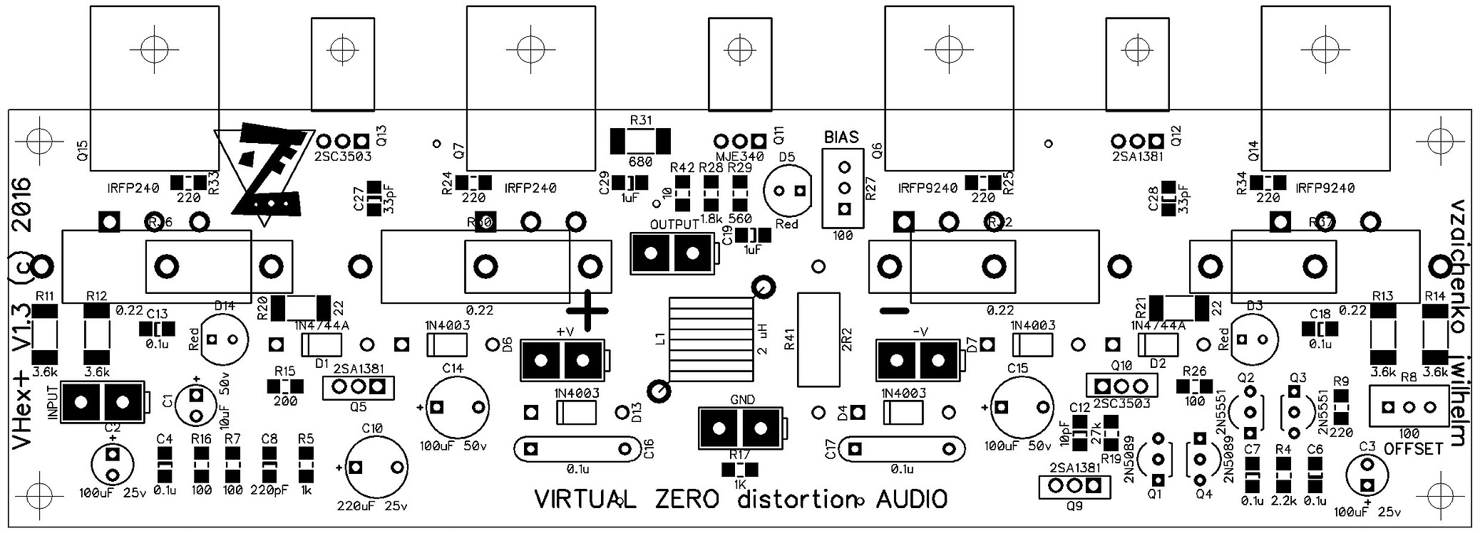

VHex+ amplifier modules, kits and boards
VHex+ started as a fun project and grew into a mature line of amplifiers.
This is a great sounding amplifier, built and appreciated by many people around the globe. Very inexpensive for the level of sound quality it provides.
It's easy to build and very reliable in the long run.
Key specifications with +/-50V rails (VHex+ Classic):
- Maximum output power: 100W @ 8 ohm; 160W @ 4 ohm
- Voltage gain 29db
- Input impedance 27 Kohm
- THD: 1KHz - 0.005%, 10KHz - 0.008%, 20KHz - 0.01% (measured at 50W @ 8 ohm)
- IMD: 14+15KHz - 0.005% (measured at 50W @ 8 ohm)
For VHex+ Classic we offer (note - the price is for a pair!):
- Assembled modules for a stereo amp (without or with the heatsinks);
- Kit for a stereo amp (PCBs + parts);
- Boards set for a stereo amp (PCBs only).
A recent addition to VHex+ product line:
- TubeHex boards set with the tube-based IPS.
PSU boards and Control / Protection System variants are also available.
We provide a comprehensive building guide and technical support for every build.
We do care about the result.
Valery & Jeff
Virtual Zero Audio Store
P.S. 10% discount for your 1-st order (use "welcomefriends" discount code at checkout), valid till August 31, 2018.

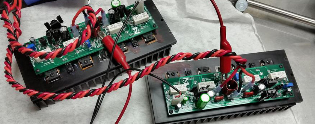

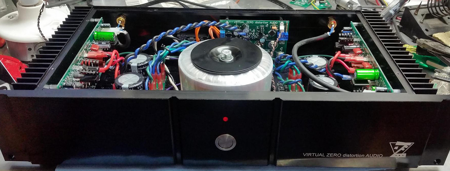

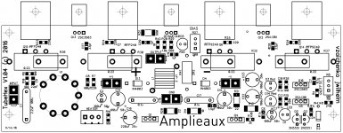

Hallo Valery
A few questions:
What is so special with your solutions?
Why should I buy your VHex+ amps.?
What is the different between the TubeHex and the Classic? Technically and sonic wise ;-)
Why do you think tube at the input stage is a good/ better solution?
greetings
F.S.
Hi Fred,
VHex+ is a combination of simplicity and very high performance.
This design has got a number of specialties:
- the front-end, combination of the LTP, Lender arrangement and a current-driven VAS. It's highly linear, low internal noise, immune to external noises.
- OPS is simple, well temperature-compensated, low-enough distortion and rather inexpensive.
Many builders and testers appreciated the natural, uncolored sounding of VHex+.
The tube at the input is a matter of taste. It's a good input device in general. Both options perform very well, although I didn't run any thorough A/B test.
If you dare to compare them - please share your impressions ;)
In addition - we support every build, making sure the amplifier works as expected. We do care about the result.
Valery

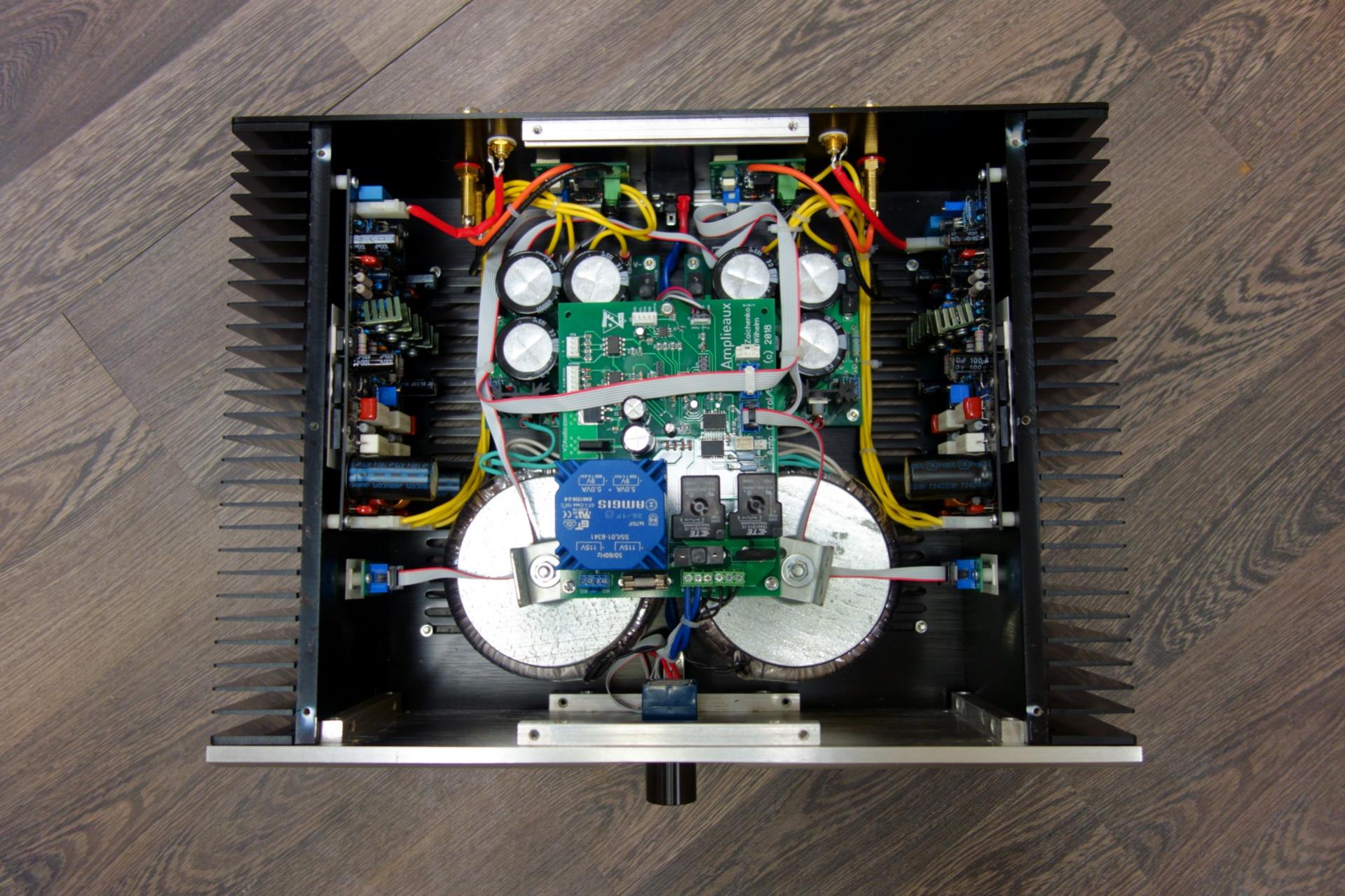

Post your Solid State pics here.
710687d1540197450-post-solid-pics-08-jpg
Which is the "better" amplifier? The VHex or Simplestark?
