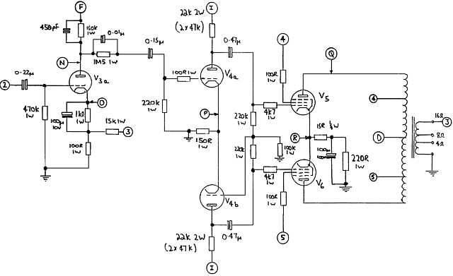

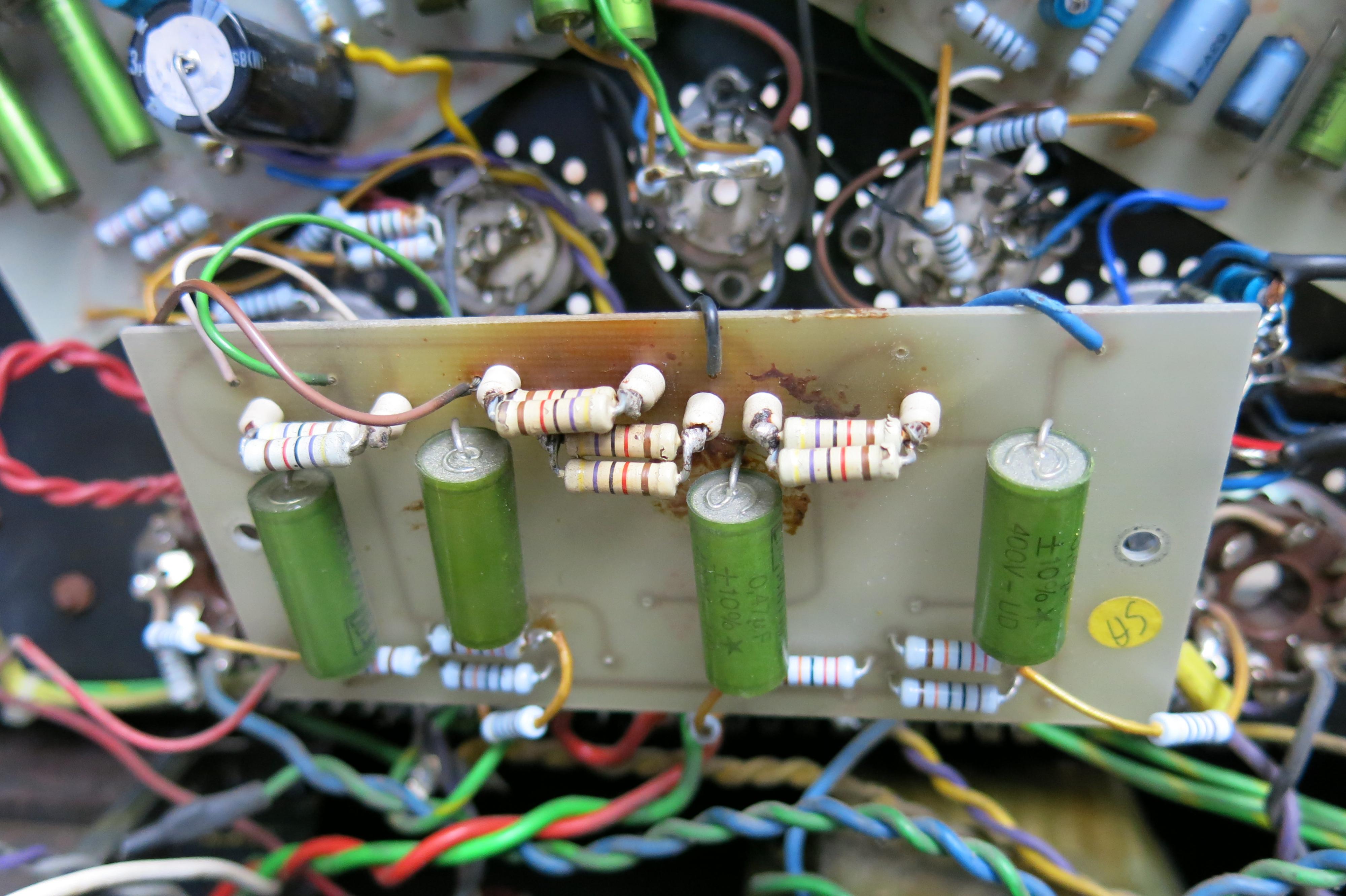

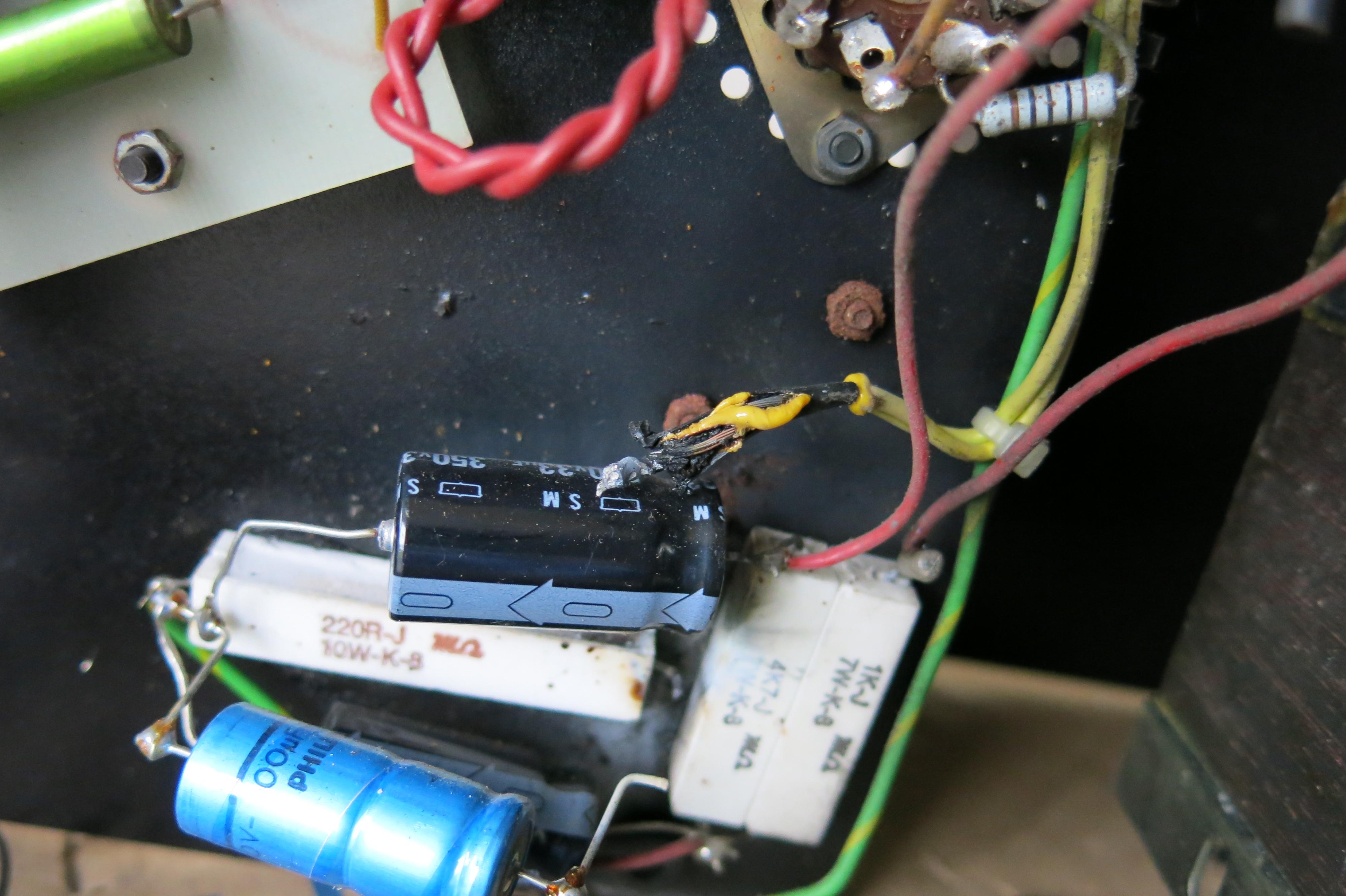

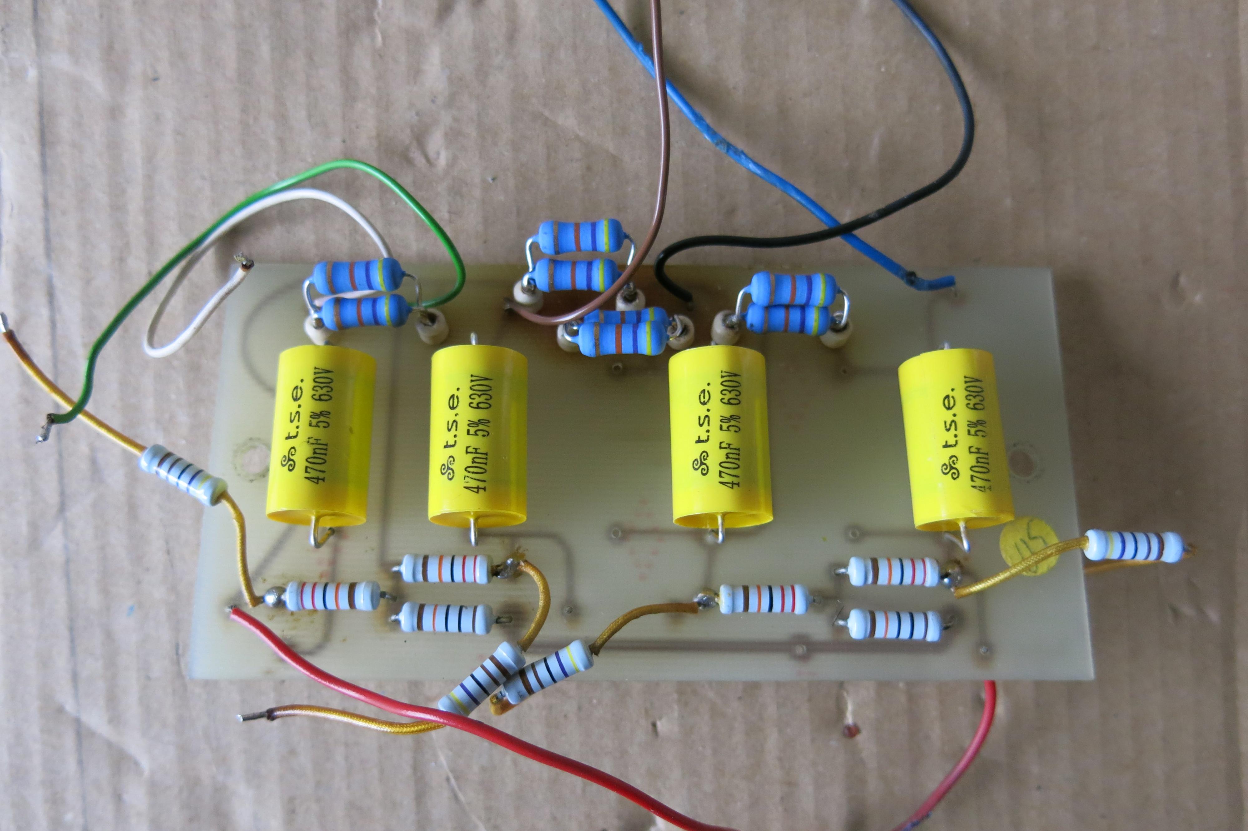

I have repaired 2 of these, I still have one and it is a great amp, they had both cooked their 15 ohm cathode bypass limiter, or worse, because of the green ERO 0.47uF coupling caps leaking.
As John says, start by checking voltages BUT replace the 0.47uF coupling caps if they are as in the picture. The 47k ohms resistors tend to drift high too so do them at the same time. Then check all is still well with the bypass cap and resistors.

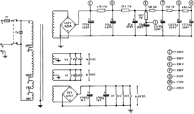

I have enclosed a schematic, I think it is in the public domain so is OK to show. Mods, if it is not allowed, please remove it. Alan
