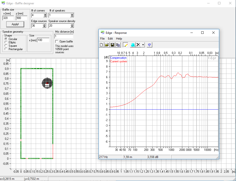

The difference in sensitivity should kind of compensate with baffle step. The results of Edge are in the attachment.

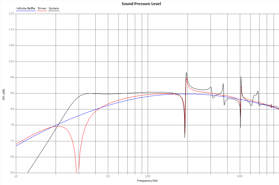

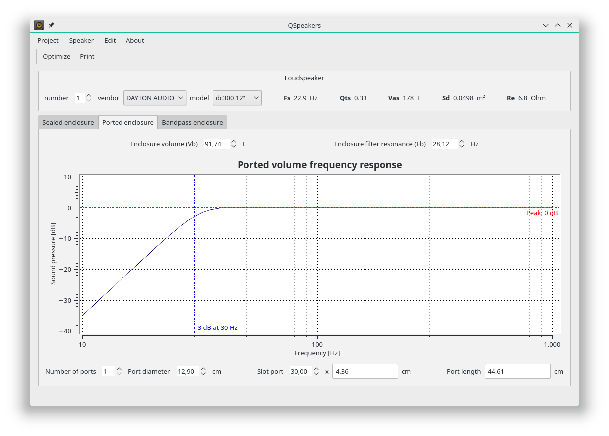

I simulated frequency response with Leonard Audio Transmisson line and QSpeakers. Results are more or less the same: -3dB@30Hz.
Sims told me to make very big and long ports so I drew what I drew, but am thinking of maybe trying to do something with pvc pipes if that is an okay idea?
Please, review my attachments and let me know if there are any obvious and rookie design flaws. I know size will have to be recalculated when I know the thickness of the material and what I will do about the port, but this is basically it.

Thinking some more... the problem might be the nearness of woofer to the FR unit... diffraction and stuff?
hi,
theorically the woofer to FR centre to centre distance should be at most 1/4 wavelength of crossover frequency for best integration of both drivers (there is acoustic coupling if you follow this rule and both drivers should appears as one and only source).
E.G.: if you cut at 343hz so wavelength is 1m, so center to center spacing should be at most 25cm.
This may lead to some diffraction issues yes, but imho you'll end with diffraction issues anyway (as almost all loudspeakers) and to have the drivers not to integrate well may be more troublesome than diffraction.
From the pictures you linked in your post everything should be ok from my opinion ( or not worst than other implementation). This look like typical implementation for me, offset of Fullrange should help about diffraction and if you round the edge of box it should be even better.
So it the xo frequency is even lower, the drivers can easily be placed even farther apart. Good to know.
...or not worst than other implementation). This look like typical implementation for me, offset of Fullrange should help about diffraction and if you round the edge of box it should be even better.
Okay, as long as it isn't worse than other projects. :)
I can't think of a way to better integrate two drivers like this, but if anyone has an idea, please share.

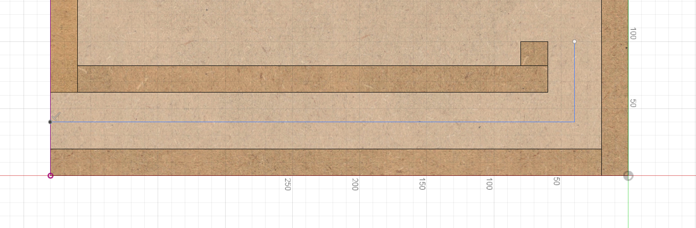

A construction question:
I drew the blue line to measure the lenght of the port and it seems I need that small "lip" over there to make it 45cm. Did I measure the lenght correctly? Is there a better way of constructing ports like this? Maybe make the turn sooner and make the additional wall also act as bracing?

Not really a surprise that there's a wealth of opinion and debate but hopefully the following article is factual.
Horn Folding - a brief study of the centerline vs advanced centerline method - AVS Forum | Home Theater Discussions And Reviews
J.
