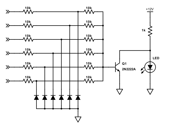

Is there an easy way monitor the voltage of those 6 Amp Ready signals and only light my front panel LED when they're all at -VB?
You need a six input NOR gate, something like this.
Thank you, that's very helpful. I do appreciate your help, but my knowledge isn't good enough to take away a complete solution from that diagram.
Let me try to understand - are you suggesting I should use a 6-input NOR gate IC, and that diagram is simply an illustration of what the IC would do, or is that diagram something I could build from the discrete components shown, i.e. would I simply pass each 'amp ready' signal through a 10k resistor, then tie the outputs together as the base input to that transistor? Is 10k a value that you've selected to be suitable, given that each of my 'Amp Ready' signals will range from -63V ('ready') to +5.6V ('not ready')?
In the case of a single 'amp ready' signal going high to 5.6V, what would stop the other 5, at -63V, from pulling the tied output low?
Would I have to choose a transistor that can cope with -63V, or have those resistors brought the signals to acceptable levels?
This is a NOR circuit. When any input(s) is (are) high, the transistor is on (collector is low).
Then the LED is off, because the 1k current is diverted from the LED by the transistor.
When all inputs are low, the transistor is off (collector is high), so the LED is supplied with
current through the 1k, and it lights up.
This circuit should work, except add a 1N4005 protection diode from the transistor base to ground
(cathode to base) to protect the BE junction from the negative input voltage. The 10k resistors
could be as large as 50k if you prefer.

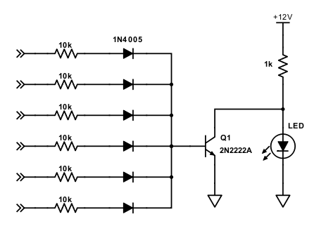

Thank you, that's what I hoped you'd say!
But I still don't understand 'how' the 'NOR' part functions. I understand that the transistor diverts the current when its base is high, but what I don't understand is why the base will be high in a situation where 5 of the tied inputs are at -63V and only one of the inputs is at +5.6V.
How does -63V + -63V + -63V + -63V + -63V + 5.6V = 'high'?
Can't that single +5.6V find a path to the other -63V pins, with the net effect that the 6 tied inputs all end up 'low'?
680500d1526260592-hypex-dlcp-ucd400-build-six-input-nor-gate-png
Ah, now that one I can understand! Thank you, most appreciated.

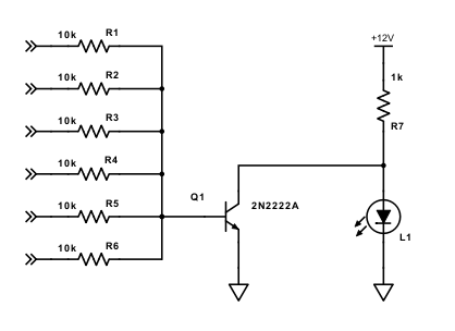

So I'll need to bring a separate LED driver supply onto the adapter boards, which I've labelled VDR in the attached diagram. I'll use a screw terminal block so that it's easy to daisy chain this supply to my 6 adapter boards.
I'd appreciate a quick check on this schematic before I get too deeply into laying out the components on the PCB. R1, R3 and R5 are the current limiting resistors for the LEDs, with values TBD, R2, R4 and R6 are basically copied from Rayma's schematic - I guess they are current limiting for the transistors?? R7 is a pull-up resistor for the clipping signal - the other signals are internally pulled up. One thing I'd appreciate a check on is the relationship between R6 and R7 - which side of R6 should R7 connect? Looking at it now I think I may have it the wrong side.
So R7, but not R6? What's the purpose of R2 and R4? Are they not current limiting for
the transistors, and if so, doesn't T3 also need R6 to do the same job?
The series resistors R2, R4, R6 between the input and the base convert the input voltage signals to current,
which drives the BE junction, which causes the transistor to turn on and conduct enough current to saturate,
causing the collector voltage to fall to a low value, around 0.2VDC.
Clarify again, is that input signal ground if "go", and high if "no go"?
The clipping signal is normally high (due to the pull-up resistor) and goes low when the signal is clipping (which is when I want the LED to light).
The Current Limiting signal is internally pulled up (to 5.6V I think), and goes low when the amplifier is current limiting (which is when I want the LED to light).
The 'Ready' signal is normally low, but goes high (internally pulled up to 5.6V) when the amplifier has shut down due to an error (i.e. NOT ready). I want the LED to light when the amplifier is ready, i.e. when the signal is low.
Thank you - so shouldn't R6 be there to do the same job for T3? And I assumed R7 is needed as well because the clipping signal is an open collector which needs to be pulled up.
Yes, all the transistors need the series resistor connected to the base.
Any open collector device needs a pull up resistor. Connect it before
the series base resistor (directly to the device), not after the resistor.
So a "low" input always means the LED should be on. Then the circuit logic is correct.
Now we need to be sure of the logic levels so the circuit will properly function.
What is "low" and what is "high", in volts?
Yes, that's right - in all three circuits, the LED needs to be on when the signal is low.
For the clipping signal, the open collector which I have to pull up, the notes say that the low state has a maximum of 1V. The pull up voltage must not exceed 65V (I'm planning to use 15.6V), and the maximum output current is 100mA.
For the current limiting signal, the low state apparently has a minimum value of -0.7V. It is internally pulled up to a value that I think is limited to 5.6V by a zener diode. I'll post the schematic in a moment.
For the Amplifier Ready signal, the low state apparently has a minimum value of -0.6V. It is internally pulled up to 5.6V (similar schematic to the current limiting signal).
