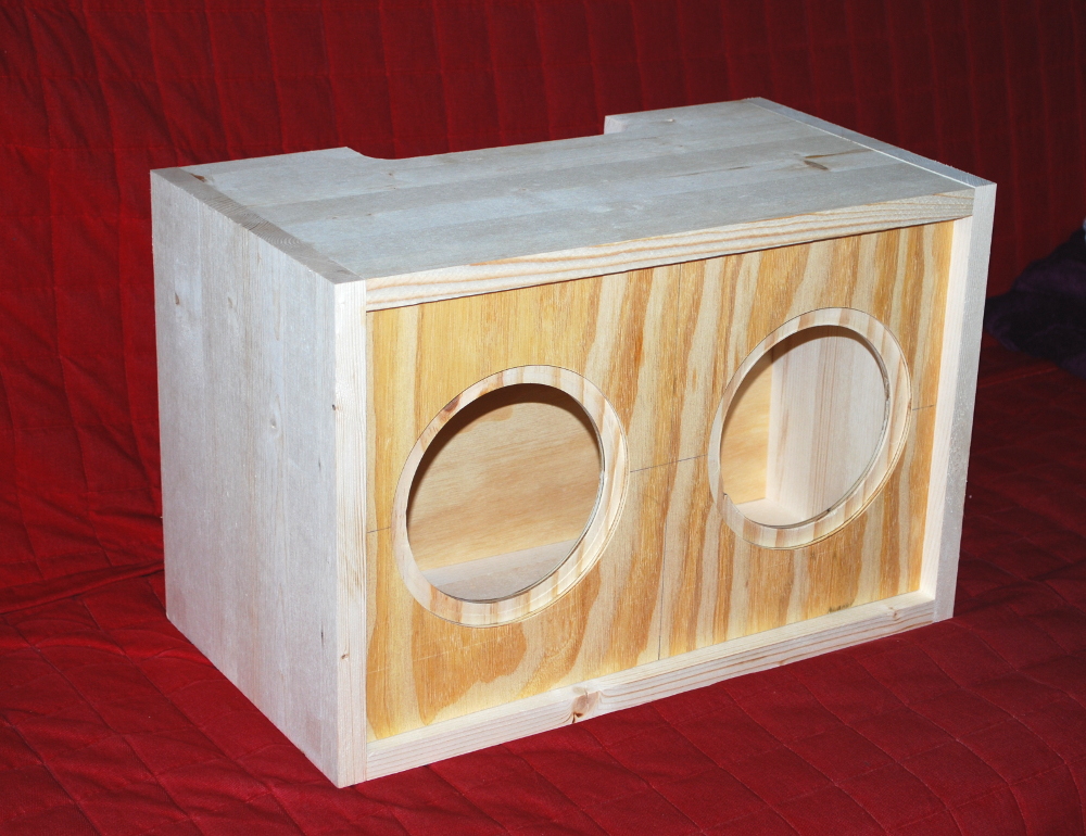

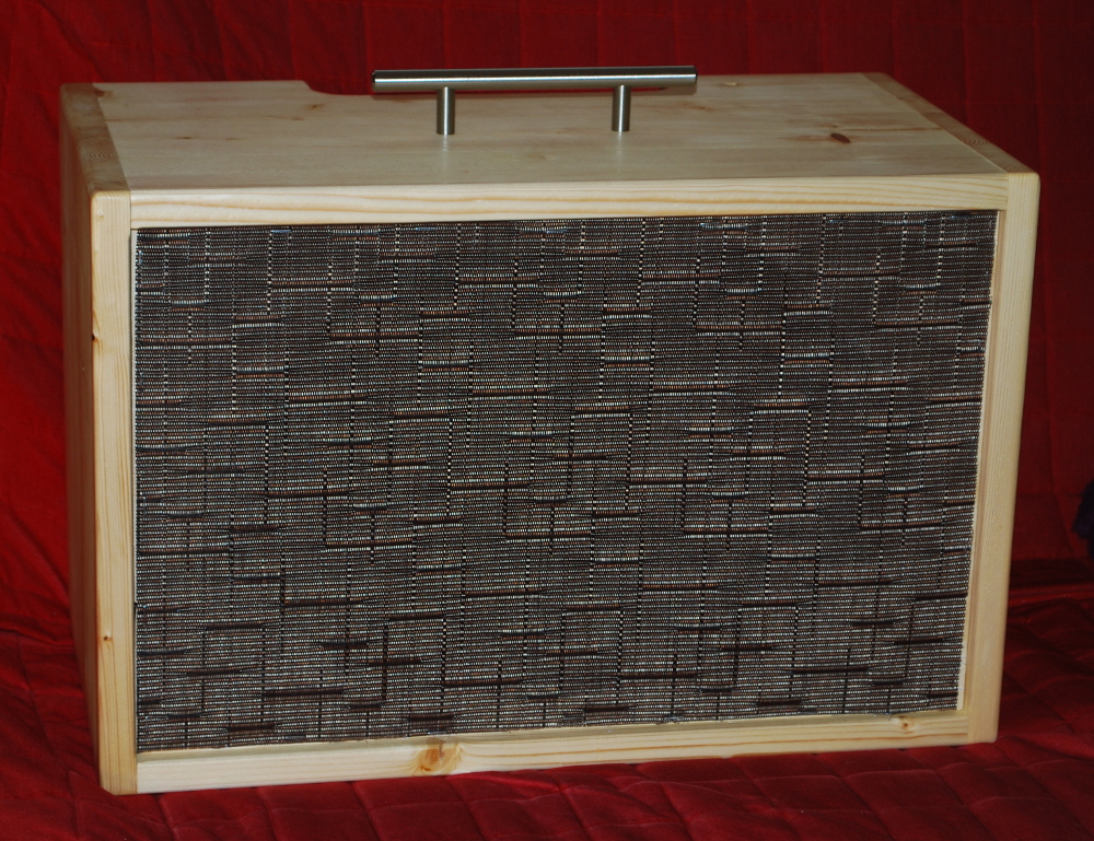

Here are some pics of the last box I made. I used butt joints with corner and edge reinforcements on the inside. The glued-in front and back panels added quite a lot of strength, too.
-Gnobuddy
