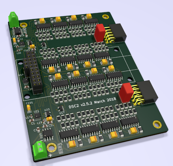

DSC 2.5.2 version for DIY community. Main features:
  • Amanero USB can be installed along the board or by the second floor (less space needed).

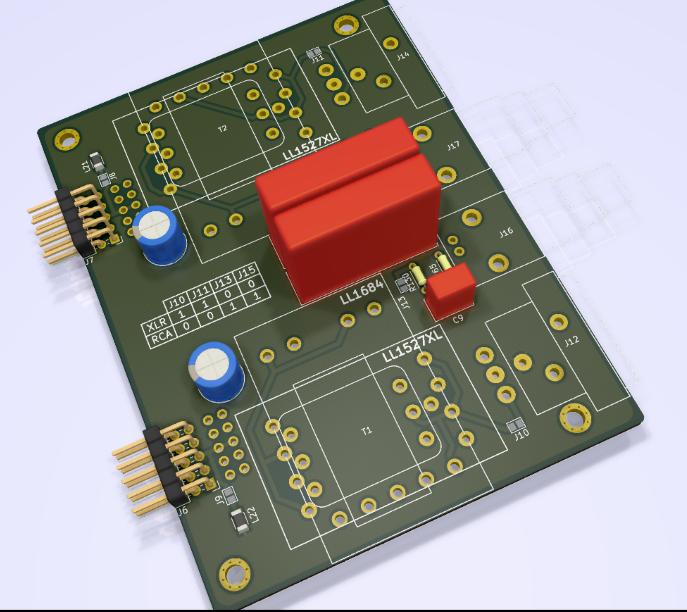

  • Attachable output module can be placed on the third floor or under the main board.
  • Chinese transformers, Lundahl LL 1527XL or Lundahl LL 1684 can be used at output module.
  • You can disable built-in LDO and power DAC from external power supply
  • Resistors and Inductance of any size 0603-1206 can be used.

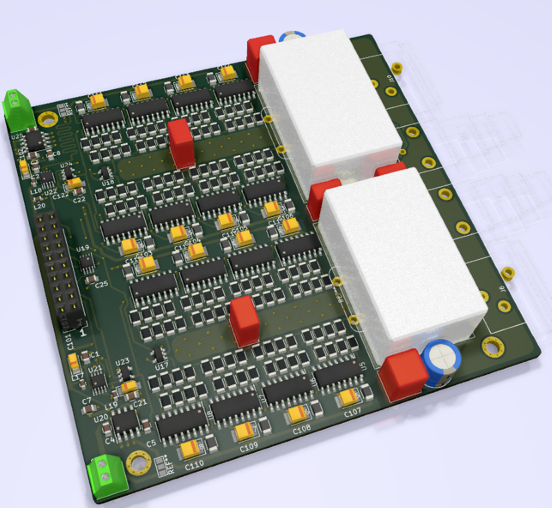

DSC 2.6.2 version. Main features:
  • Output stage on the same PCB with DAC. Schematics the same with 2.5.2.
  • You can disable built-in LDO and power DAC from external power supply.
  • Chinese transformers or Lundahl LL 1527XL can be used.

First DSC v2.5.2 photo
Additional DSC v2.5.2 photo for stacked configuration

For all who would like to order 2.6.2 - this version only support stock Chinese transformers and LL1527XL.
Of course you can install any transformers with the same spacing between pins and rows.
