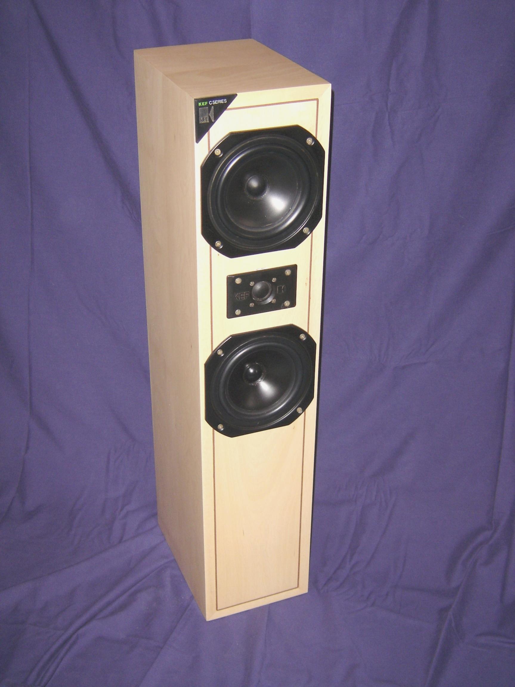

I have built most of my prototypes with solid wood side panels for more than 15 years. This includes several 6 feet tall line arrays, many MLTLs (several 4 feet tall), many small monitors, and others. I've built more than 20 prototypes speaker pairs over the years and none of my speakers have come apart.
For my builds I specify kiln dried lumber and generally use MDF for the other panels and bracing. Some of the larger speakers use pocket screw joinery but most feature wood glue joints.
https://us.v-cdn.net/5021930/uploads/attachments/5/0/9/5/9/6468.jpg
http://greatplainsaudiofest.com/Photos/CSSLineArray01.jpg
You can find photos of my MLTL designs on DIYaudio with a search.
The linked photos show line arrays which are 6 feet tall and more than 10 years old and still going strong. Both feature real 0.75 inch thick walnut side panels.
