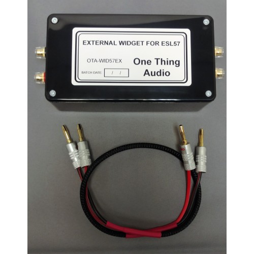

OT's 'widget' schematics for the ESL57
What I could make out from OTAs description is that the widget makes an easy load for the amplifier. Some amplifiers do not tolerate the low impedance of the ESL exhibiting at high frequency, and could become instable. How is this impedance correction achived, I have no idea. But I can live without it :)
I have no idea, where is it placed in the circuit, that might give a clue as to what's inside of it.
It puts between the amplifier and the transformer's input
My plan is to experiment with other amp than the Dynaco ST70

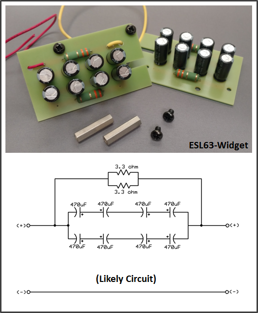

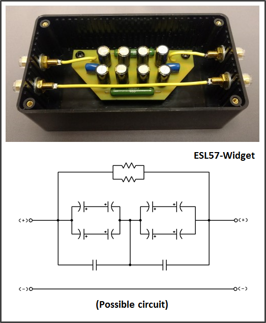

From pics and descriptions posted on their website: One Thing Audio
  • The ESL-63 widget appears to be intended as a replacement for the RC input components.
  • The ESL-57 widget is likely designed to be placed at the input as well, but component values and PCB traces are not definitively discernible in the pic.
    With carefully selected R & C values some equalization(mentioned in the description) of the slightly sloping response of the ESL-57 should be possible.

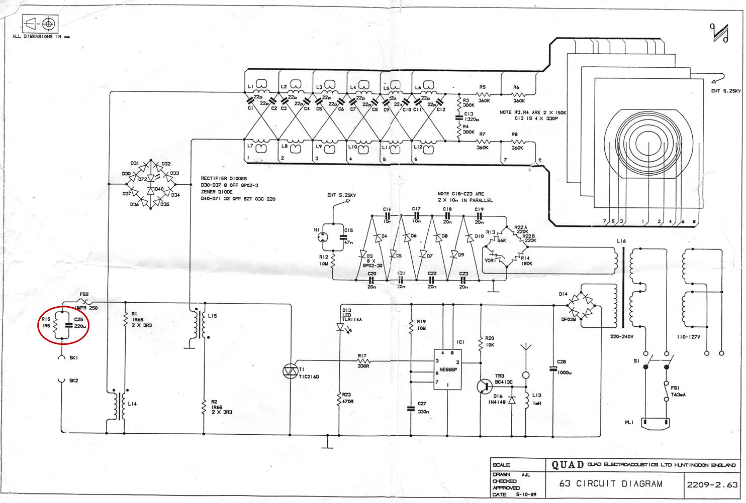

That input provides phase shift and a little response compensation. The impedance of the RC parallel pair is about 1.4 ohms at 20Hz and falls to essentially a short at 20KHz. That is is series with the transformer and panels and such, which also have a falling impedance (more or less). That's also a trick in cone and dome speaker crossovers.
In my humble opinion, that circuit has no place on the original ESL.
As an aside, adding about 10uF of film capacitor in parallel with that 220uF electrolytic really helps the sound of the 63's. for the 988's and later there is room under the hood to replace that electrolytic entirely with an enormous solen film cap. But the 63's are a bit cramped for that, and placement is nasty.

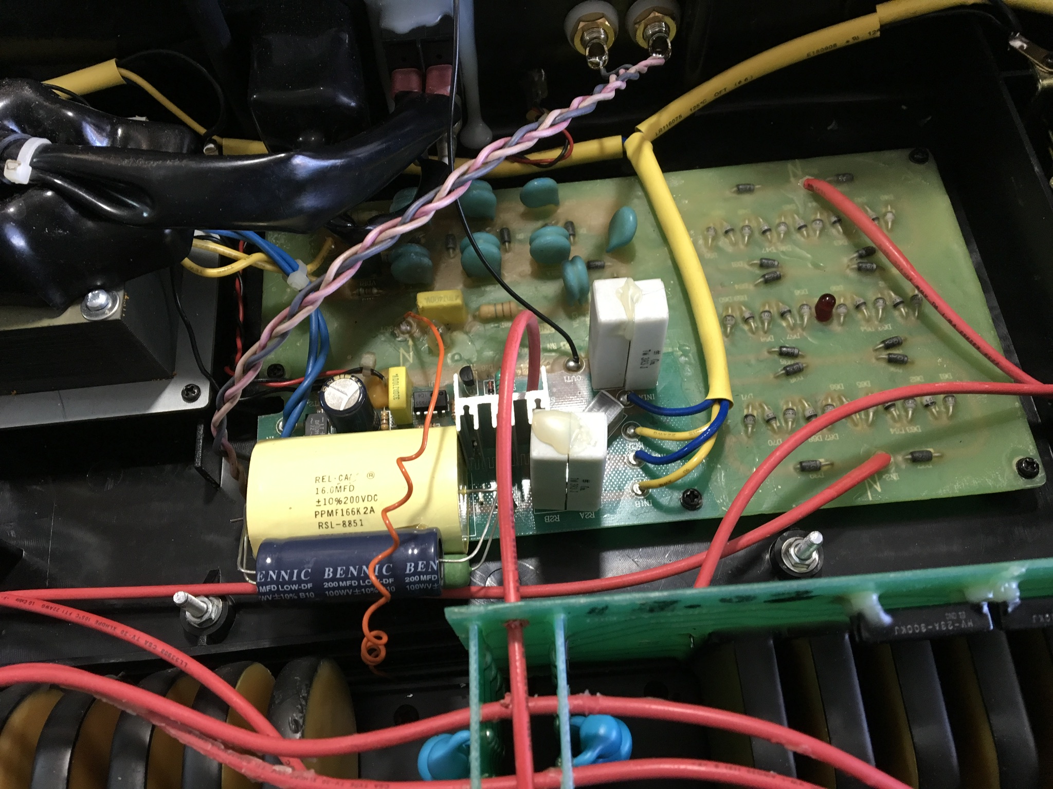

Dave, looking at your picture reminded me of another thing. The 1000uF cap that is the filter cap for the arcing clamp circuit is only rated at 16v. If you measure the DC of that supply it will be right at 16V with ripples over that. This causes those caps to fail over time. I replace them with 25V units. If the cap fails, the clamp circuit becomes hyper sensitive. It's a good thing to swap out next time you are in there.
Sheldon
quadesl.com
Yes, in that pic the 1000uf cap is a Panasonic FC 25 v replacement.
Those aluminum “ L “ mounting legs are mounted in rubber ends and isolate the panels from the really “ erector set “ cheap frame construction. One might want to approach coupling the panels too rigidly to it with respect as to not excite a resonance and make it vibrate.
The L mounting leg should be replaced with a thicker one easily sourced.
All the panels should be double sided taped together and clamped tightly and then screwed to the end piece.
I replaced all the perimeter foam with closed cell dense replacements and sandwiched the ends with long sticky versions and stuck and compressed the side frame when screwing the outside frame together ( visions of aluminum window frame construction , sshhsh)

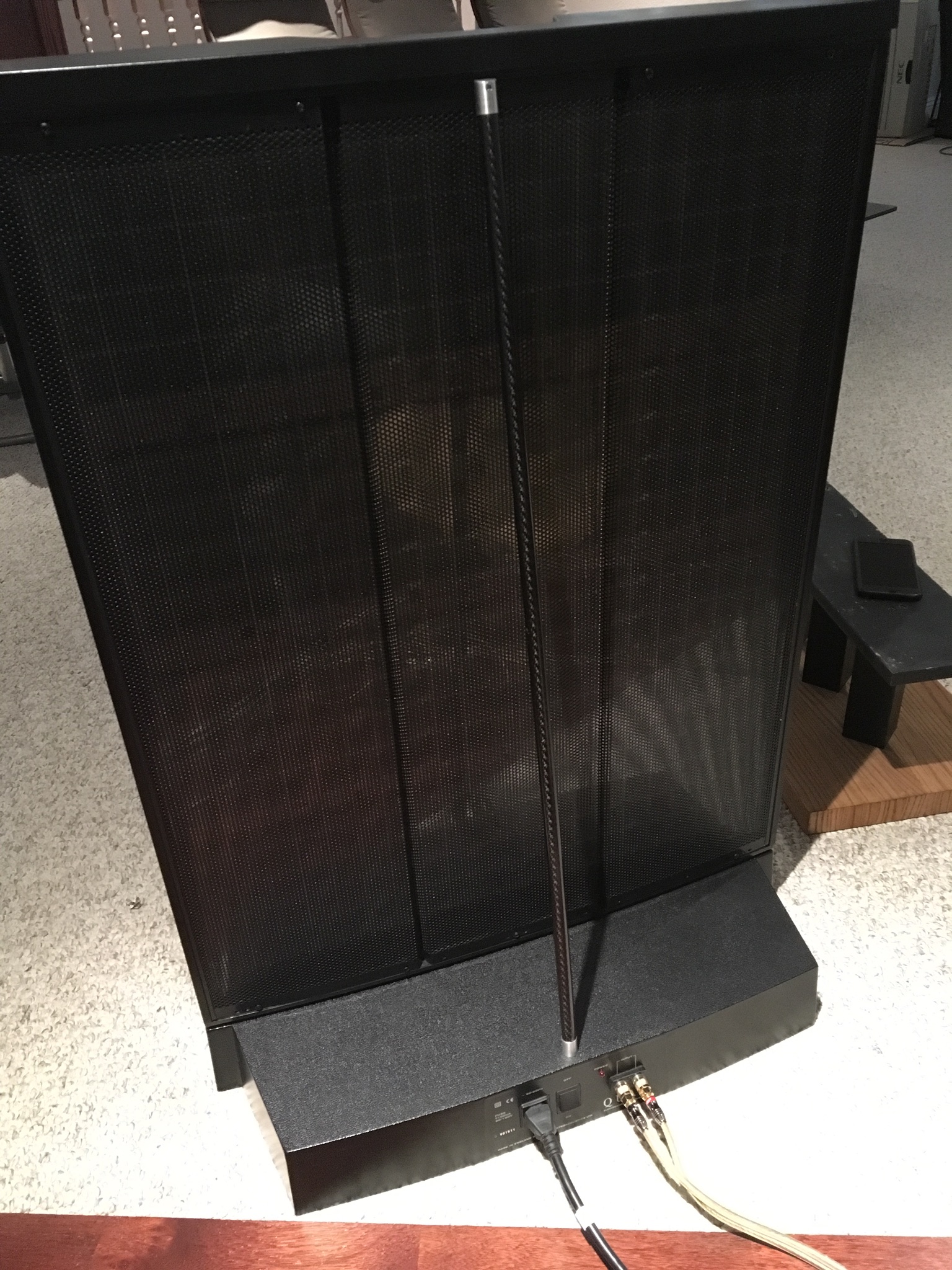

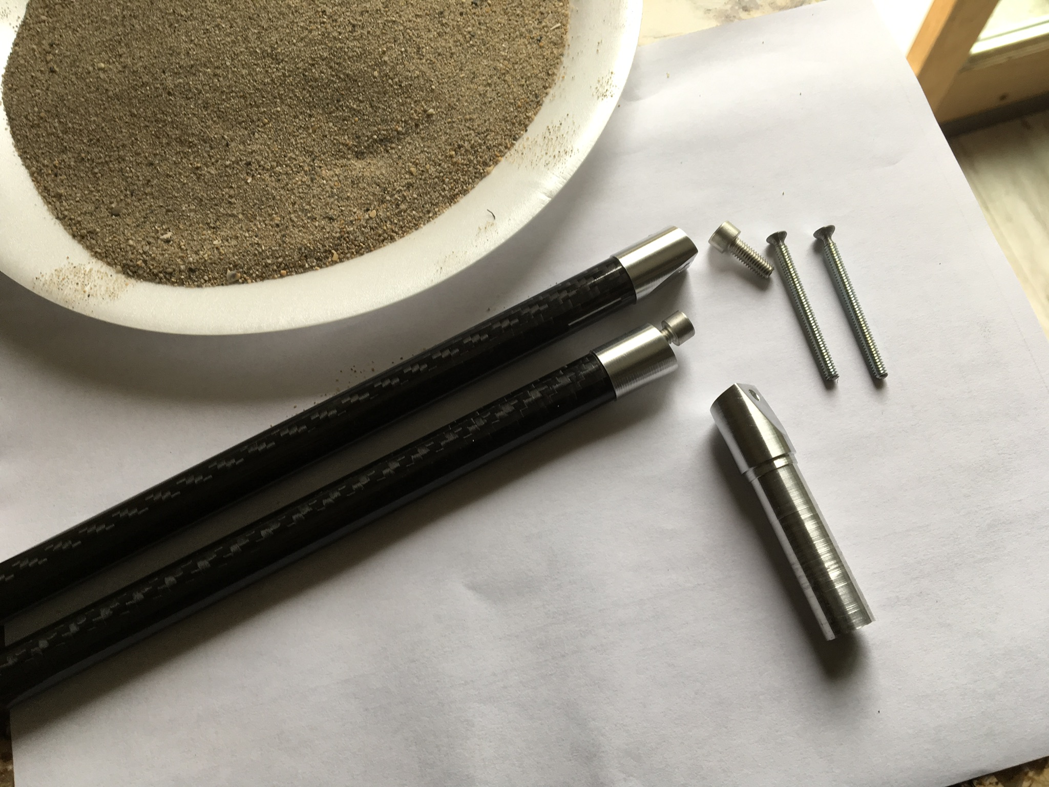

I did machine and add a carbon fiber sand filled pole like the 28/9 series use as the flexible nature of the plastic base interface is not rigid enough by itself.
Some pics included
