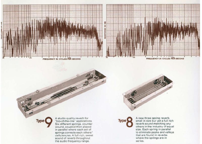

Well I got the resistors and caps replaced. I replaced the reverb driver and gain with a 6N23P. The 6N23P has a Ri of about 3K at 9.34ma. It all does work, except I'm getting a small bandwidth through the reverb. From 1khz to 2.3khz I'm getting about 4 times more signal out than at 600hz or 6000hz. In that band I'm getting more signal than through the non reverb channel. Why is that?
I got the reverb replaced with a MOD 8FB2C1B. Going by the Ampeg schematic I used a 0.47uf after the 6N23P driver, and am wondering if it's too small. I've been testing it to day and I found a 0.22uf cap on the input or output of the reverb does wonders, it increases 600hz while lowering 1Khz. But it also lowers 2.3Khz a lot. I've tried putting a pot in series with the 0.22uf cap and adjusting it, it helps, but very little. I've also tried a 6N1P, 6CG7, 6DT8, and 6BZ8, but it doesn't change the bandwidth.
I've tried 3 different circuits (Gemini II with a 6GC7, 6N1P, 6DT8, 6N23P, and 6BQ8, a pentode driver using a 6GH8A, from a online schematic, and just a cathode follower using a 6U8) all of them gave me the same variations. I even tried a Zune HD music player, and got the same results, a dip at 600 Hz and a peak at 1KHz. So I did a test and put in a series of audio test tones at a fixed input and recorded the output of the MOD reverb tank.
With 5 volts in:
60Hz - 50mv out
200Hz - 30mv out
600Hz - 12mv out
1KHz - 60mv out
1.5KHz - 30mv out
2KHz - 20mv out
5KHz - 5mv out
All into a 100Kohm resistive load. This is not what I was expecting from a good reverb tank.

...put in a series of audio test tones at a fixed input and recorded the output of the MOD reverb tank.....
Reverb tanks are generally driven with a high impedance, semi constant current. Use a series resistor 10X the tank's nominal input impedance. That will slant the whole spectrum for better highs.
However the 600/1K dip/peak sure sounds like a poorly damped mechanical resonance. The "good" springs often have bits of foam, perhaps to damp such rings. I'd never thought the MOD series was supposed to be fine wine; more a lower price spread.
I did put in a 10K pot in series with the output a couple of weeks ago. Played around with it, but it didn't seem to do anything. Since I tested the reverb with the pot at 0ohms, I turned it up to 10K and retested and used a audio oscillator that put out 20 volts to compensate.
Series resistance 0Ohms 10K
50Hz 3mv 2mv
200Hz 15mv 2.5mv
600Hz 17mv 2mv
1KHz 100mv 17mv
2KHz 10mv 3mv
5KHz 6mv 5mv
I did verify that the oscillator was putting out 20 volts on each frequency.
OK, so what happened was, I found a Accutronics datasheet that shows the 8 series and it's frequency response. As you can see it's all over the place, and indeed my peek at 1KHz fell flat at 980Hz, a good 10-15 db lower. It's not a concern with a guitar since it doesn't produce a single frequency in a sine wave. If I had a guitar, I would have been done a month ago.:(
