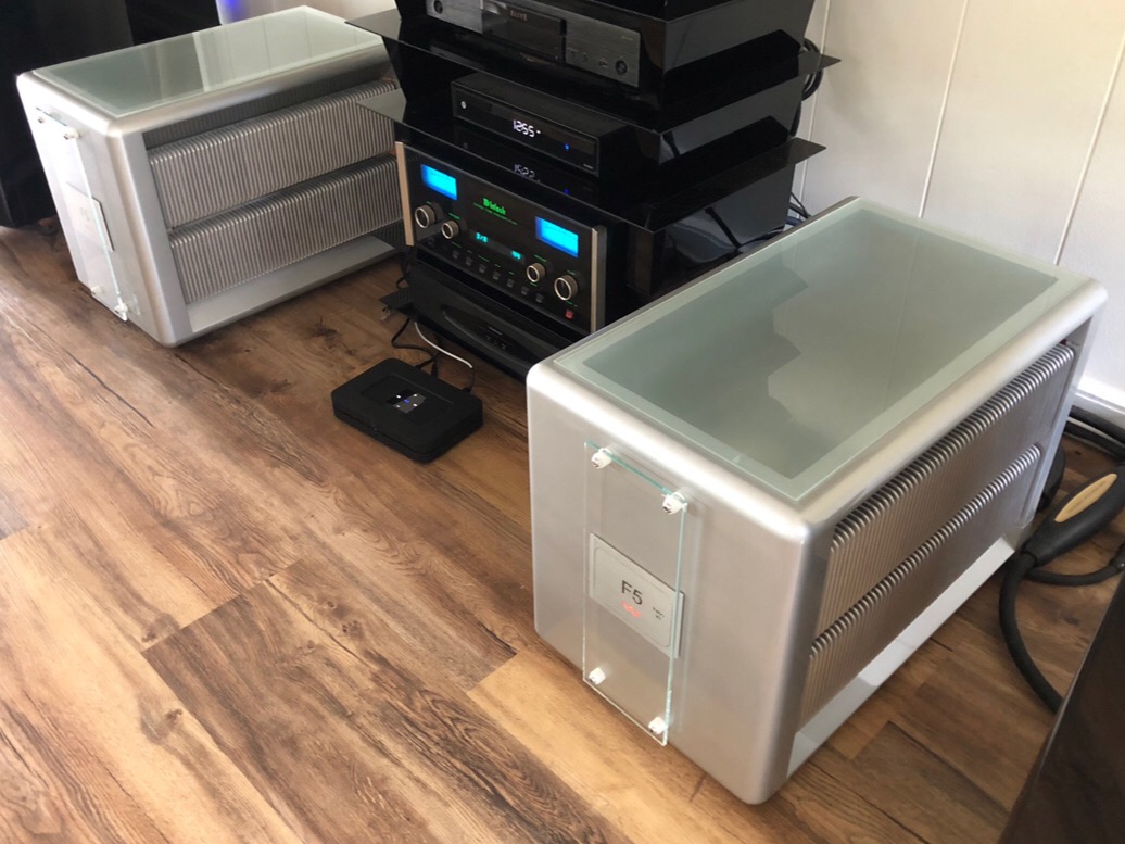

I finished these original monoblocks a couple years ago. Happy with the sound and performance, but between the size of the amps, and the rest of my accumulated gear, our living room looks like a dorm room.
So after many hours searching images of shelving, cabinetry, and console’s I decided to build a console. It will be similar to the pic but a little longer and made from teak.
These amps will be rebuilt in new 24” x 16” x 8” (HxWxD) electrical enclosure’s. With new Pass Labs style heatsinks mounted to the 24” x 16” back. The console will be built to receive one on each side from the rear behind the speaker box sections. With the heatsinks exposed on the rear. I think with a couple inches of spacing away from the wall should be good dissipation.

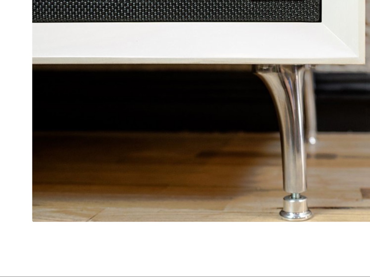

Chede, thanks for commenting. I have received the legs I’m going to use;
The floor of the console will be made of 24 pieces of 3/4” plywood cut 2” wide laminated to 12 pieces of 2” wide 1/4” steel plate (3/4” ply, 1/4” steel, 3/4” ply, repeat). This 2” thickness will be buried and won’t show from the front or back. The various sections of the console will be built together to help support itself.
If this doesn’t work then I’ll be stuck adding a center leg.
Capacity of the legs is 150 lbs each. Might be close to capacity when finished and loaded with audio gear.

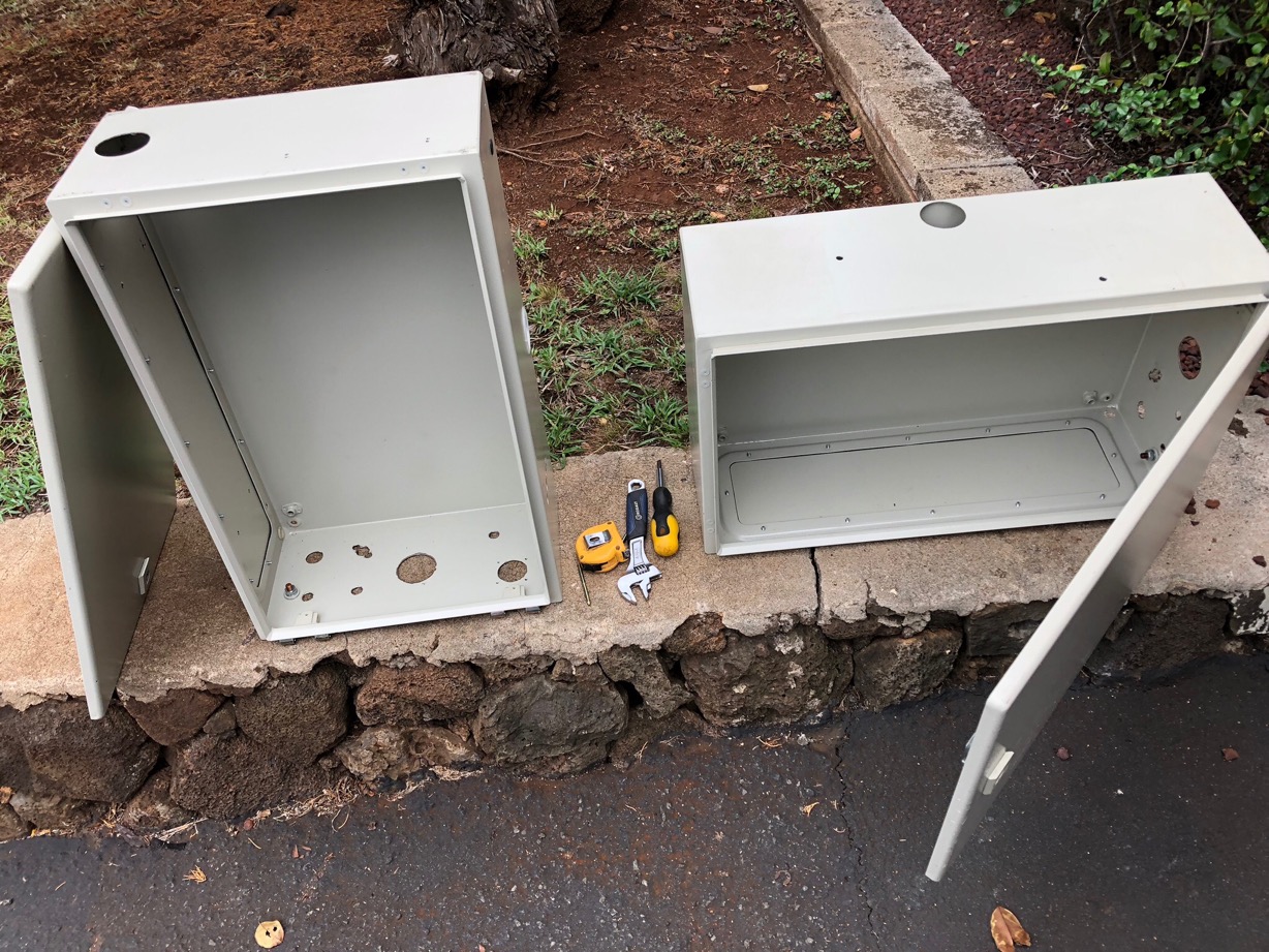

I purchased these used electrical enclosures made by Rittle (WM241608NC). Like the part number they are 24” tall x 16” wide x 8” deep, and made from 16 guage steel. $100 ea including delivery to the house. Will be plugging the old holes, repainting, and changing the hinges to the long side.
The plan is to bolt the heatsinks to the door. Route the wires to the hinge side so from the rear of the console I can swing the door/heatsink bank open for access to the amp.
I have 3/8” x 2” aluminum bars that the devices will be attached to and then bolted to the heatsinks to hold them together/spread heat. 4 ea bars per amp. So the case doors will be cut open at these locations and insulated spacers between the door and the heatsinks to reduce heat transfer to the enclosure.
Looks like a big space, but preliminary layout shows to be tight.
Enclosures even have a built in copper ground lug, bonus!

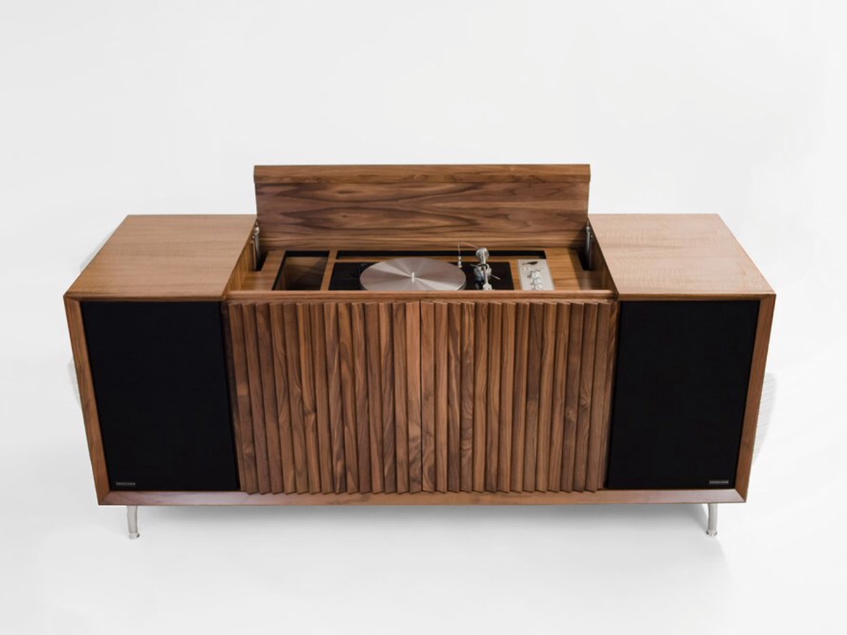

The current F5 builds, as in the pic, are 100% my design and fabrication, thanks for the compliment.
I have just started on the console. The pic above is just a reference to what I’m building.

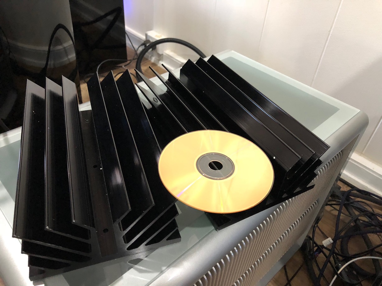

Heat sinks arrived from Singapore.
They are basically 10” long, 6” wide and 3” deep. There will be 5 on each monoblock. I will split one for each channel and have 2 1/2 on the bottom, then a 4” space, then 2 1/2 on top. This will fill up the 24” tall x 16” enclosure door.
5 heat sinks weigh 27 lbs.

The quality and finish of those appear to be nice. Did you find those on eBay or somewhere else on the web?
I have also had a couple private requests for info on these heatsinks.
I purchased them on eBay, item #263262235520. The same seller has them in natural aluminum also, for a little less money.
Ebay shows the sale from China, but they were shipped to me via DHL leaving out of Singapore.
The weight, finish, and overall feel is perfect. The seller answers questions almost immediately, shipped like the next day and arrived a week earlier than quoted.
Sound like an advertisement? I guess I’m jaded from other bad experiences on eBay and overjoyed I actually received something better and quicker than I had hoped for.
Of course the job of the heatsink is not to look good but to transfer heat. So that review can’t happen until after I’m done. But I think WalterW here on diyaudio also used them on his Sony chip amp. That’s where I got the idea from. And WalterW didn’t report any heat transfer issues.
Joined 2012
Of course the job of the heatsink is not to look good but to transfer heat. So that review can’t happen until after I’m done. But I think WalterW here on diyaudio also used them on his Sony chip amp ( chip amp??? ..... aaaarghhhh:eek::eek::eek: ) That’s where I got the idea from. And WalterW didn’t report any heat transfer issues.
yes there are serious issues, see this post: VFET-X (or my 1/3 40th Anniversary Sony VFET Clone)
You have to sand them a lot, then they are good to go.:D
Thanks WalterW for speaking up. I kind of assumed that smoothing heatsinks before bolting devices was a standard practice.
The backs of mine are pretty flat, but I will be blocking them and removing the coating on the backside.

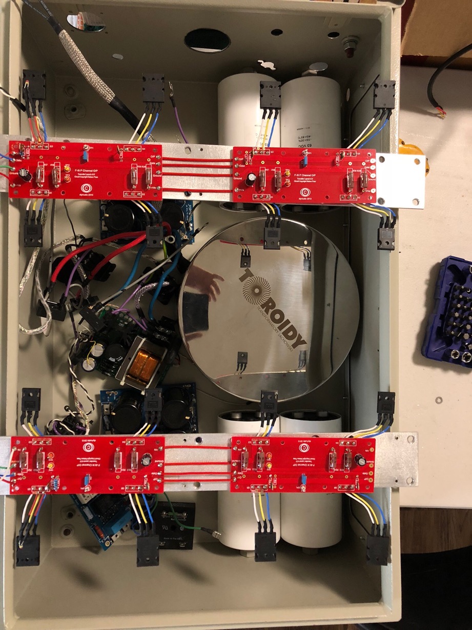

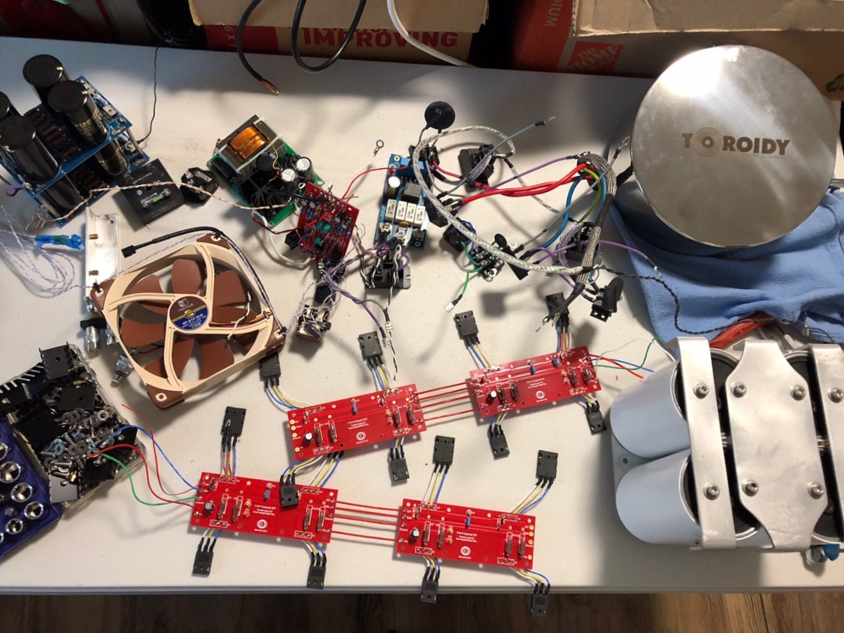

Stripped my first monoblock tonight. Came apart pretty fast. Man do I have a lot of drilling and tapping to do. Totally forgot how much work went into this first pair.
I’ll get one up and running first, and use the first one as reference. Been a good couple years so I can’t remember everything.

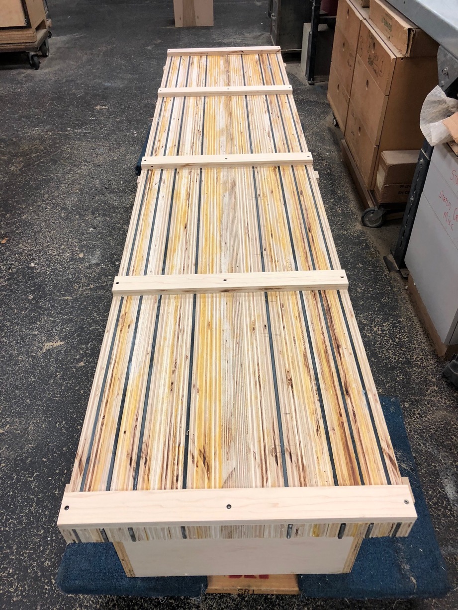

Today I put together the base of the cabinet. It is 2” thick, 92” long and 21 5/8” wide. To aid in building, assembly, and finishing I built a 10” high platform and sitting on a moving dolly on each end.
The base is built out of 24 rips of 3/4” shop grade maple plywood, 2 rips of 1” baltic birch plywood, 8 strips of 1/4” steel plate, 2 tubes of Sika adhesive, and about a 1/2 gallon of wood glue. Layered up and clamped.
The steel plate weight 12 lbs each, so 96 lbs.
After a few days I’ll do a load test. Hope is that it will hold 200 lbs in the middle without deflecting any.

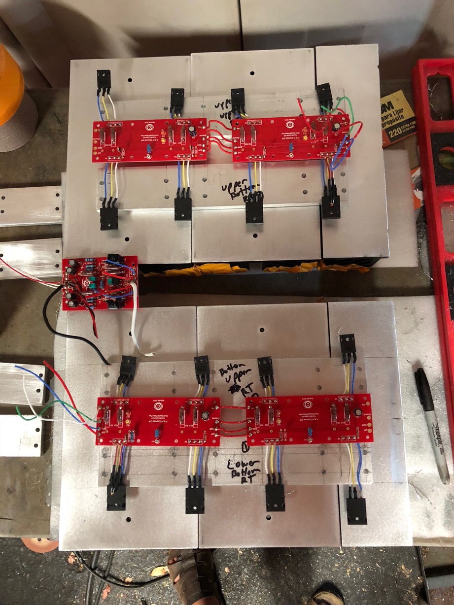

This is roughly the plan. The chassis will be in the back of the console behind the speaker. The enclosure will stand upright, 24” tall and 15” wide. The hinges will get moved to the side.
Connections and a cooling fan will be in the side facing the center of the console. Power at the bottom, input/output in the center, fan at the top.
Heatsinks and the boards on the door, including the FE board.
Layout will be optimized to good flow and short runs of wire.

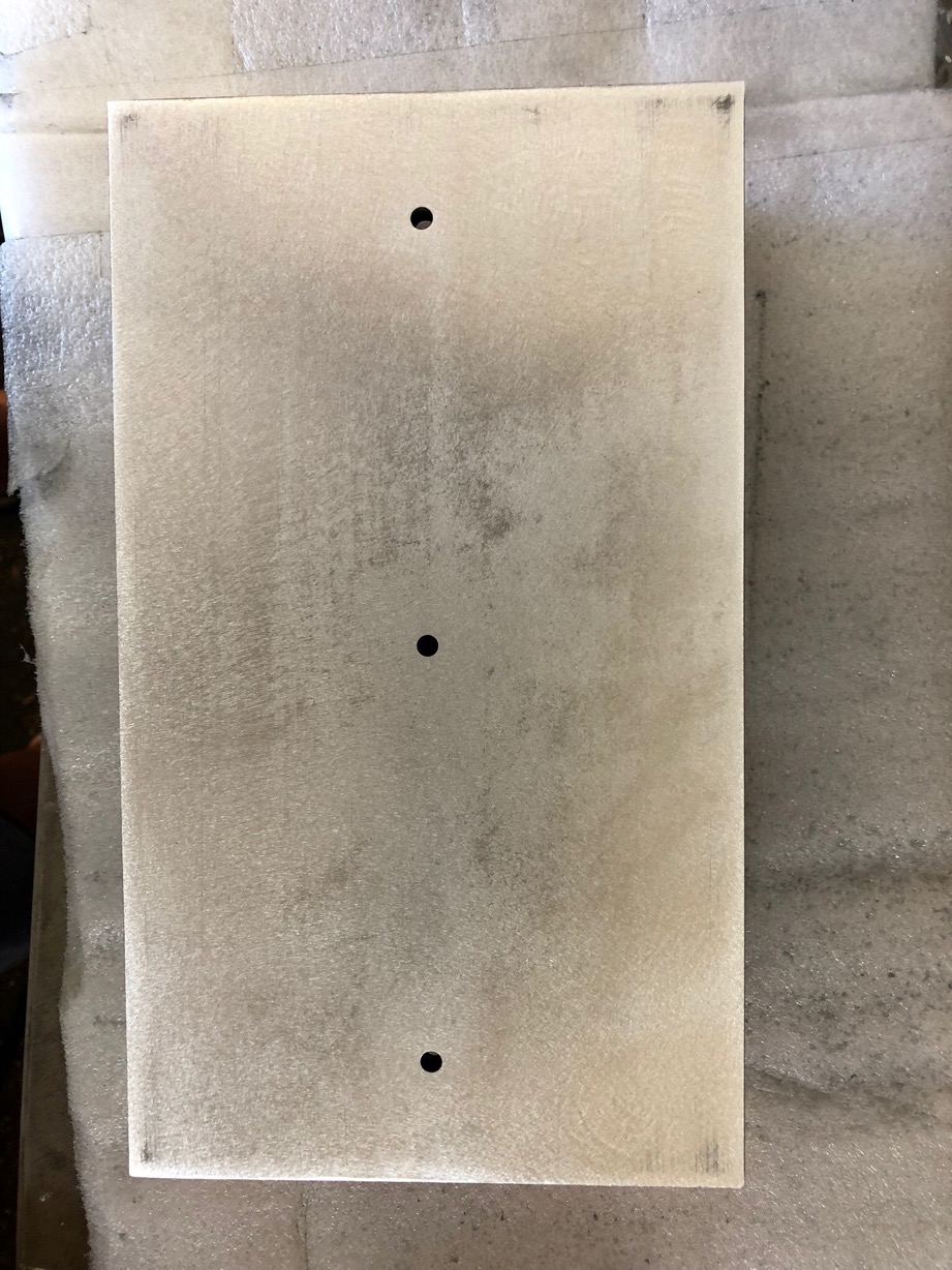

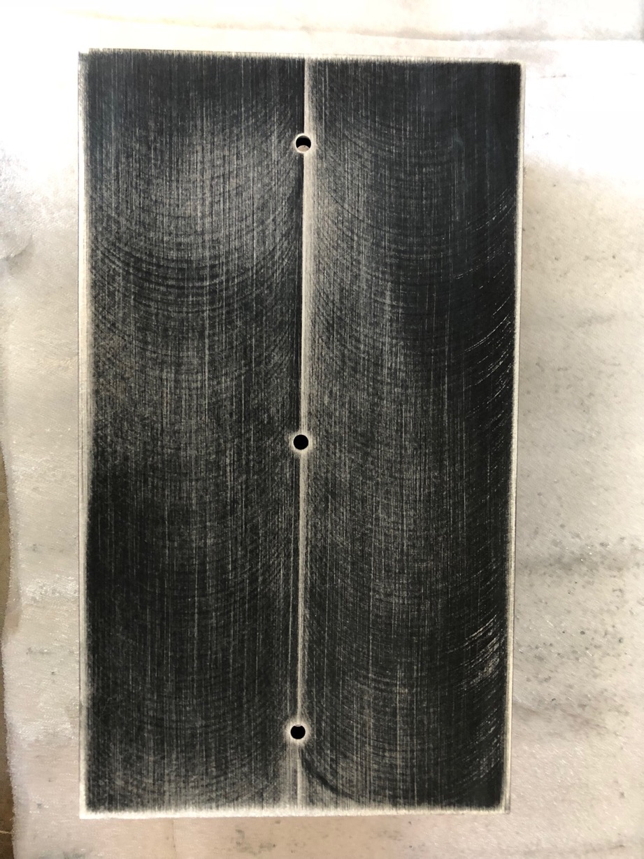

Spent today working on the heatsinks.
The coating is pretty hard. Here is a pic after a few passes with a standard palm sander with 80 grit paper. The circular marks and the line down the middle are not very deep and were there before the coating was applied.
Similar condition on all 10 I purchased. So I hit each one with my angle grinder with a 120 grit flapper type sanding disk to knock off the coating. You need to have some experience with sanding like this or you could end up with a mess. I took it down to where there were almost no defects, then used the palm sander with 80 grit. (FYI, I used a respirator as I don’t know what the coating is). It took me about 3 hours to clean up the 10 heatsinks, including cutting 2 in half.
Then cut up the 3/8” x 2” aluminum bar stock I’m using to hold the heatsinks together, to transfer the heat load between the pieces and hold the boards and devices. I’ll be removing the extension wires I added in the last build and solder the devices to the board directly, like your supposed to. I drilled all the bar to heatsink mounting holes (80) and called it a day.
Here is a pic that kind of shows the physical layout. And yes, I’m going to be mounting the FE board to the chassis door in the 2 1/2” gap between the top and bottom heatsinks. The board will face outside the enclosure and be exposed. Since this will be the back of the console and not exposed to the public it won’t be a safety issue and I will be able to tweak without having to open the door.
