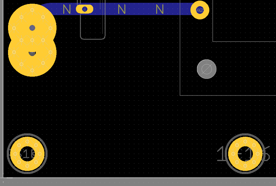

Here is a closeup of the part footprints that I am using
attachment.php
