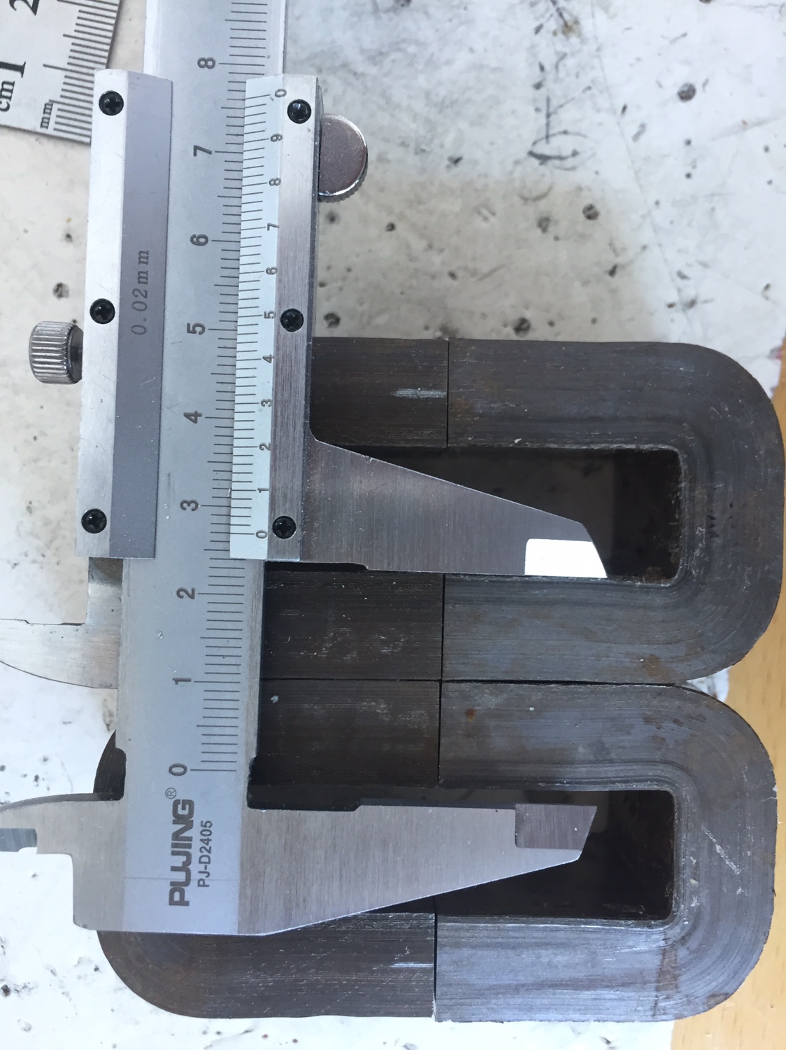

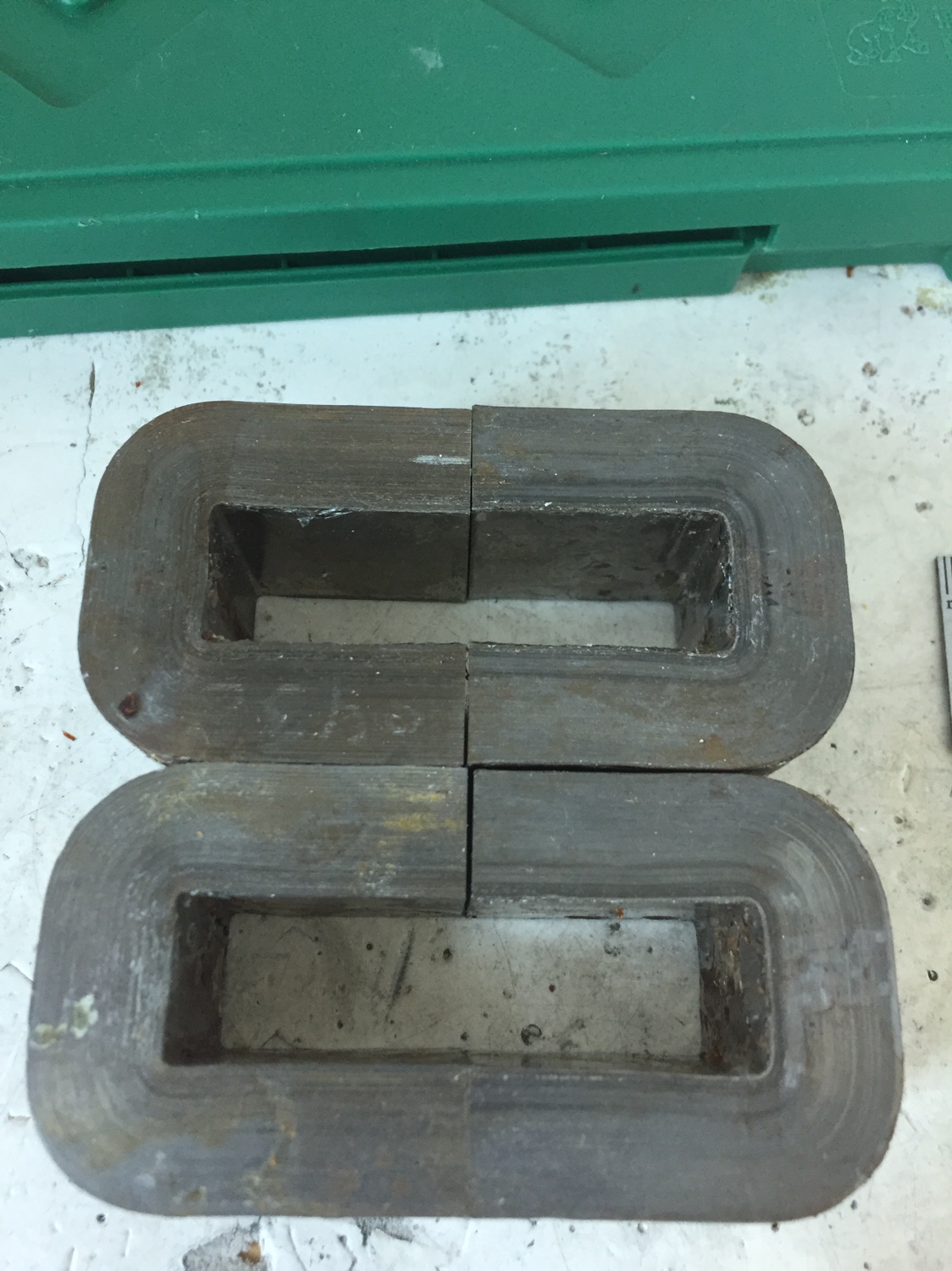

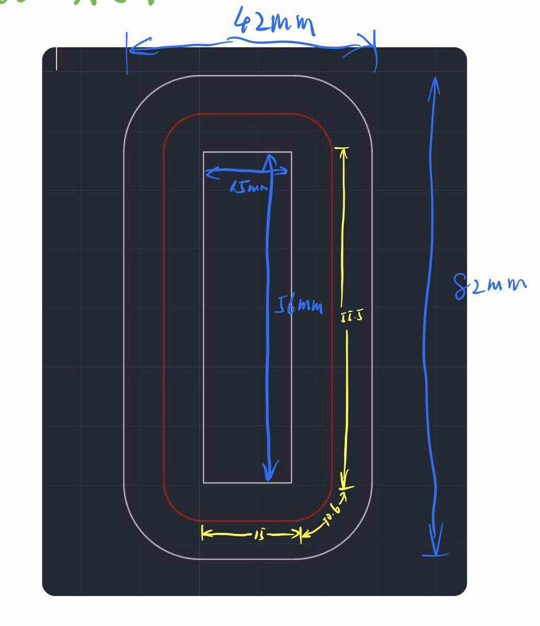

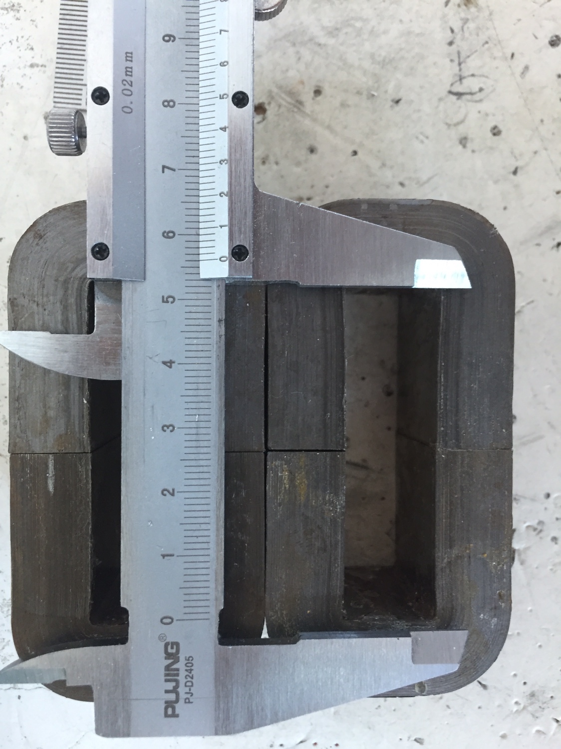

Cross-sectional area of Tran: 13mm*2mm*38mm=9.88cm^2
Cross-sectional area of mine: 13.5mm*2nm*30mm=8.1cm^2
The window of Tran027:42mm*12mm
The window of mine:56mm*15mm
The Cross-sectional area of my core is less than Tran027, but window size is bigger

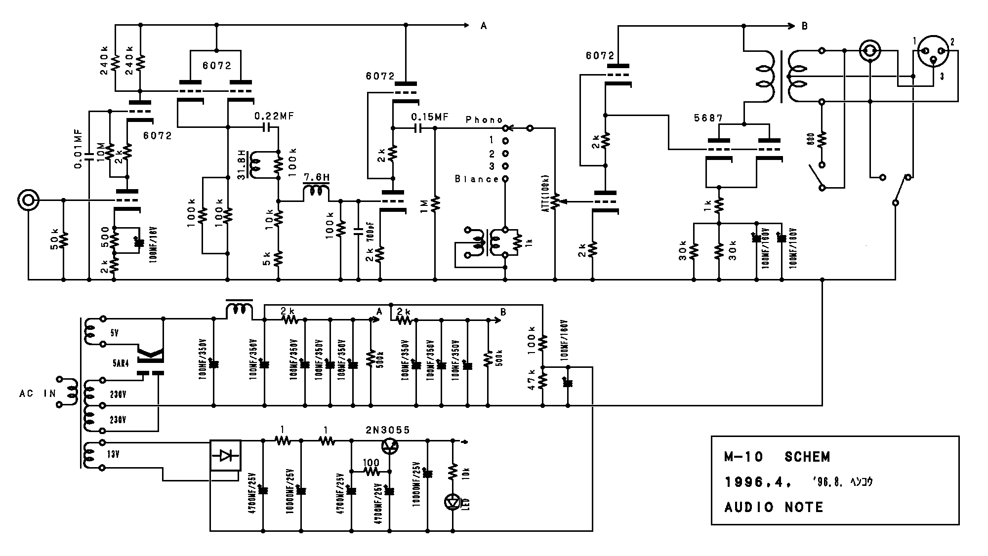

Thanks for post this email for me, I have read it before, peter is mainly talking about Tran028(the new version) for M10, but can't find the schematic of new M10
Peter Qvortrup clearly stated "The 027 was approximately 33:1 with a CT." and the reason why they switched to the 028 - to get higher impedance, but otherwise I would guess the schematic stayed pretty much the same.
