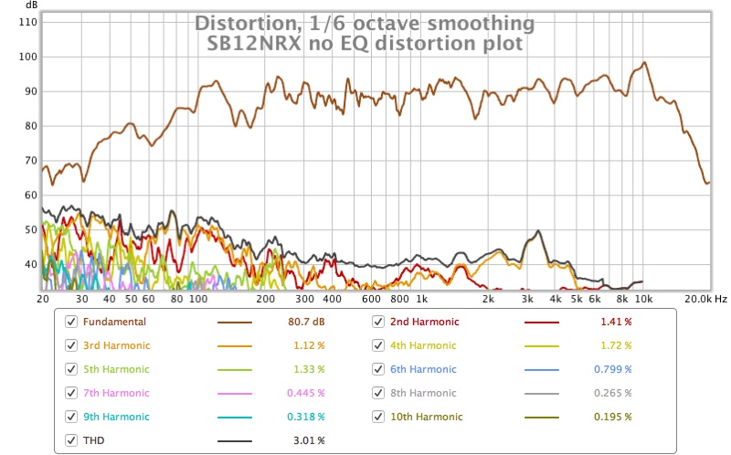

My Ariels are crossed over at 3.8KHz and that works well because the P13WH midbass drivers are smooth and have low distortion to that point. I've been playing with some SB12NRX drivers and while they're nice and smooth to 10KHz, they have a significant cone breakup spike that's seen as an increase in third harmonic distortion at 3KHz.
My plan with these speakers is to cross over below this point - probably at 2KHz if I can get away with it. See the attached plot showing the distortion peak at 3KHz.
I guess that means it depends. There's nothing arbitrary. Choose the point that gives the best performance for the specific set of drivers and their relative positions on the baffle.
