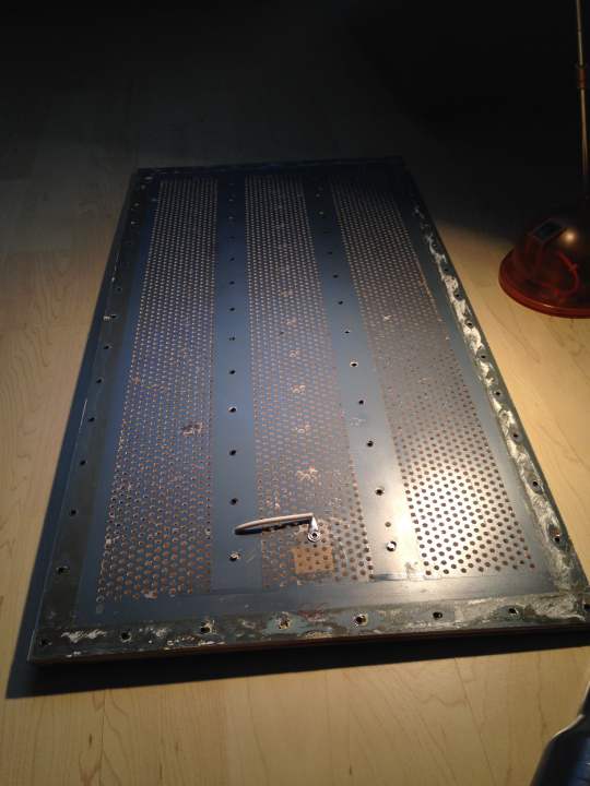

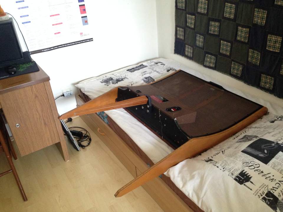

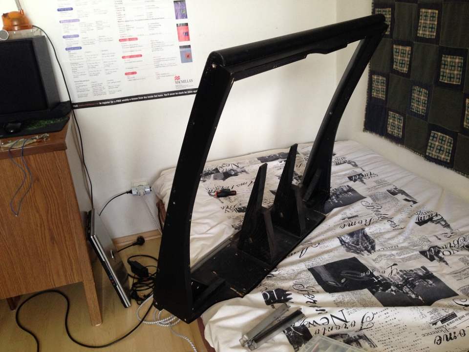

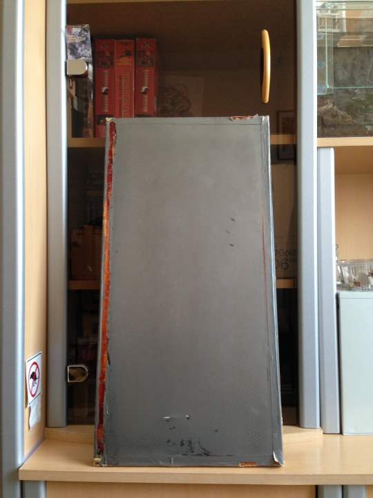

First thing I noticed that the woodwork of this side is crudely made compared to the other one I've just finished. Maybe, they didn't care more at QUAD longer about cosmetics. The treble supports and other panel support lines are zig-zag at the sides, and the quality of the plywood seems worse.
Other thing I noticed that apart from the treble panel that had been serviced by One Thing (not serviced but they changed the dustcover on it) the bass panels seem they were never touched. After a good soapy clean, the saran looked like new. Not new... It looked better than my repaired panels, as they have no wrinkles at all, and maybe a little better to the touch (more supple?).
The bad thing is that the insulation paint (or maybe the conductive paint underneath it too) started to flake off at the right bass panel's center section, so I started to worry a bit how to deal with this problem. However, it was there already, and the bass worked with no problem.
So, there is the task, I will photo-document, as I proceed. (if you don't mind o.c.)

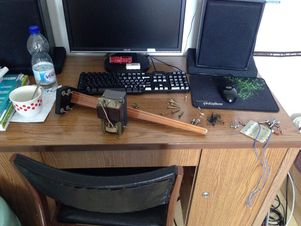

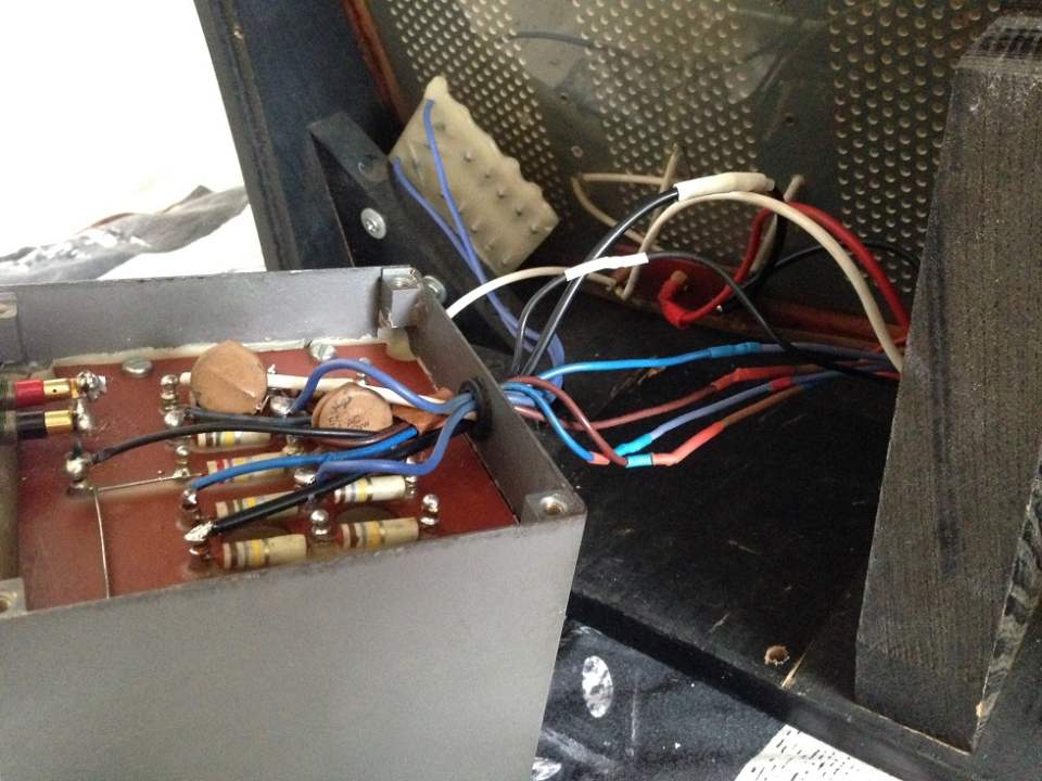

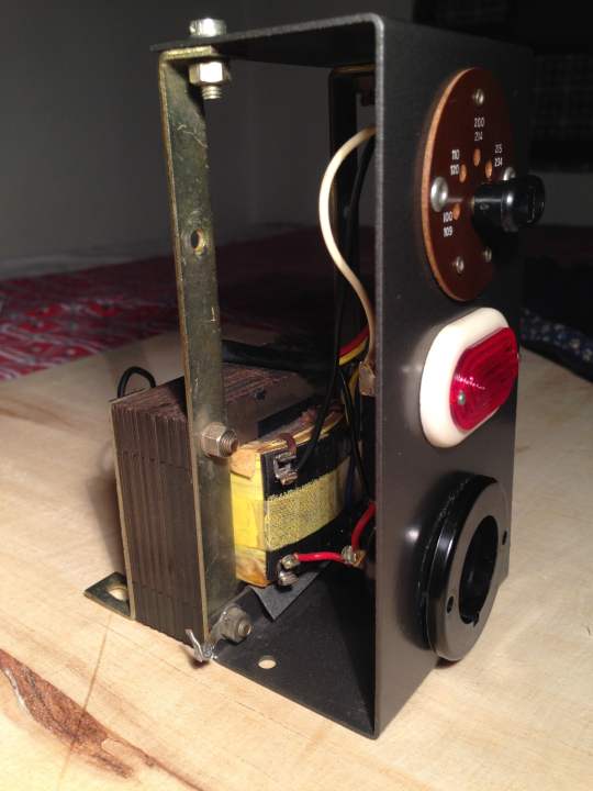

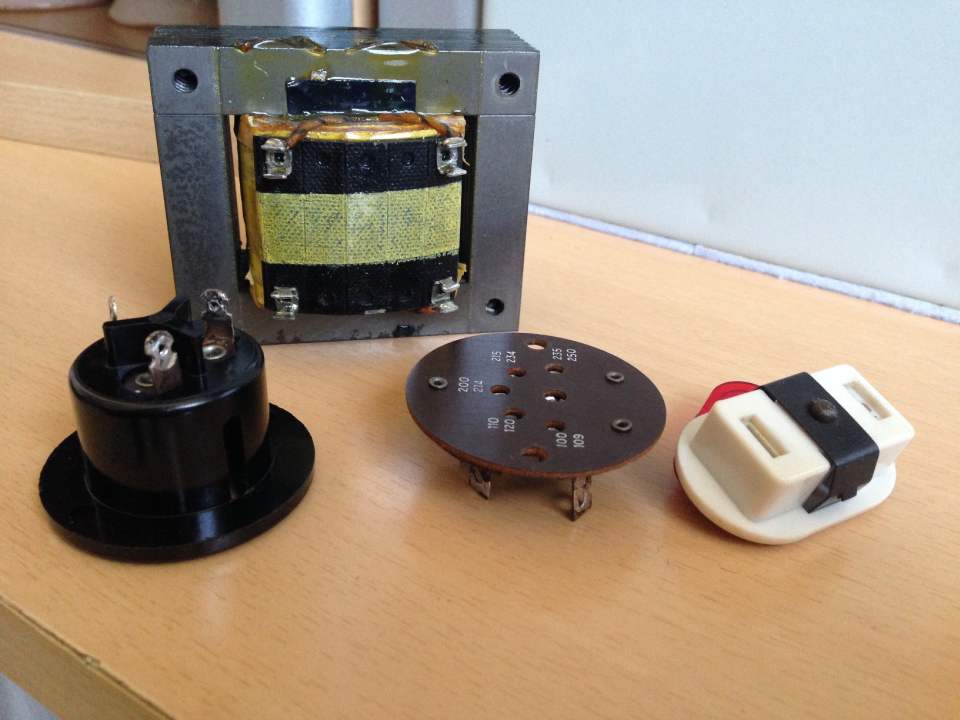

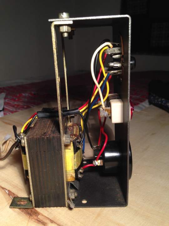

I disassembled the audio transformer (I ironed out the wax, heating the sides of the audio transformer box.) and checked the specs of the resistor-matrix. I think I won't brother it at all as the other one has near the same specs.

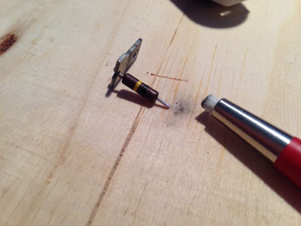

Next thing I've done is to check the EHT voltage with the multiplier. It showed a greater value for the treble and bass both. It is maybe due that the power comes from the 610V tag to the multiplier box than from the 590. (photo later)

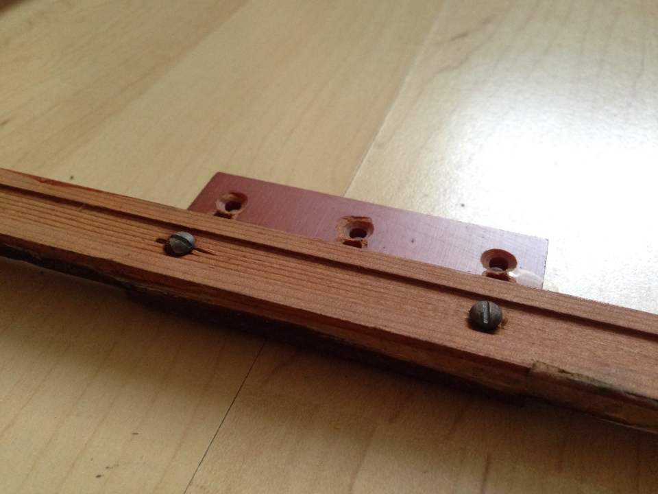

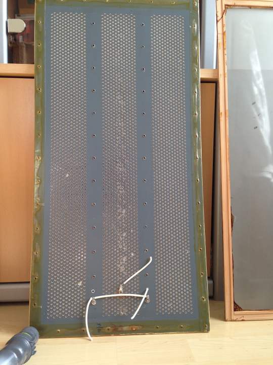

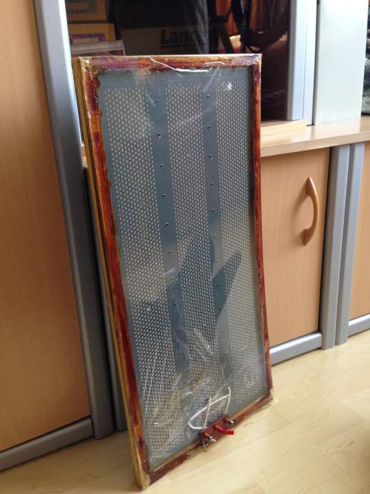

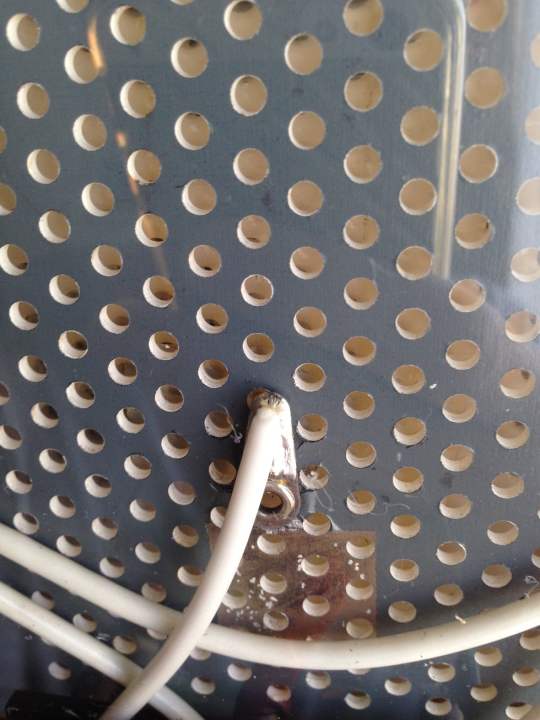

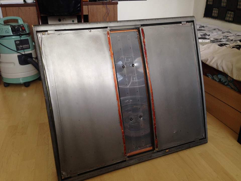

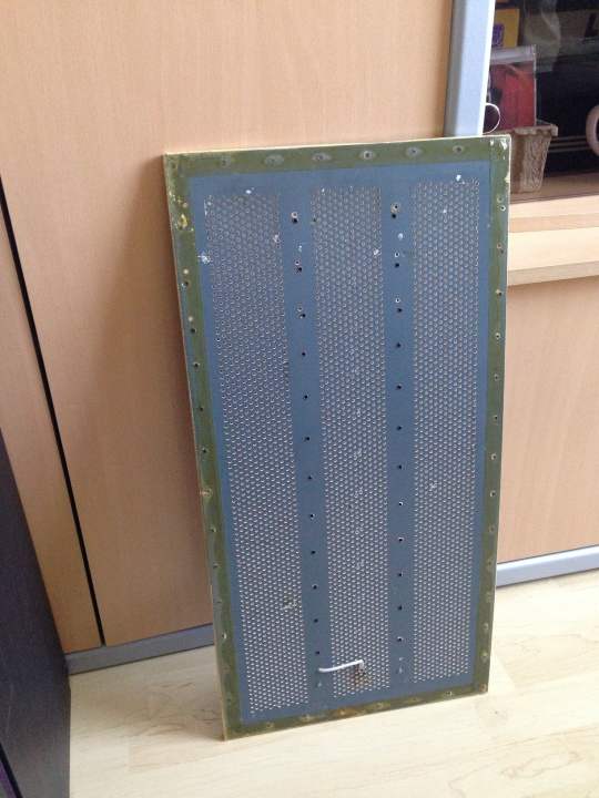

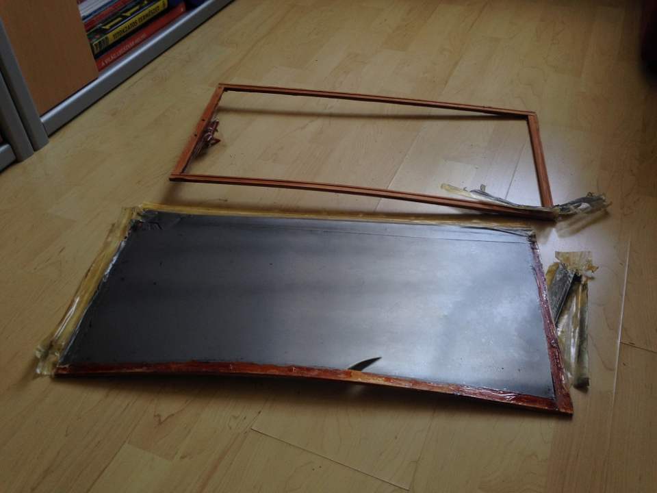

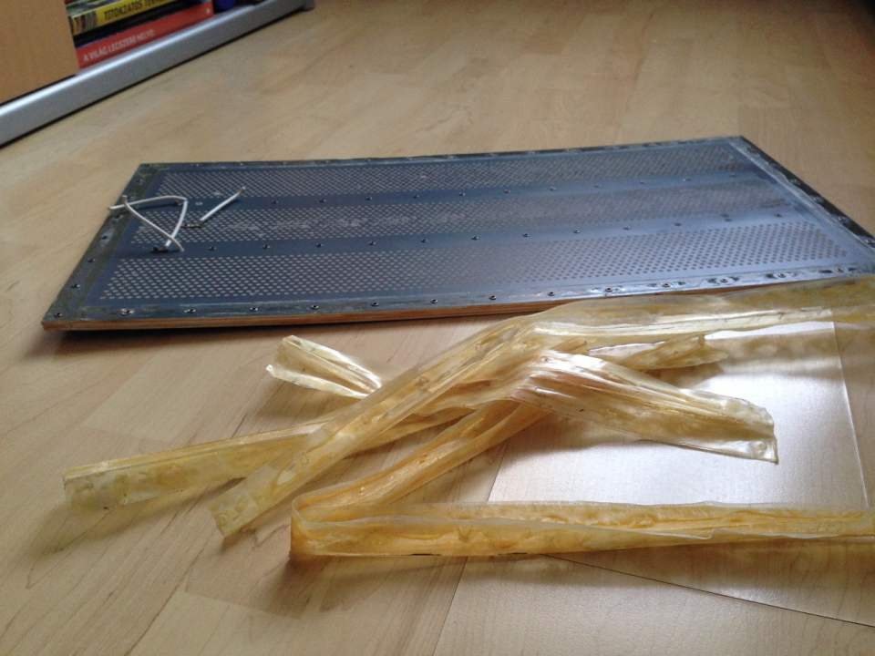

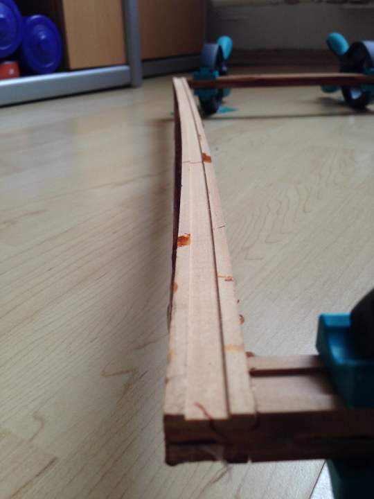

I checked and stripped down the two bass panels. I found out that the panels are more flexible compared to the completed speaker's and the paint and the conductive lines are flaking off as hell. I found the plastic stator more supple also.
http://www.kepfeltoltes.eu/images/hdd1/2017/06/26/242IMG_5078.jpg
http://www.kepfeltoltes.eu/images/hdd1/2017/06/26/559IMG_5096.jpg
http://www.kepfeltoltes.eu/images/hdd1/2017/06/26/869IMG_5107.jpg
http://www.kepfeltoltes.eu/images/hdd1/2017/06/26/922IMG_5094.jpg
http://www.kepfeltoltes.eu/images/hdd1/2017/06/26/602IMG_5118.jpg
http://www.kepfeltoltes.eu/images/hdd1/2017/06/26/490IMG_5122.jpg

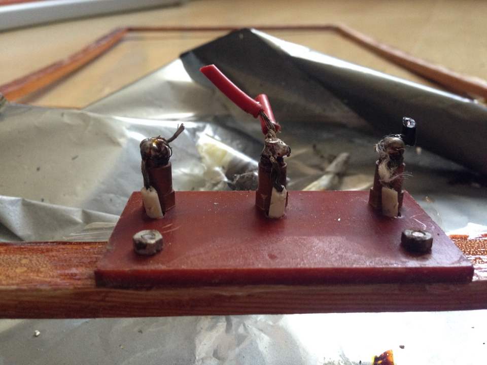

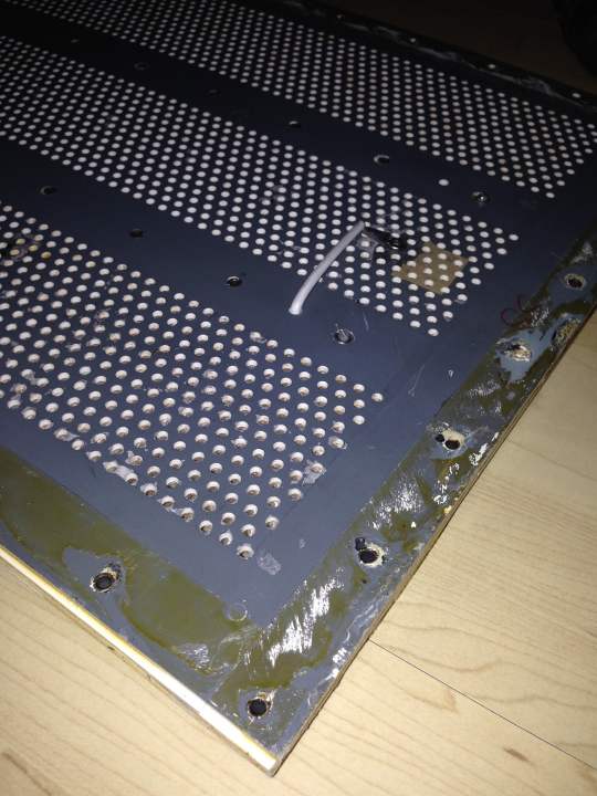

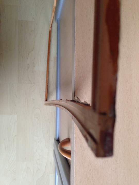

I don't know, but I am sure that these panels made with the least care. One of it was riveted once, disassembled, and riveted elsewhere with new holes drilled and the old ones glued out with epoxy...What a view it was...
The other one's got this paint-flaking problem only. Yeah, and I almost forgot

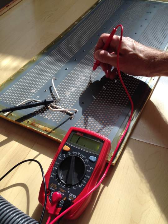

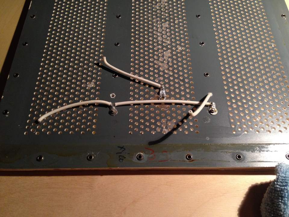

to mention that both panels had problems with one stator's signal continuity. I recognised this after a good brush vacuuming. Maybe, I vacuumed off the continuity, who knows, but I have to deal with it somehow.
http://www.kepfeltoltes.eu/images/hdd1/2017/06/26/412IMG_5111.jpg
http://www.kepfeltoltes.eu/images/hdd1/2017/06/26/199IMG_5114.jpg
http://www.kepfeltoltes.eu/images/hdd1/2017/06/26/936IMG_5115.jpg

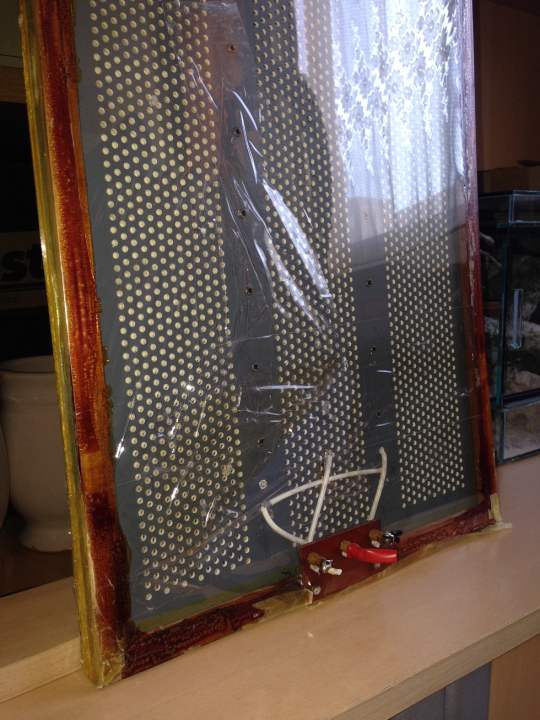

I like curves, but not here. Hope this will help out the deformation off the frame.

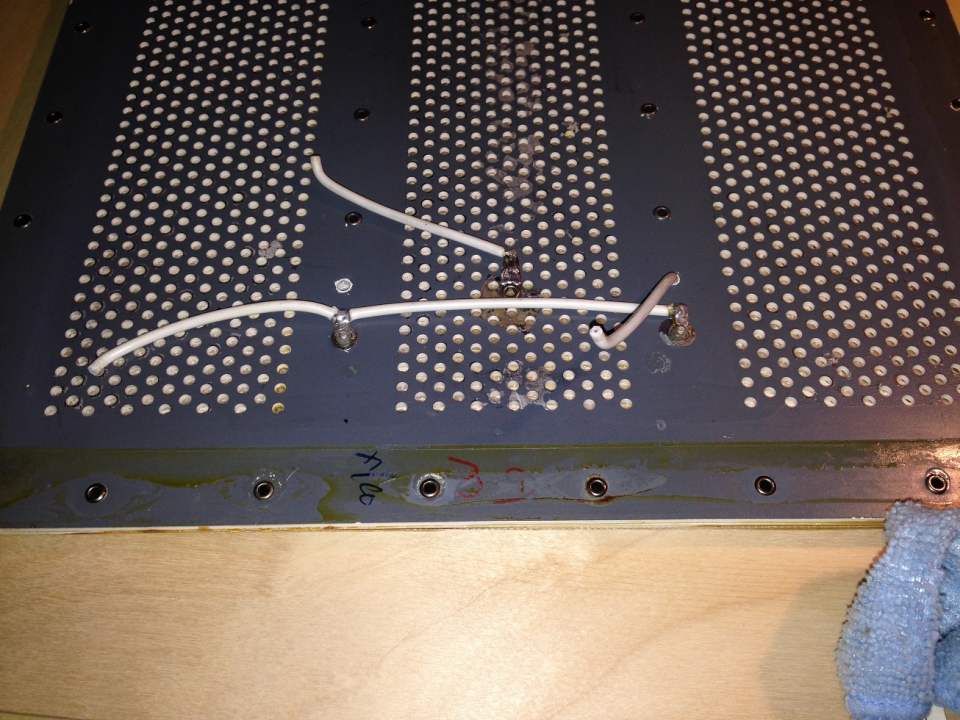

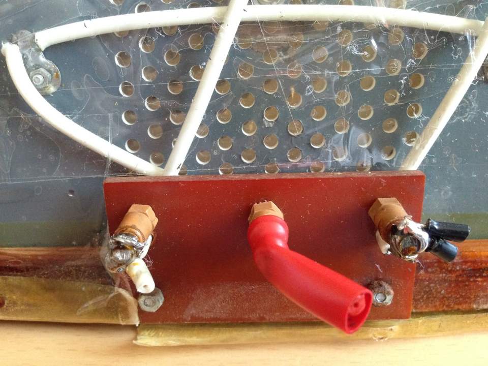

error in continuitiy at the back stator...
The other bass has the same problem but at the front stator:

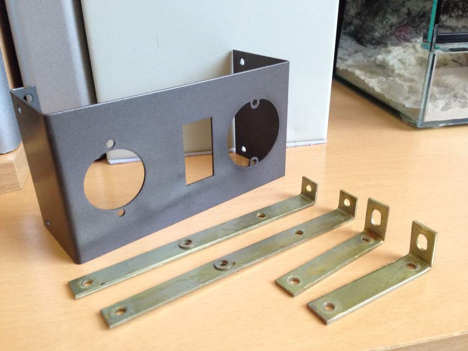

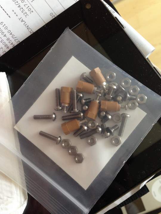

the new hardwares
http://www.kepfeltoltes.eu/images/hdd1/2017/06/26/305IMG_5130.jpg
All the screws that I will use for this ,,project".

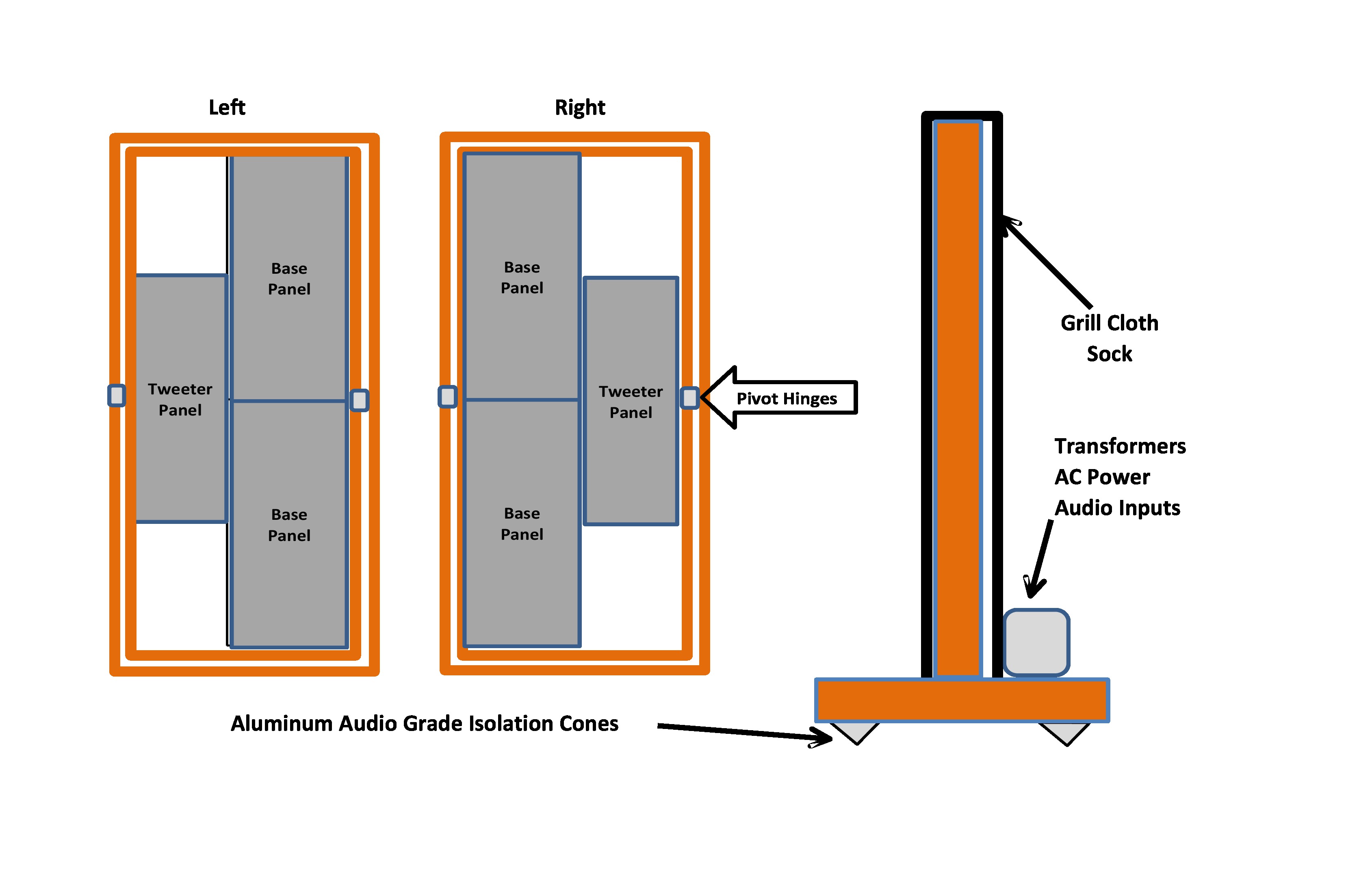

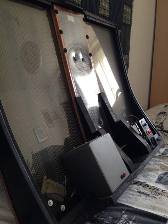

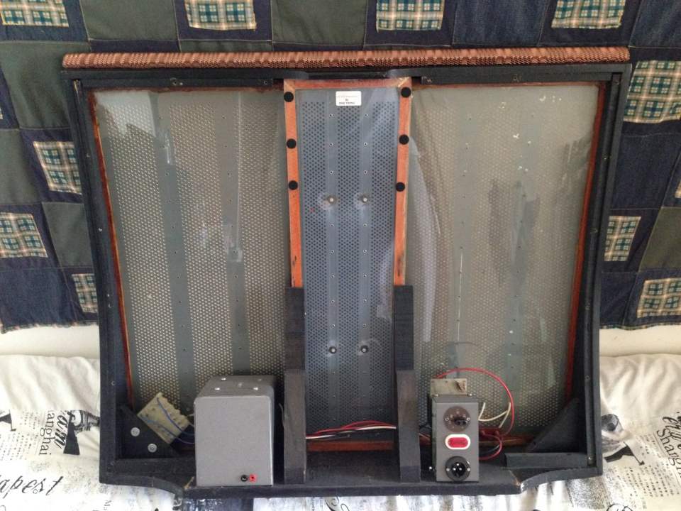

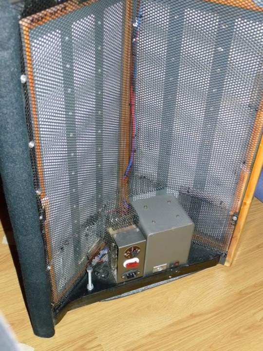

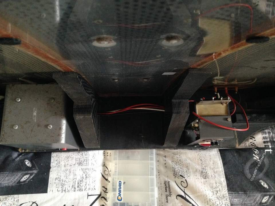

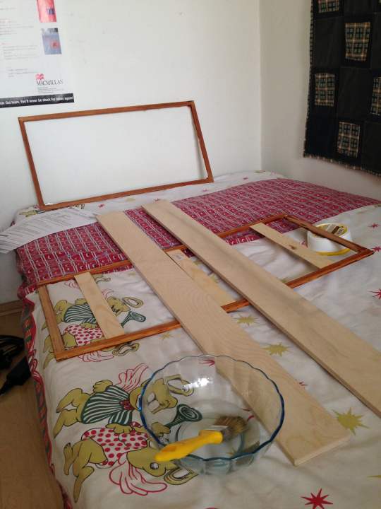

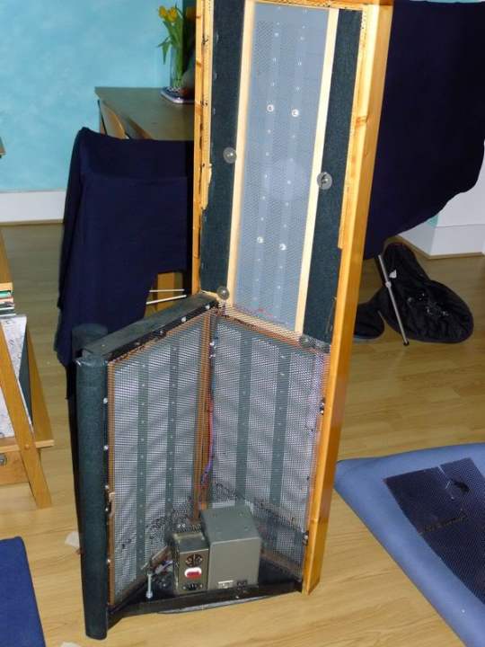

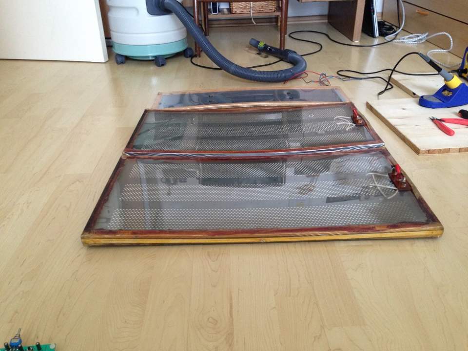

I stacked the base panels on top of each other and mounted the tweeter panel to the side. View attachment 623088
I am rather visual Now, I got it. Interesting set up. If I remember correctly, I've seen Lindsey Allen Quads, where they put the treble next to two bass panels rather than between the two. Ive never heard a pair
The original Quad is amazing, in comparison, the reconfigured is out of this world.I am rather visual Now, I got it. Interesting set up. If I remember correctly, I've seen Lindsey Allen Quads, where they put the treble next to two bass panels rather than between the two. Ive never heard a pair

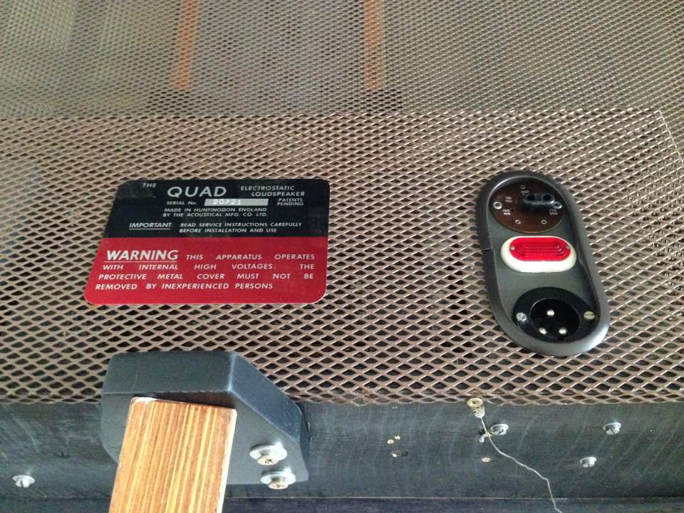

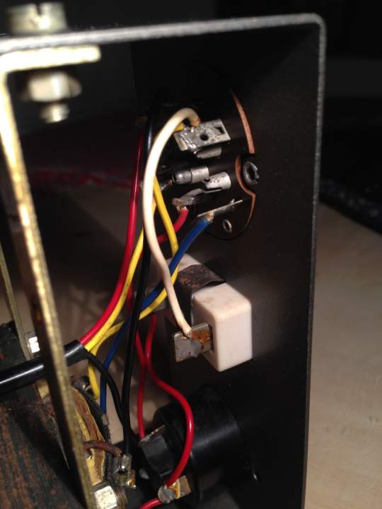

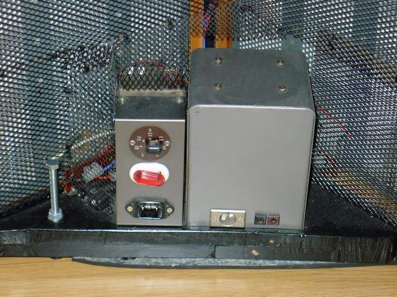

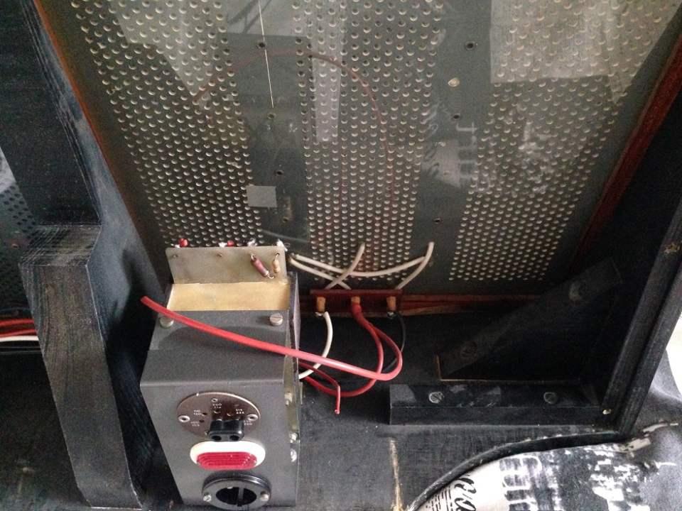

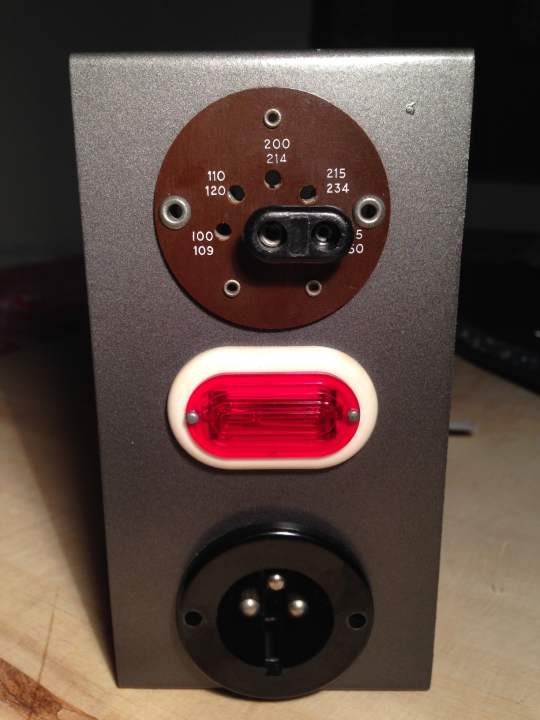

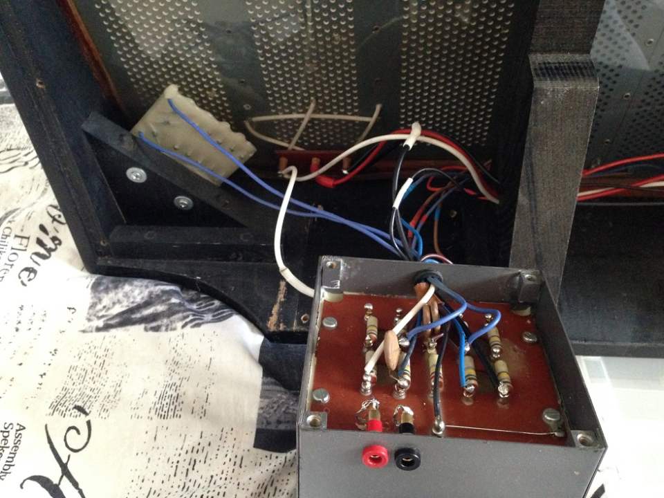

EHT unit
EHT unit was in a good shape, but I would like to match the two speaker's color. Parts are now ready for powder coating.

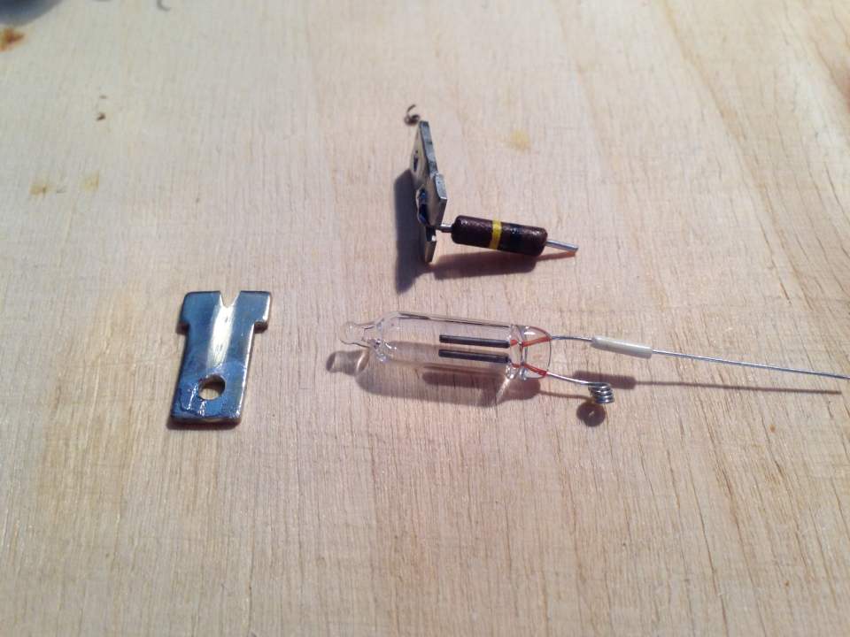

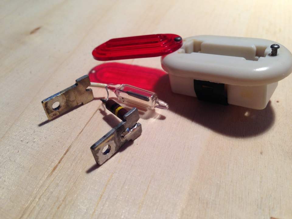

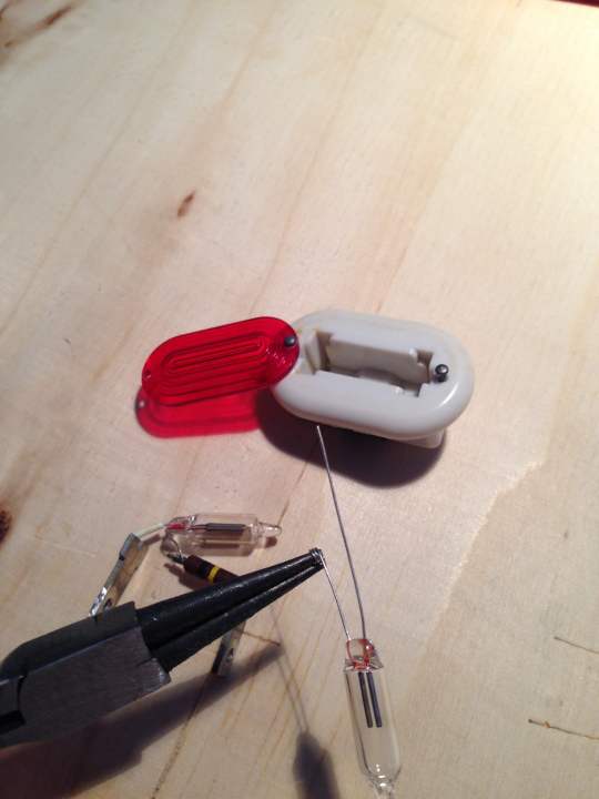

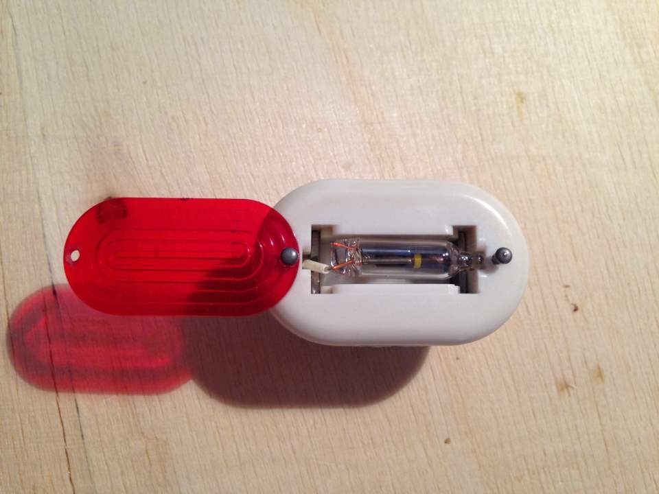

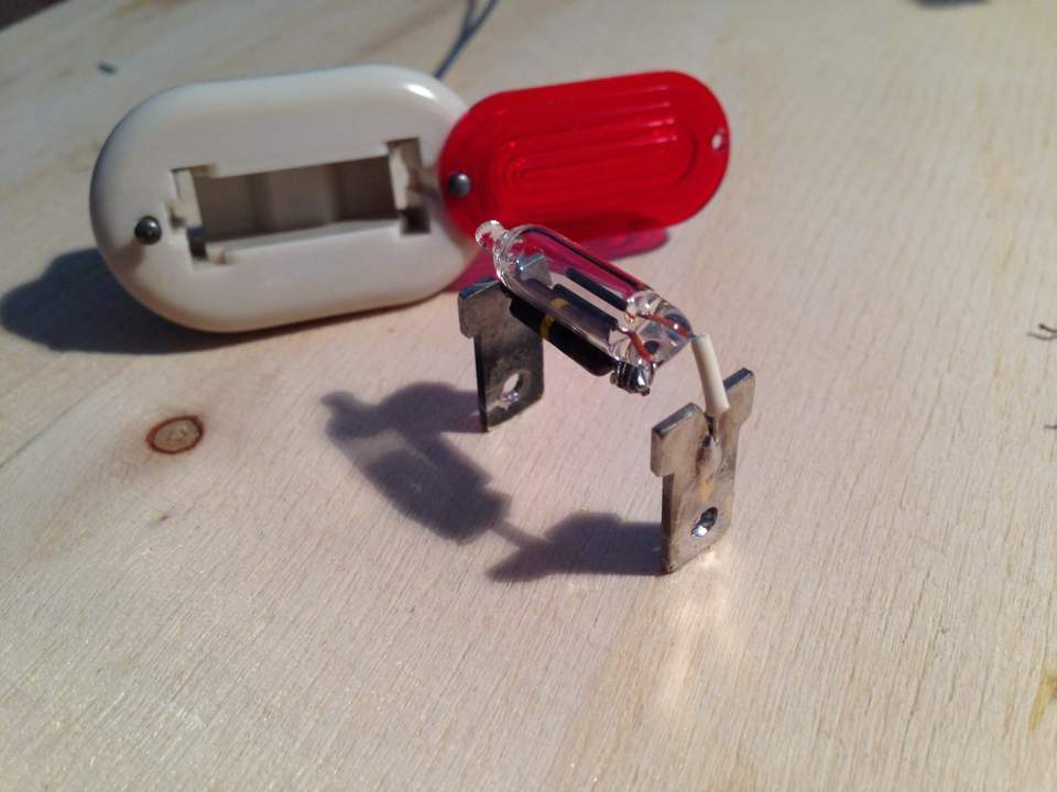

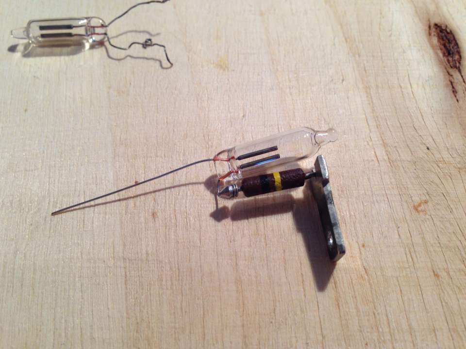

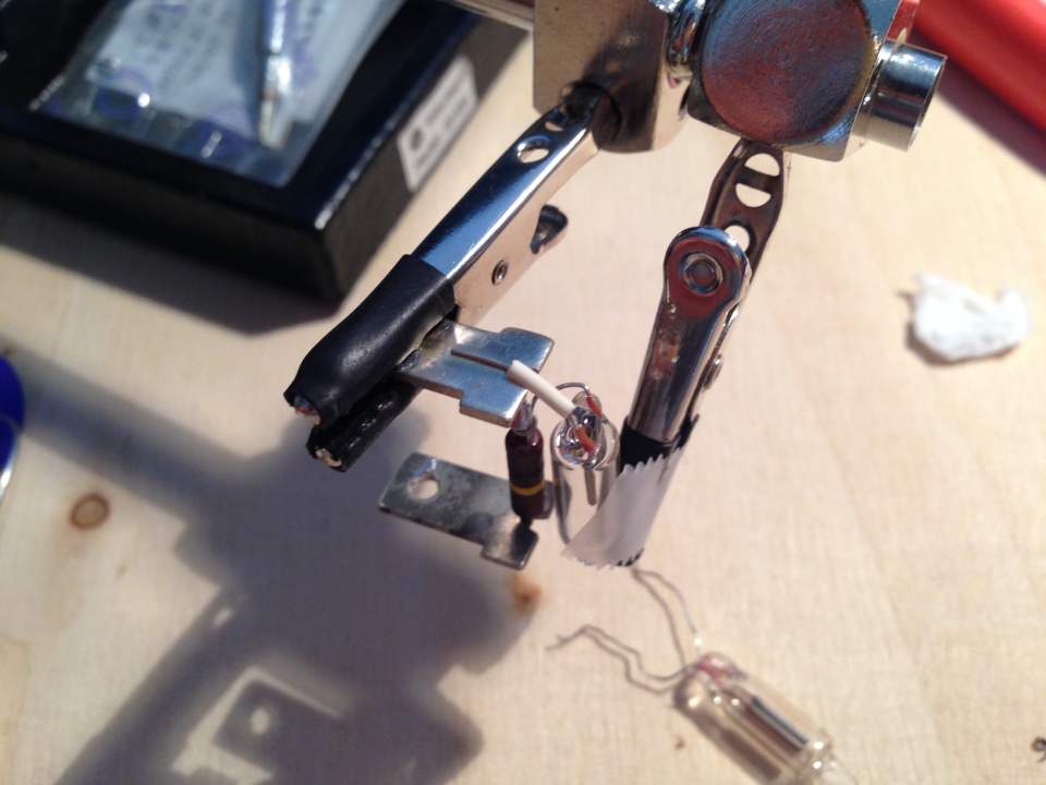

Changing the neon
