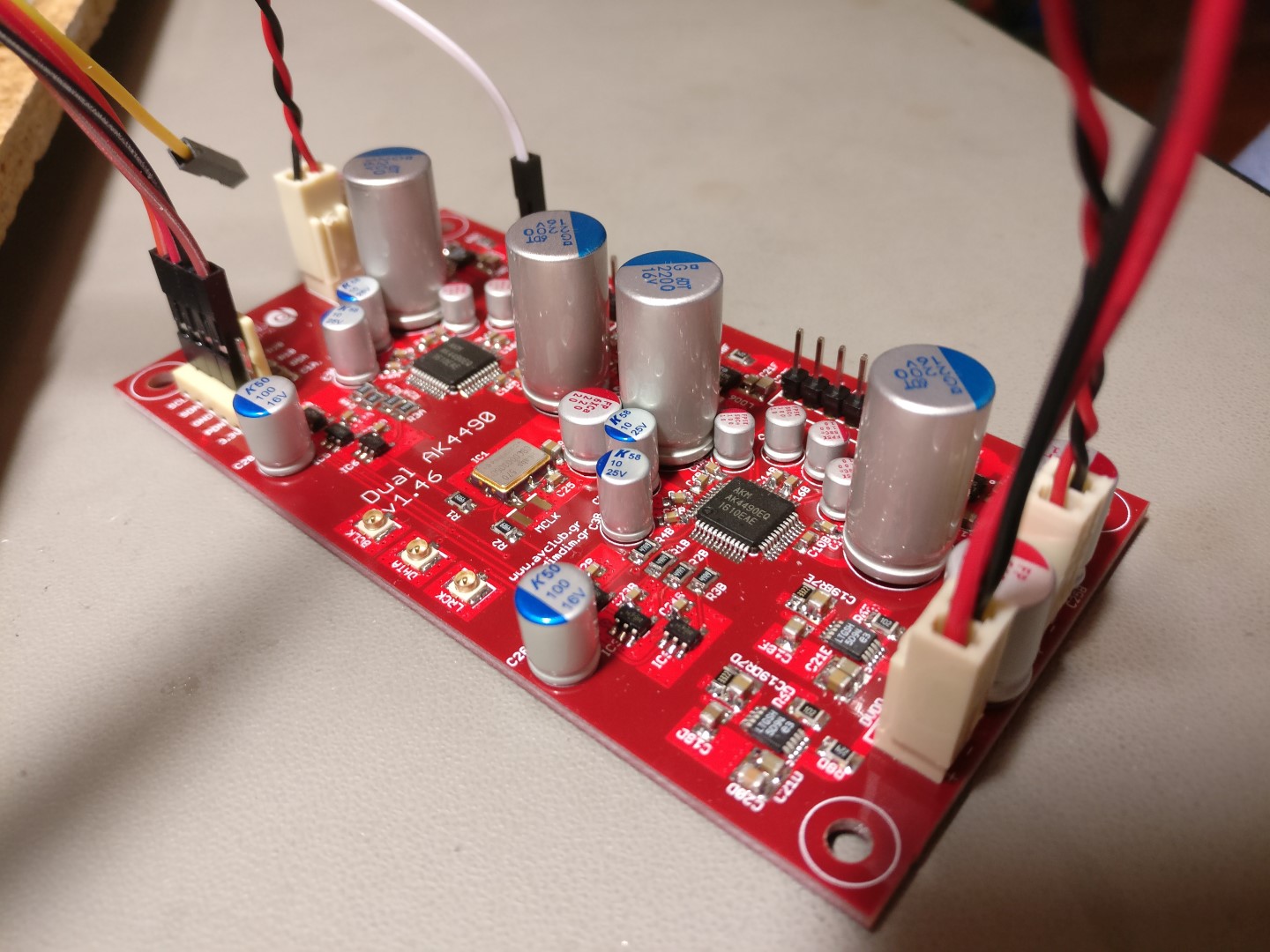

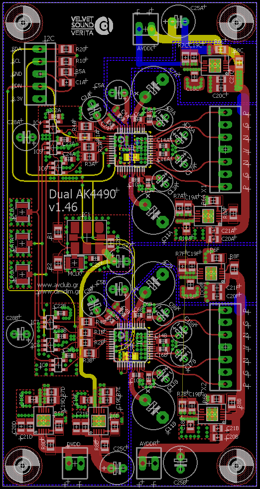

So I ended up with this 4-layer design:
attachment.php
I went with LT3042s as local regulators.
I would control it with an Arduino via I2C.
The boards were ordered and about a month later were delivered so I built a prototype:
attachment.php

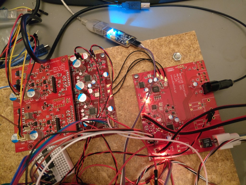

..and tested with an RPi as an I2S source:
attachment.php
Everything seemed to be working fine.
Meanwhile, I had also designed an AK4118 based s/pdif receiver with an on-board AK4137 SRC and a second selectable I2S source input (Arduino controlled of course..) and that had come along quite nicely. One of my friends had designed a class-A discreet analog stage for which I had designed a PCB and that too was working fine.
attachment.php
So we had come to the stage of the full system tests.

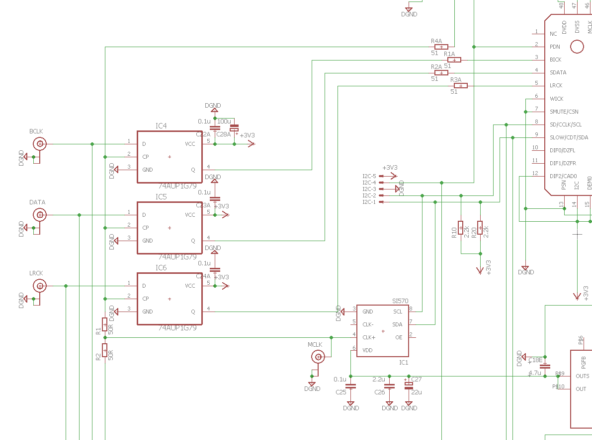

For the reclocking I have done this on my design:
attachment.php
but we are also getting the same results when bypassing my "questionable flip-flop design" and using Acko's well known reclocker.

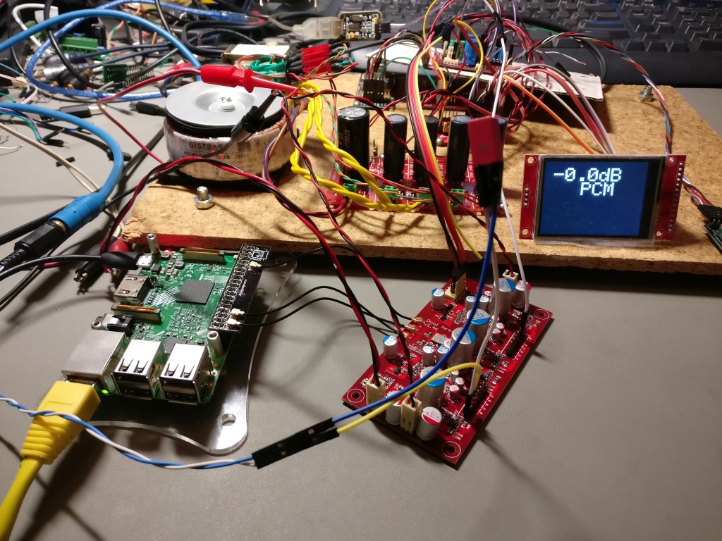

Dimitris described the problem very well, I couldn't to describe it better because my english is like the old man running!
I used the same AK4490 dual board, but with bypass the 74AUP1G79 d-type flip-flops due the Acko S03 reclocker that I have.
An Amanero board joined at the Acko S03 and the output of AckoS03 board going to u.fl of AK4490 board.
The output of the AK4490's analogue stage (I used a transformer output) captured by an EMU-0404 with ARTA FFT Analyser.
The same issue, the noise floor of signal jumps periodically (seems like signals unlocks for an instant) with no any particullary time. Every two seconds, every 6-10seconds, every 21 seconds, something like lotary! But, there is no any problem to any acoustic listening, no click, pop, scratch e.t.c.
This reclocker uses the Potato 74AUC1G74 chips d-type flip-flops.
If I remove the Acko reclocker and put the amanero alone, everything is OK!
With carefully, I examined the i2s signal by oscilloscope and compared the amanero output via reclocker output, but the signal was better on reclocker side, the data eye pattern was improved, the only strange point was a ghost signal with 20ns delay on reclocker bit clock ouput (look the next video).
The next video is the FFT issue with the noise floor pull-up every 10 seconds.

Did You try to invert the clock edge which is going to the reclock flip fllop?
Very probably You have a logic hazard situation, and You should introduce a delay (into the data path) But inverting the clock could be fortunate, and bring forward the moment of latching..
Problem is that with changing data rate You should continously control this situation..

Have you tried to short R1 ? : assuming R4A is connected to MCK of both 4490 there are two RC network between MCLK input and the 2 4490. This may affect slope of MCLK on 4490.
Better implementation is maybe to have one 50R per input (on each D latch and on each 4497) rather than sharing the damping resistor. When sharing it, you sum the caps of each input.
Is it the same Si570 circuitry used when you try with and without the reclocker ? If not, you could consider that the issue is not the reclocker but the delivery of MCLK to the 4497. If I remember well AKM datasheet warns about relationship between MCLK signal and SNR.
Last think, UFL and coax are transmission lined, it may be useful to terminate them by 50 or 75R according your coax. Maybe they are, but it does not appear on the schematic fragment.
Inverting MCLK between the D Latch and the AK4497 is a simple thing to try too.
I can try that, even though I've checked the MCLK both at its source (Si570) and on the 4490's pin and they look pretty much identical.
The 4490s appear to be pretty tolerant of the MCLK. I've tried MCLKs starting at ~11MHz (the lowest specified) with no change. Manolis even tried a 3MHz signal that he had available, and the 4490 still produced sound (even though it had a lot of THD..). Even with a completely wrong MCLK, the chip works, even though the THD increases to over 3%.
You mean to put a 50R resistor before each flip-flop, plus keep the R4 resistors, right?
Information on proper termination of signals of this kind is kindda sketchy.. I've done a lot of reading and I still haven't got a proper grasp on it.
In case of the resistors before the flip-flops, shouldn't the termination be of "parallel" type? Via resistors to gnd? But since the source of the I2S signal will be "seeing" two resistors in parallel, it will be seeing half the resistance. But an even better way to go about it would be to buffer & split the signals properly. But that adds jitter. And so on, and so forth..
So I just left the signal as it was, improperly terminated. The pulses look just fine on the ol' scope, so it should be working OK.
We've tried both with the Si570 and without, with MCLK coming either from Acko's reclocker or directly from the Amanero with the same results. What I haven't tried (and I believe neither has Manolis) is Acko's reclocker on a single-4490 board with no reclocking. But I might be mistaken.. He'll let us know.
See above, they are not, but that doesn't seem to impact the shape of the pulses.
I will try the inversion of the MCLK.

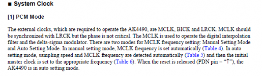

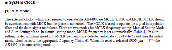

Dimdim,
Back from work I had a look the datasheet to confirm something I has in mind : according AKM datasheet (4495,90 & 97), phase of LRCK regarding MCLK doesn't matter BUT they have to be synchronous. That means you should reclock with the clock provided by your I2s source : AK4118 or AK4137, I dont know your setup. I believe you cant't use an arbitrary source even with close frequency, they will never be isochronous unless you sync with a gps...
But that seems to work without the reclocker... Maybe the reclocker influence, which resample the signals, highlight the little freq difference between the I2S source and the VCXO causing some bit loss when loosing a phase (H or L) from LRCK on a MCLK rising edge.
That may explain the relationship between the sampling frequency and the occurrence of the noise floor jump.
Easy way to confirm/infirm this hypothesis : remove the si570 and provide your DAC board with the MCLK out of your 4118.
