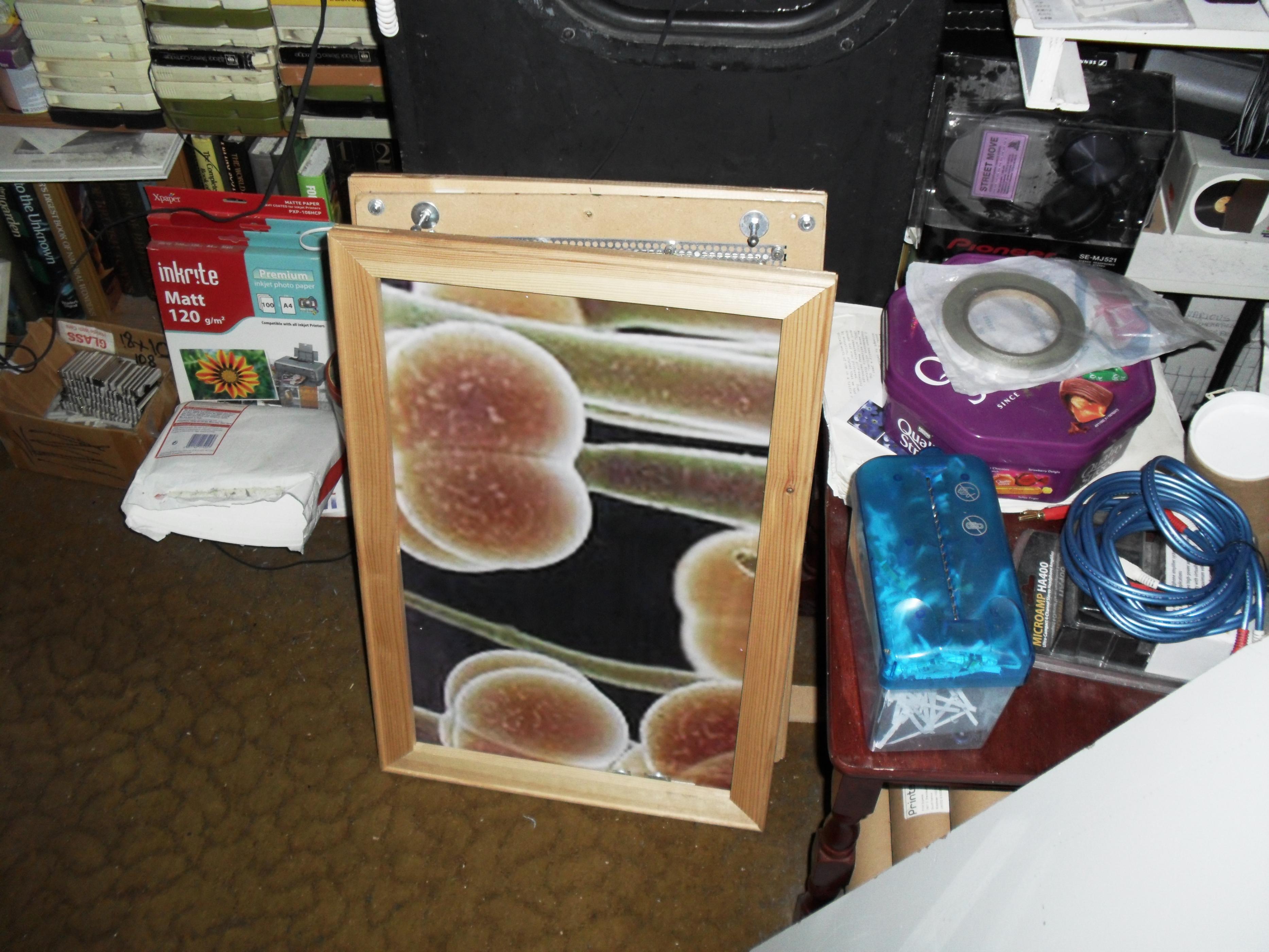

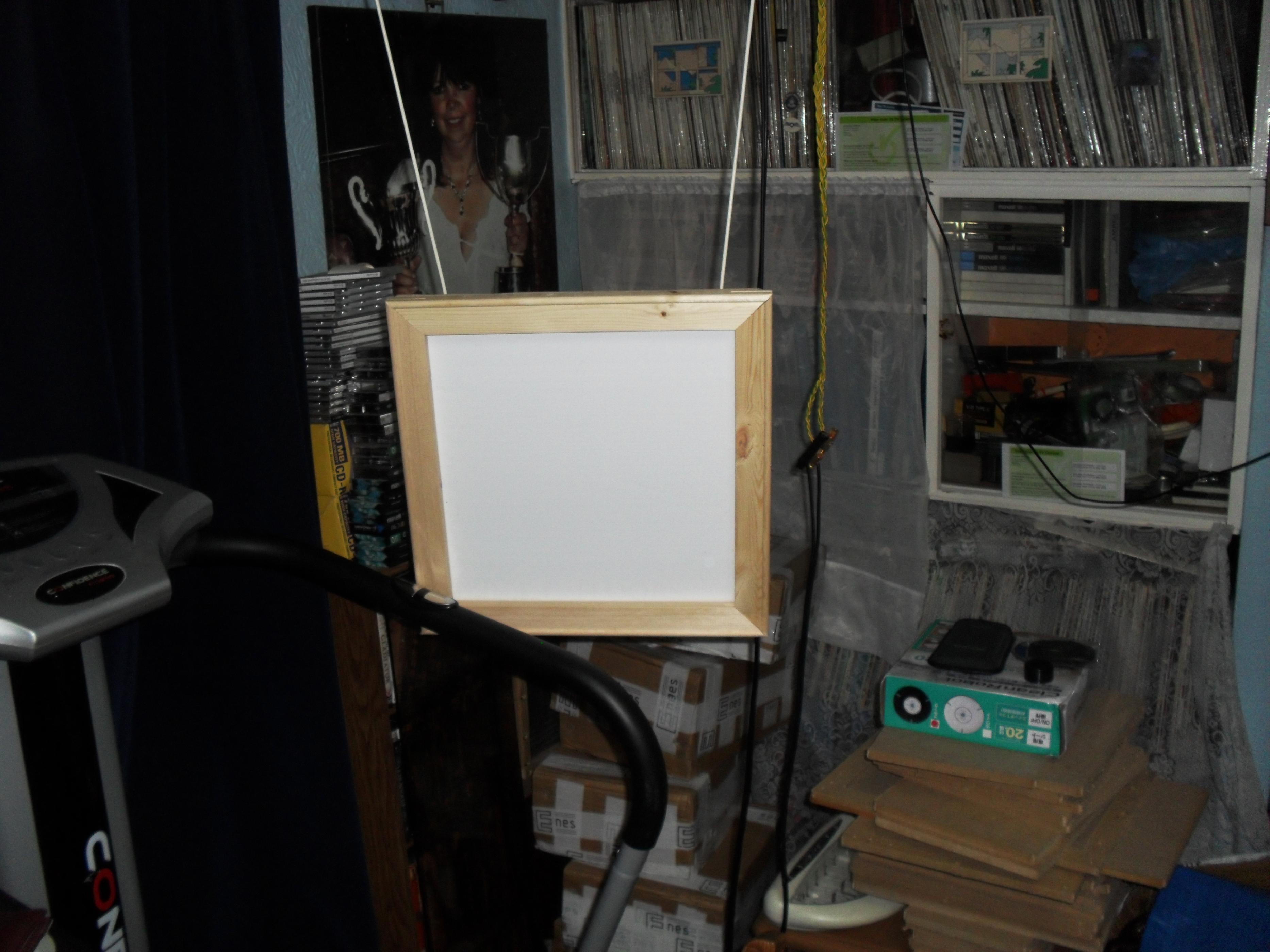

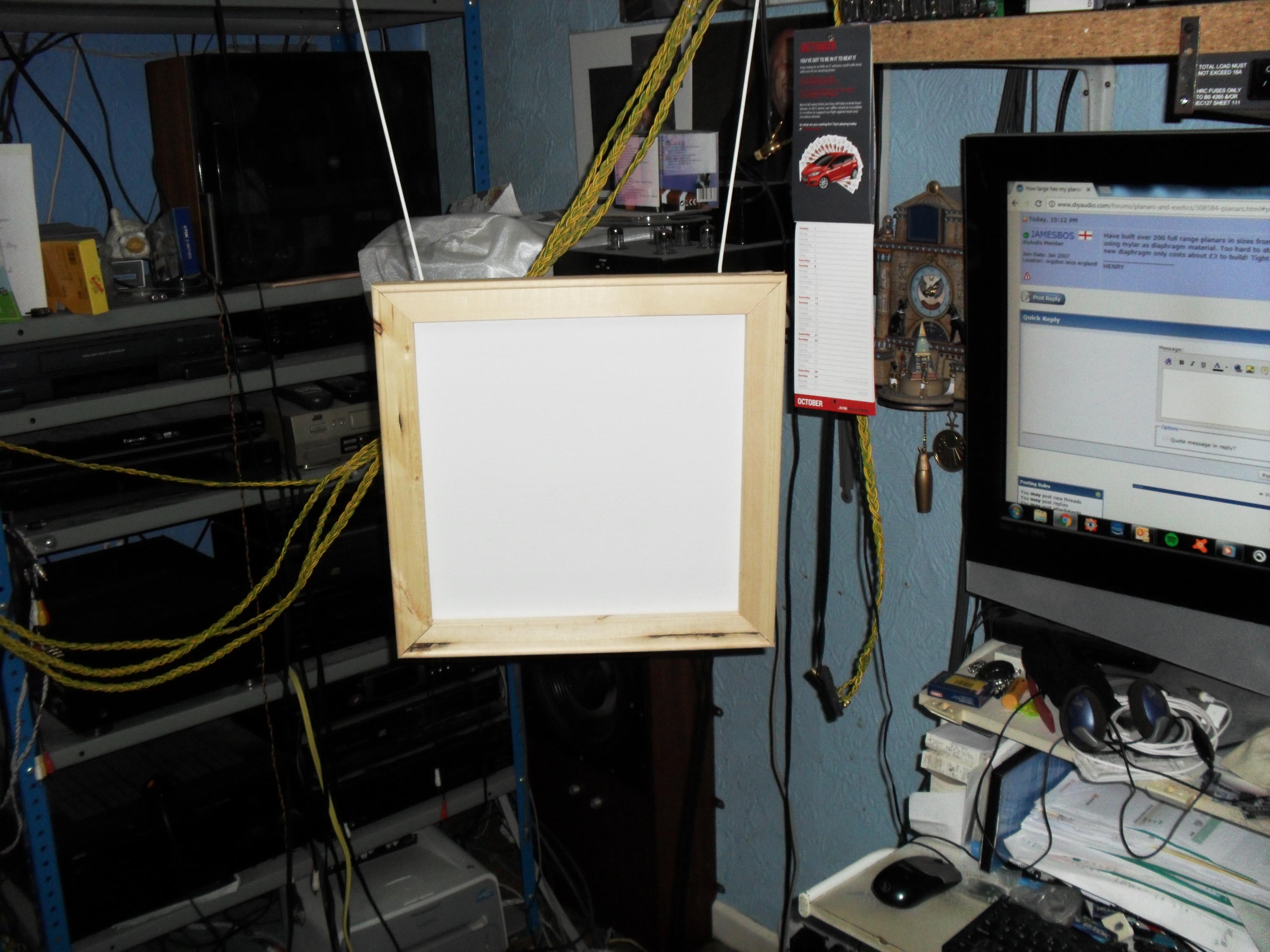

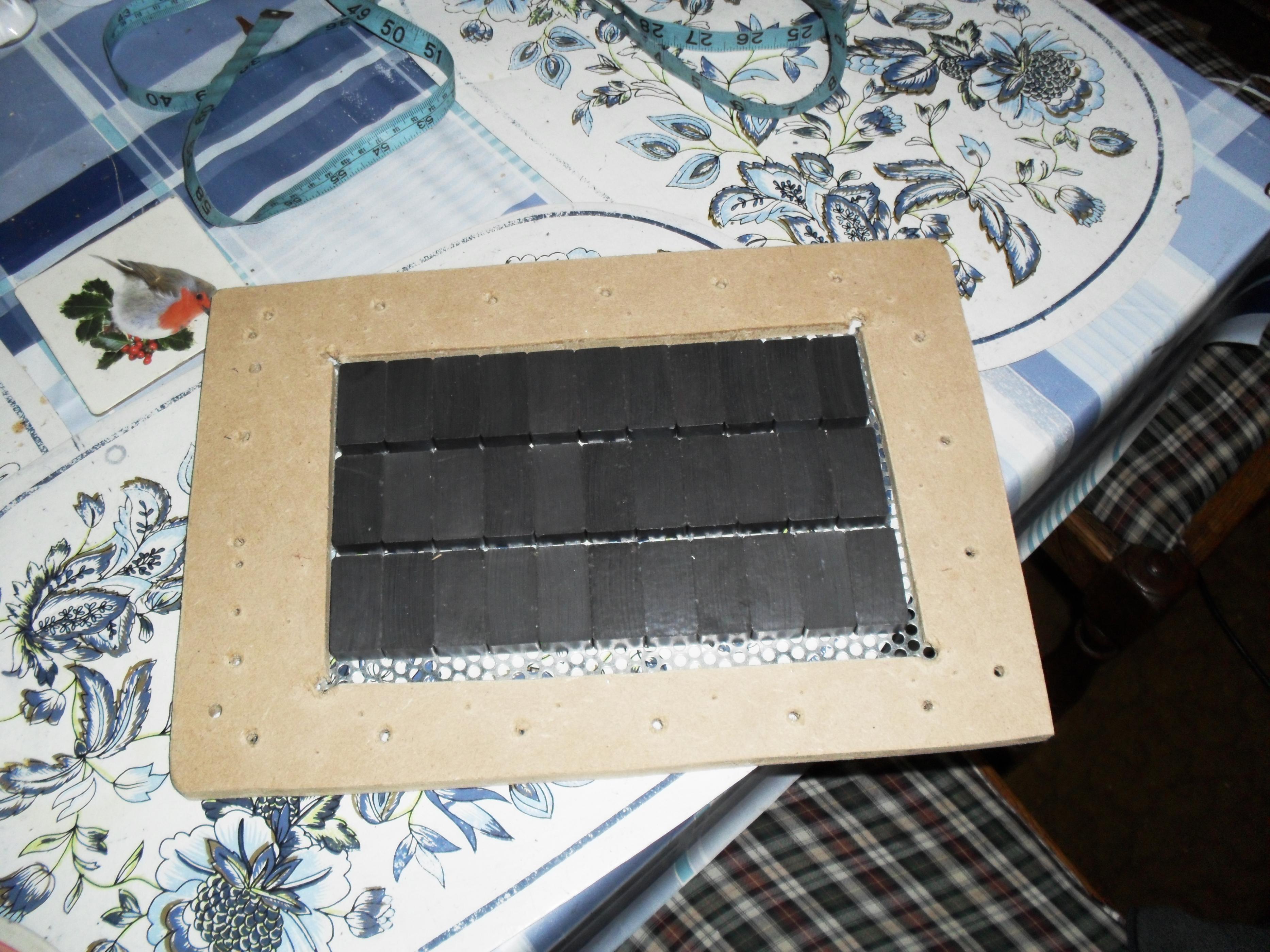

Have built over 200 full range planars in sizes from 8" x 12" up to 7' x 2' using neos and ferrites, I have stopped using neos too expensive, have also stopped using mylar as diaphragm material. Too hard to stretch the material I use now does not need stretching. I have simplified the build as well very easy to build. A new diaphragm only costs about £3 to build! Tight bass and easy to drive using 7 watt valve amp to drive my latest pair which are 16" x 16" in size.
My latest full range planar no crossover 6 ohms impedance.
