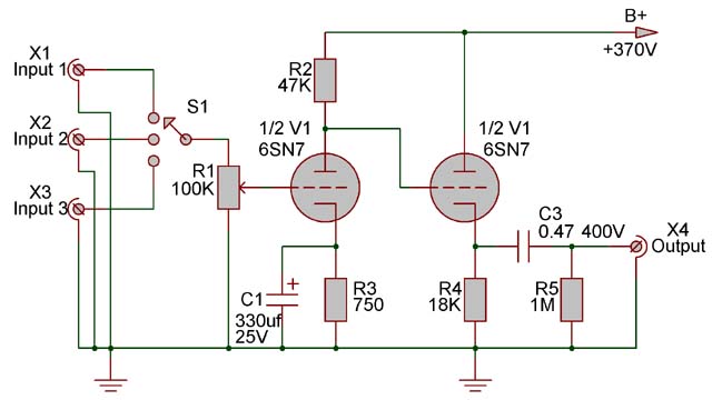

And this for the linestage. Just curious, cause as of yet I'm drawn toward Thorsten Sahib’s schematics. I really want to use those 6SL7’s and 6SN7’s
Konnichiwa,
This linesatge will have a gain of over 20db. Combined with that Phonostage we are taliking overall around 100db gain. That is 30db too much gain for the usual 0.2-0.5mV MC Pickups and 50db too much gain for the usual 2-5mV output MM Pickups. It will also be almost 20db too much gain for any CD Player.
This would mean that your volume control will always be near the left endstop, the preamp will be xcessively noisy and suffer from poor overload behaviour.
For Preamps I'd recommend to consider the following issues in planning gain:
1) A CD player will output eaks of 2.8V with an average level around 14db below this, giving around 0.5V RMS for program material with 14db headroom.
LP's will be cut in the "energy" range of the music with up to 14db above the rated 5cm/s @ 0dB and a "bogey" MM Pickup outputs 2.5mV @ 5cm/s with a "bogey" low output MC pickup at 0.25mV.
This means we can have levels with a similar peak/average ratio than CD and similar average loudness if our MM Phonostage has a gain of around 46db and our MC stage of around 66db.
Most modern amplifiers will have an input sensitivity of around 1V RMS for nominal output. Older Valve Amp's and some rather badly designed modern Valve Amp's have a lower input Voltage, very few Amp's (such as my preferred 2-Stage Amp's with medium to low Mu triode drivers and DHT outputs) require a little more input.
This suggests that our Linestage will most of the time be required to attenuate, to have a littlke extra gain can help in marginal combinations, hence my preferred 6db Linestage gain.
So, the overall for a full function preamp with MC Input and the volume full up should be around 72db (the CAT matches that exactly) and for the MM input 52db (the EAR 834P which is a MM Phonostage aimed at directly driving integrated Amplifiers at CD level BTW has pretty much exactly this level of gain), in practice even these values tend to be 6db too high, leaving 6db gain reserve in the Phonostage and 6db gainreserve in the linestage, based on 1V Amplifier sensitivity. Any higher gain levels will cause serious system matching problems.

Valves, Millercapacitance and feedback circuits
Konnichiwa,
Well, it seems I made my usual error and actually assume that those who claim to understand electronics are sufficiently competent not talk complete loblocks (as they say on Planet anagramia) and hence will make some sense and the rest doesn't want to know anyway. Seems I'm wrong.
So hence, let's evaluate, strictly on paper and in a simplified form the 6SN7 parallel linestage.
First, open loop we have an anode impedance of around 8k. Paralleled this gives an internal impedance of 4k and with a 10k Load a stage gain of 12.6, this comes from comparing the Load (22k//10k) Rl and the internal impedance of the stage (4k) Ri as voltage divider and reducing the Valves Mu by this factor as:
Gain = Mu/((Rl+Ri)/Rl)
Now we can calculate the Miller capacitance and using this also the input capacitance. For average Valves my Datasheets list 3.3 & 3.5pF as Anode-Grid Capacitance, so both systems in parallel show 6.8pF which will be "amplified" by the stage gain, 12.6 to give a virtual 85pF input Capacitance between Grid and Andode. Adding the other parasitic valve capacitances we get a rounded 100pF capacitance if good quality (ceramic) sockets are used and the layout is sensible.
Now we can calculate the relative impedance of the gridnode to obtain the OPEN LOOP bandwidth (note that this a looped feedback amplifirer stage).
At the worst case (volume control at -6db setting) the 100k Volume control will present around 25k output impedance, to this is added the 100k Input resistor of the inverting, looped feedback amplifier. In parallel to this overall 125k impedance is the feedback loop and internal impedance of the circuit, so basically 244k. In parallel this gives a impedance of 82.6k.
If we combine the 82.6k and the 100pF we get a timeconstant of 8.26uS or a -3db point of 159115/8.26=20KHz.
So, OPEN LOOP we have a -3db point of 20KHz in the worst case scenario. This frequency is shifted upwards in the usual manner as discussed by Harold Black in the 1930's by the diference between the Open Loop gan and the closed loop gain.
In my case the closed loop gain is 2, so we have around 6.3 or 16db feedback factor, so in theory and not accounting for some of the parasitics I include in my P-Spice simulation (such as the 1nF output load of the 10k/1nF IEC Load) we have theoretically a closed loop -3db point of 126KHz under worst case conditions, but only if there is no capacitive load. My simulations assume 1nF capacitive load and hence are less favourable.
Let's also work out the apparent output impedance of the Linestage. WE have a 22k Load in parallel with a 4k internal impedance, giving under open loop conditions 3.4KOhm output impednace. This will be reduced (again) by the feedback factor giving us theoretically around 530 Ohm output impedance.
A last check would be how much the difference between fully open and worst case setting on the volume control is. Using above Methode we now have 100k//244k to give 71k effective impedance at the grid node. This gives a 7.1uS timeconstant or 22.4KHz open loop -3db point and closed loop theoretically a 141KHz -3db closed loop.
This concludes the current EE101 lesson for those who wanted to know and those who obviously slept through EE101. We thank you for your attention and suggest that everyone her or himself evaluate designs themselves, using sensible methodes instead of listening to people who obviously lack basic analytic skills (or deliberatly distort the truth - I leave it to the audience to decide which takes place).

<"If we combine the 82.6k and the 100pF we get a timeconstant of 8.26uS or a -3db point of 159115/8.26=20KHz.">
Actually 17.5k, using the electronics computer program, and the
-1db point is only around 8.7k (we will use your own figures), Very poor open loop response indeed. Similar to open loop SS designs with feedback, esp in the old days.
The only reason the open loop FR is even this good is because of his feedback scheme and the need for the 220k in the circuit. Of course Thorsten needs to increase the open loop FR response. Very messy circuit indeed. Remember how delicate music is and how easy it is to upset things sonically.
You finally got around to mentioning the 16db of negative feedback to try to bring up the response and lower the output Z. Real brilliant design there. But there are more problems indeed using this design. Can you figure them out?
By the way, my design has an Open loop FR of over 100khz (pot midpoint) with 100pf/100k load, extremely low distortion, and output Z pretty low. All without 16db of feedback to screw the sound up!

Konnichiwa,
A computer program that arrives at 17500 when dividing 159115/8.26 seems rather inacurate.
And if you mean to say that your program arrives at a different analisys, you should be able to point out the ommisions in my calculations (which where done primarily for breviy and clarity), that assuming of course that you actually understand what is going on, which based on your comments so far I am forced to seriously doubt.
Well, number one, the use of Feedback is an inherent design feature. Negative feedback is a design tool, just like any other. It needs to be understood to be used correctly. Only those who fail to understand it take refuge to comments of "feedback is bad" as an absolute.
In my case negative feedback is the primary tool to achieve low gain while using an active stage and avoiding followers. The frequency response and low output impedance are the redsult of doing things that way. One could have used an output transformer to achieve low gain, low output impedance and wide bandwidth, the original request was not to use Transformers, so non are used.
Thank you for your compliment.
There are no PROBLEMS if the circuit is implemented as suggested and operated within it's design parameter limits. We may argue about the way this circuit sounds or not, which would require after all experience with the circuit and it's sonics, which you seem to still lack.
A design, for which you make any number of claims which cannot be verified (unlike the ones for mine) as you fail to share it. I will simply put these parameters down to your usual baseless claims as we have seen in past discussions.
If the use of negative feedback "screws up the sound" the implementation of negative feedback was incompetently done. So you may wish to re-evaluate your views on negative feedback as a design tool.

How about you do so, making sure your math is actually up to scratch and your computer program can at least divide correctly and you math is based on reality not wishful thinking.
And if you mean to say that your program arrives at a different analisys, you should be able to point out the ommisions in my calculations (which where done primarily for breviy and clarity), that assuming of course that you actually understand what is going on, which based on your comments so far I am forced to seriously doubt.">
Your figure is only approx. I actually measured them, but of course measured stray capacitance too, which we both didn't include when starting. But let's give you the benefit of the doubt. The open loop response is still -1db at 10khz and -0,5db at approx 5khz. Still very poor.
<"Well, number one, the use of Feedback is an inherent design feature. Negative feedback is a design tool, just like any other. It needs to be understood to be used correctly. Only those who fail to understand it take refuge to comments of "feedback is bad" as an absolute.
In my case negative feedback is the primary tool to achieve low gain while using an active stage and avoiding followers. The frequency response and low output impedance are the redsult of doing things that way. One could have used an output transformer to achieve low gain, low output impedance and wide bandwidth, the original request was not to use Transformers, so non are used.">
Well, give me a wrong way to use the feedback in a single stage preamp. It isn't hard to do correctly, or at least as best as is possible.
<"There are no PROBLEMS if the circuit is implemented as suggested and operated within it's design parameter limits. We may argue about the way this circuit sounds or not, which would require after all experience with the circuit and it's sonics, which you seem to still lack.">
Well, that sounds suspicious to me. You don't know of any more problems?
And I built the circuit decades ago, so another inaccurate claim. The circuit is only ordinary at best.
<"Originally posted by Positron

Konnichiwa,
Do not distract from the issue.
You measured them. Right. May I ask when you build the circuit? And could you then illustrate the change in response with volume control settings you calimed earlier? Any comments on the sound?
On another line, would you mind illustrating in what sense an open loop response of -3db @ 20KHz in a looped feedback Amp (single stage) is "poor". It is more than adequate for the purpose. The open loop response is a direct result of a number of design choices.
It would be easy to change the open loop response to a much wider one by lowering the impedance values in the feedback setting circuitry and by using a lower resistance volume control. If we (for arguments sake) lower all values by a factor 10 we can easly achive a ridiculously wide bandwidth, which has no advantage whatsoever (sonically or other) and introduces a number of other problems.
It is my experience that a well implemented and sensibly set bandpass behaviour is preferable in linestages, arguably a sentiment open to discussion, however I usually follow my own design requirements when designing something.
Is the above your opinion or are you stating a fact? If you are stating a fact, would you mind illustrating WHY applying loop feedback to achieve low gain and to take advantage of the stages excess gain to improve linearity and lower the outputimpedance is "a wrong way to use feedback"? Maybe you would like suggest the "right" way to use feedback?
At any extent, you may notice that we are now outside the realm of factual performance (unless you can illustrate that the laws of physics have recently gone on annual leave) and in the realm of design preferences and how they relate to sonical performance.
You build a Circuit I published here a few days ago DECADES AGO, with identical resistor, cpacitor and other values? Interresting feat. I now would also ask for plans to your time machine, I could use one.
I will readily admit that similar circuits have been around for ages and some of the best sounding commercial preamps of the last two decades used variations thereoff. So it surely cannot be THAT BAD....

Well, first, are your actual measurement independently verified?
Secondly, the design I presented is strictly DIY, not commercial> A design based around my ideas and parts mostly designed by me is the MF Audio Passive Preamp, the Bent Audio Noh and the DIY Hifisupply Django, plus there are other Preamps using the same core (S&B TX-102) in both the DIY and commercial domain.
Many reviews by many individual exist and they tend to agree in the largest part that the S&B TX-102 based passives outperform ANY active preamp these individuals have tried and also most/all passive linestages from other sources. That is good enough for me.

First, I never claimed that what I did was NOT elementary. As to "How to do it wrong"? For starters loop feedback around several stages and in circuits where there is more than one dominant pole and have an open loop response (-3db) that is substantially narrower than the desired signal bandwidth. But you should know that, if you are 1/10th as good as you claim to be.

How about you do so, making sure your math is actually up to scratch and your computer program can at least divide correctly and you math is based on reality not wishful thinking.">

Gentlemen, would it be possible for one or both of you to post diagrams of what you are discussing? Otherwise, entertaining though it may be, your exchanges are beginning to resemble a pantomime ("Yes, I did" - "No, you didn't").
With the aid of diagrams, a spirited design discussion would be most useful for less experienced members...

I have posted what I am discussing within this thread, at this post:
http://www.diyaudio.com/forums/showthread.php?postid=353015#post353015
