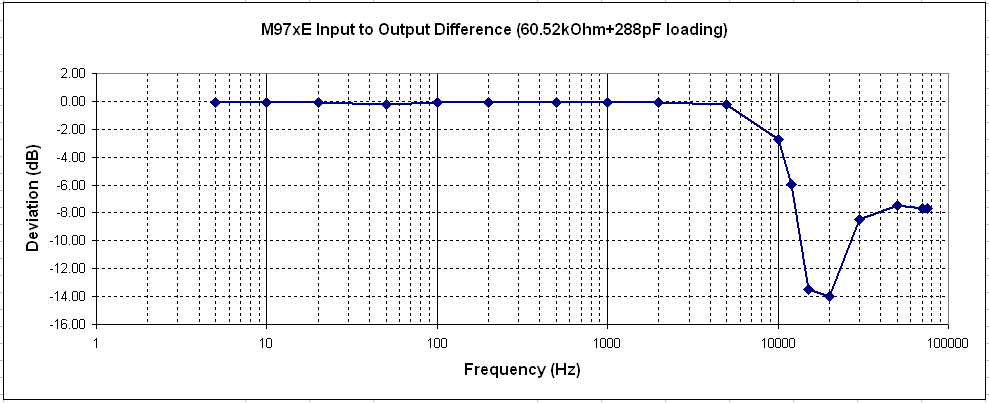

Joined 2002
This is manual spot frequency measurement across the coil of an Shure M97XE.
An 100 Ohm Ro signal generator with a constant 4.91mVrms output, wired in series with the cartridge, feed a Hagerman Bugle RIAA preamplifier.
Cartridge:R:1K55, L:700mH.
0 dB refers to the measurement at 1KHz.
The collected data remained the same on all cases of cartridge position (Cartridge On Air, Cartridge lowered into Groove, Brush lowered, Brush raised, Stylus Force varied from 1 to 2 gr).
I guess the shown resonance is of electrical nature.

An inductance of 700 mH with a 288 pF capacitor gives you a resonant frequency of about 11 kHz so you expect a drop in the response after passing the resonant frequency. High inductance cartridges require low terminating capacity.
I think the whole point is that it is more complicated than that. The electrical and mechanical circuits work together, in this case I assume there is a mechanical resonant peak that works in concert with the electrical roll-off.
Reactions: 1 user
I know the cartridge response is a combination of the mechanical and electrical response. I have a Shure V15VMR but the stylus is unobtanium. The Shure stylus had a stylus resonance over 30 kHz and the cartridge response thru the audio band was very smooth. The best loading was to minimize the load capacity. Shure now suggests a JICO replacement stylus with a stylus resonance around 20 KHz. That completely changes the needed cartridge loading.

George: Not yet worked out why you have a trough rather than a peak in your measurement. I'm being very dim this evening.
