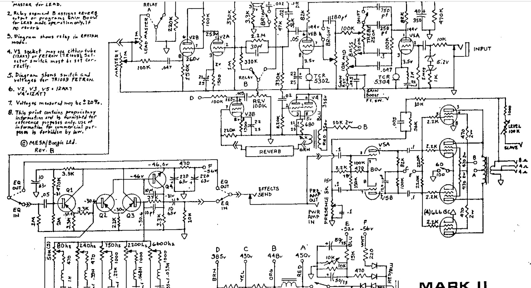

Asym oscillation BEFORE modified Phase Inverter in Mesa Mark II
Mesa Mark II, schematic is posted below. This amp has been modified.

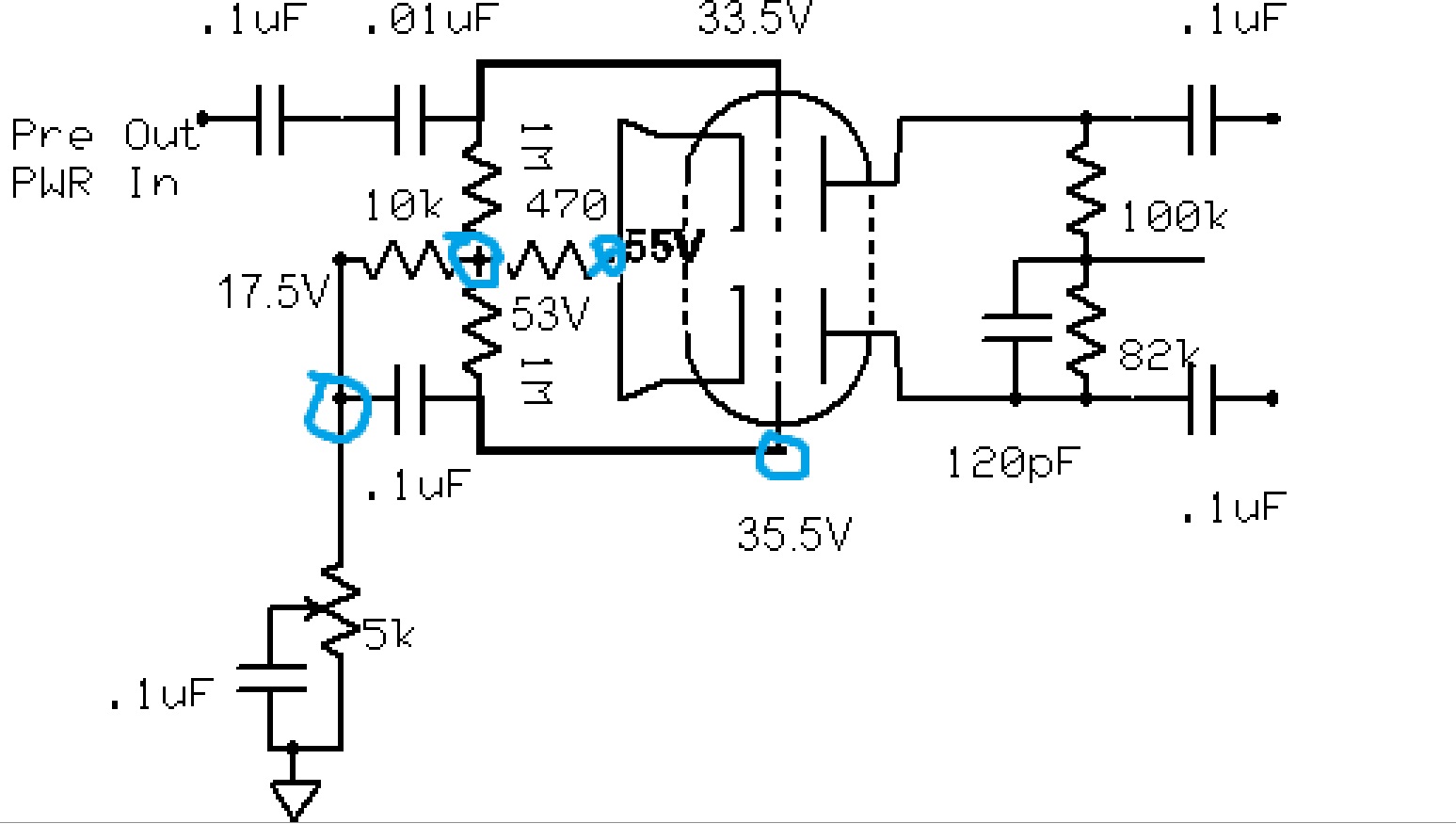

Also posted is a schematic I made to show where changes have been made to the circuit. In blue, are areas where the bottom half of the signal goes into a HF oscillation at a certain level of input signal, during oscilloscope probing.
Notes:
I tried changing power tubes and two different phase inverter tubes (ax7, at7).
Presence control affects the oscillation. At zero (pot value of zero across cap), the osc. rides about half the length or more of a 1khz test signal. As the presence control is turned to MAX, it squeezes the osc. up towards the front.
I am aware of the bias difference between the two tubes, and one side does clip before the other (the side without the osc.). Both 1M resistors measure exactly 1M (they are CC's) with the amp off.
I saw this same kind of thing happen two weeks ago on a Sears Silvertone. When I changed the power tubes on that amp, the asym. osc. went away completely. That amp did not have a NFB circuit or a Presence Control. I hope my test setup is not a factor here! I have isolated my scope and sig gen, along with the amp, to be sure.
  • Mesa Mark IIa.pdf
What bias difference?
Both grid readings are bogus and should not be taken literally.
When you put a 10Meg meter from the 1Meg to ground it meter-loads this stage very seriously. Obviously you can not have 55V-34V= 21V of bias on 12AX7/12AT7! If you have a second meter, watch the cathode as you meter each grid. The 55V is trustworthy. The "34V" are meter-loading multiplied by the self-bias action.
You are not clear if *this* amp has NFB. It would be real traditional here. Power tube series grid resistors also not clear. On factory amps it is not unknown to find 220pFd even 470pFd across both LTP plates (not just the one 120p you show). Also 5K to even 47K grid-stoppers at the 6L6/EL34s.

Back to the Amp, I have posted the schematic as a picture this time. It does have a NFB loop. the 10k and 56k resistors have been removed.
###I discovered something: The oscillation occurs when the load and scope are plugged into the 8OHM TAP, but NOT the 4OHM TAP. The NFB lead is attached to the 4ohm secondary tap, not to the 8ohm tap as in the diagram. The Slave output is still attached to the 8ohm as shown. The problem waveform has a frequency of 122.1kHz.
Removed as in Open? Or removed as in Short?
If you tie the output with no resistance direct to the 5K Presence node, this scheme WILL oscillate supersonics. Also gain will be stunningly low. I'm not sure why anybody would do that to a guitar amp?
Assuming it does have a fairly traditional NFB network somehow...
Bah. We don't want 100+KHz. Put 100-300 pFd across the driver plates to roll-off the supersonic response. That's not the most elegant analysis but it usually works in guitar amps.

BTW, if you are still interested, when I say removed, technically, the 10k is a short (as the resistor is no longer "physically" in the circuit, and has been replaced with a conductor) and the 56k is open (as it has also been removed, and nothing has been replaced. So the .005 cap is in series with the conductor, on it's own). Essentially, there is no resistance in the FB loop.
I'm curious too as to why someone would modify the amp this way.
On the first input stage, the standard 1Meg Grid Load was swapped for a 220k - to lower the gain, right? Then, the phase inverter Grid Loads were increased 10 fold - to increase the gain, right? I've heard that phase inverter distortion has an important role in the tone and character of the distortion in an amp.

A 0.005u+5K NFB loop goes to unity gain above about 10KHz. Few power amps can stand unity-gain NFB. I think you "need" the 10K for stability. This may be conditional depending on load impedance, which on loudspeakers gets far above nominal impedance toward and past (122KHZ!) the audio band.
