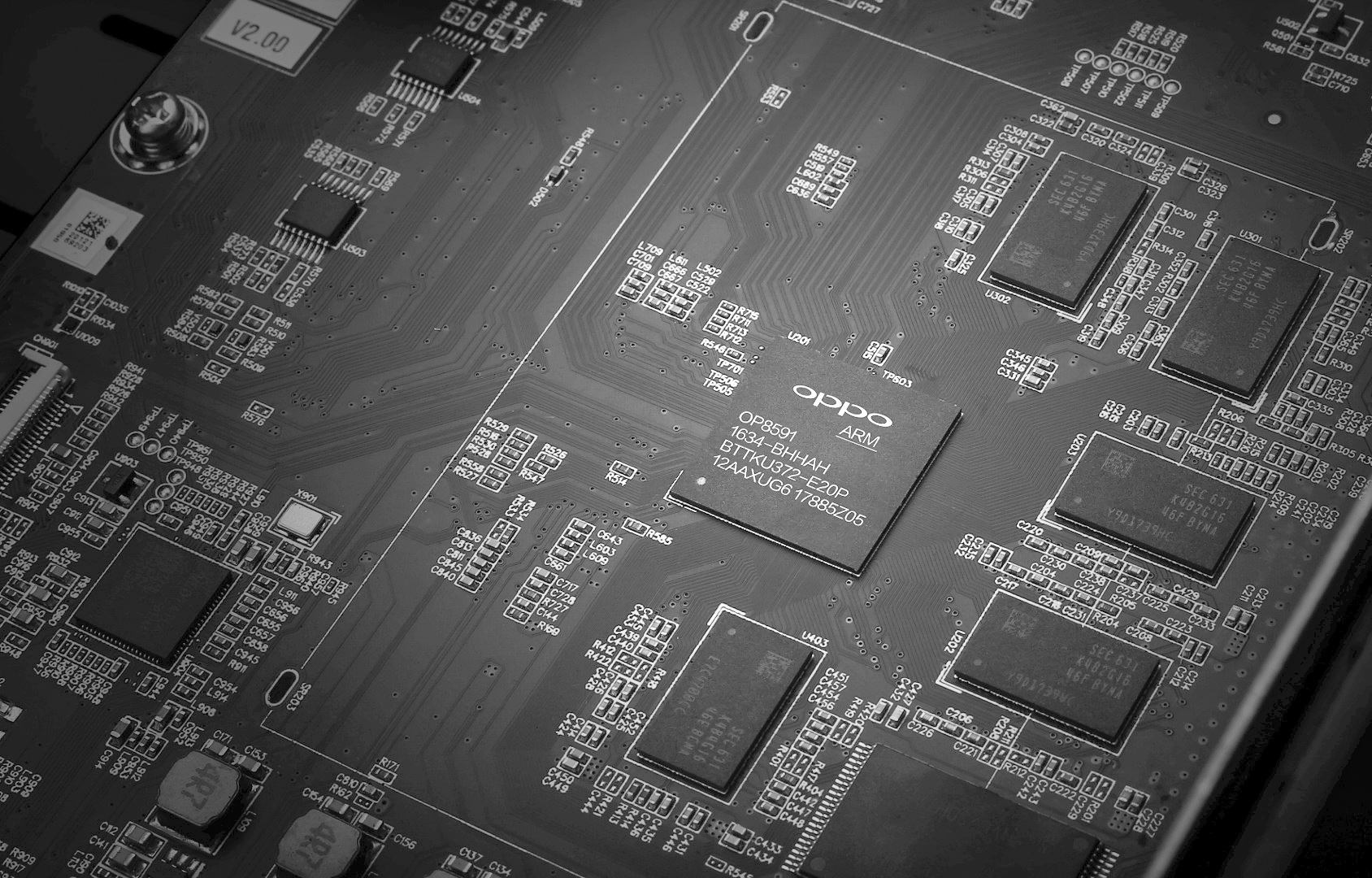

The new models are using also a new main processor, more powerful and less power hungry. Even though less necessary power, Oppo goes the same SMPS way, which in my opinion is enough unfortunate. The new version SMPS is smaller and simpler. Nothing special about filtering and/or a high quality DC output voltages. It may be possible that this last SMPS it use a higher switching frequency, and so the HF transformer became smaller...
A unique 12v power rail (the same approach as for 101 model) now powers the main digital board. From this main 12v rail, are further DC/DC (SMPS) converted and then regulated accordingly for the necessary power rails of the processors on board. Switching mode converters all over the places...

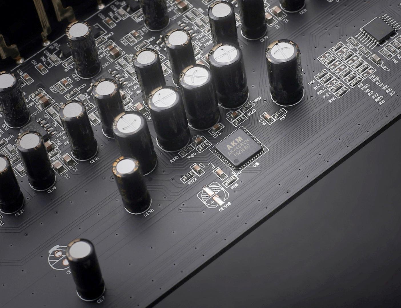

The DAC section in 203 is identical as for 101 model: DAC modules designed for stereo and multi-channel configurations, based on AKM low cost DAC chip. It looks to me that the DAC and analogue section of 203 model is not meant for high quality audio outputs, but more as an audio monitoring option.
Well, the AKM DAC chip it can output more quality analogue signal, but in this cheap Oppo design is not the case. The low cost mute solution, using transistors, it negative affect the overall analogue quality of the signal. The same as the poor power filtering and decoupling on-board.

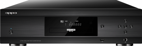

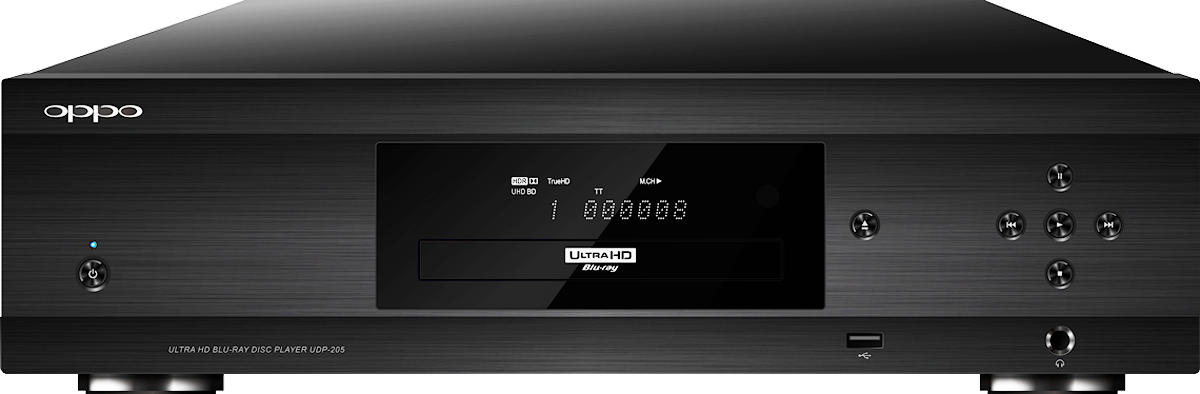

The new coming UDP205.
As we can see (unfortunately) it still be there the headphone output. It seems such option it have a extremely low user demand. We may only hope Oppo have this time better configured the DAC chip outputs, so to not disadvantage the quality of the most used normal stereo outputs (as it was done in 105 models)...
Before launching the new UDP series it was some rumours out there about a OLED front panel display for these series. It seems Oppo had problems to implement a such display in these UDP players. At least for the very new produced models... An OLED front panel display it should be an improvement, not just because a nicer to look at display, but because the existent alphanumeric display it need a high voltage to function. This high voltage is obtained by a DC/DC switching mode converter (a small SMPS), placed into the front panel. This converter it include a HF transformer which it radiate enough EMI noises.
A OLED front panel display it will eliminate the use of a such HF noise generating source, just in the unshielded front of the disk driver. Well, this improvement it was not coming yet this time...

203 use 27 Mhz clock for system and CPU.
Located beneath the pcb.
There is no other clock for HDMI1 processing.
I can find 25 MHz clock just beside of small ARM IC, which seems to
Control BD ROM drive.
Thanks Jae Hong Lee for informations. Very useful. In my opinion, the processor near BD driver it process/decode the 4k (and/or even all the rest of the other standards) data read it out from the driver. The 25Mhz clock it run this processor. I may say that the quality of this clock signal it could be quite important for the digital streams to be processed further by the main processor.
I would like to replace both (for sure resonators) components with oscillators of better quality (my particular clock board battery powered approach).

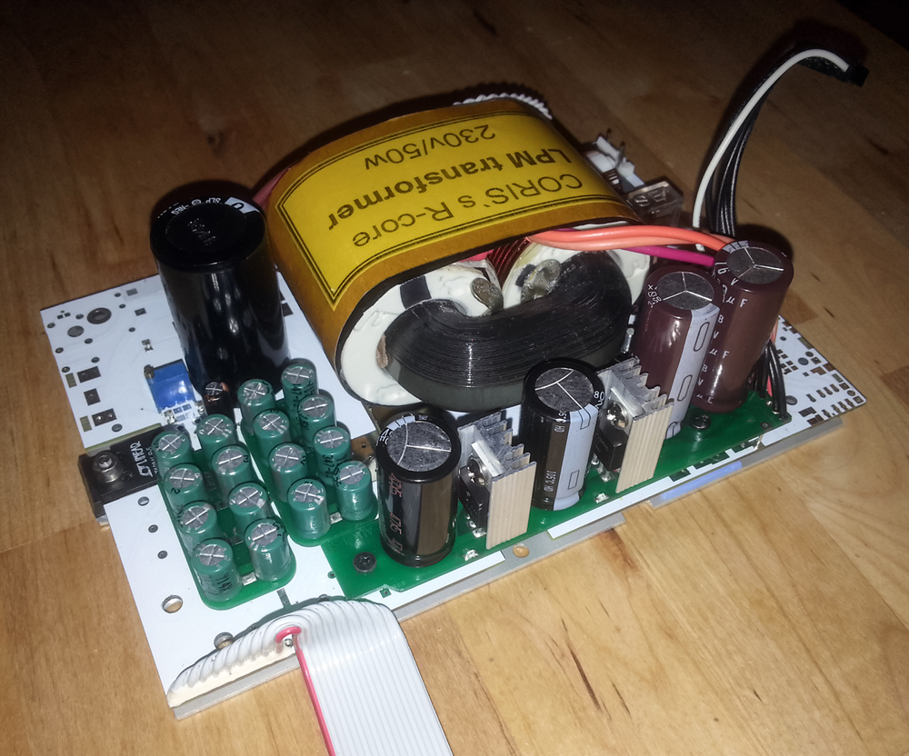

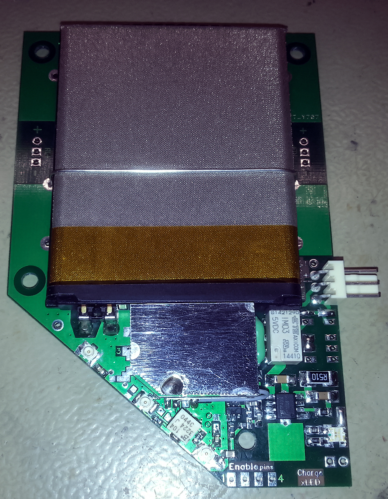

Hereby are my improvement solutions, which it (mechanically) fit also for new Oppo UDP models.
As I can see in the picture published by Jae Hong Lee, the clock section of the main processor it use a resonator. Most likely the 25Mhz clock for BD driver decoder it use a similar component (resonator).
It could be nice if Jae Hong Lee can publish a close up for this section too...

Again new LPM for OPPO BDP 203 .
The size is smaller ( 100* 155 mm) than that of oppo 103/105 .
OPPO 203 needs only 12V for main board and +/-15V for DAC board .
Do you know when your new 203 power supply will be available for purchase on your site?

The DAC section in 203 models is based on the cheap AKM 4458 DAC chip. Here is another architecture for DAC outputs, than it was/is for 105/105D models.
The issue do not apply for UDP 203 (BD 103, 103D, 101) models. Indeed, we can say so: the 203 model is an 4k upgrade of the former 103/103D models... The next coming Oppo UDP 205 model it will be an 4k upgrade for video and a DAC upgrade (new ESS90128/38Pro chip) for sound, of the former 105/105D models...
