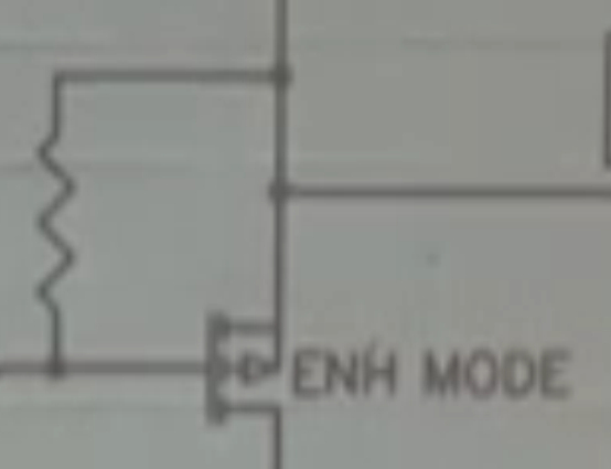

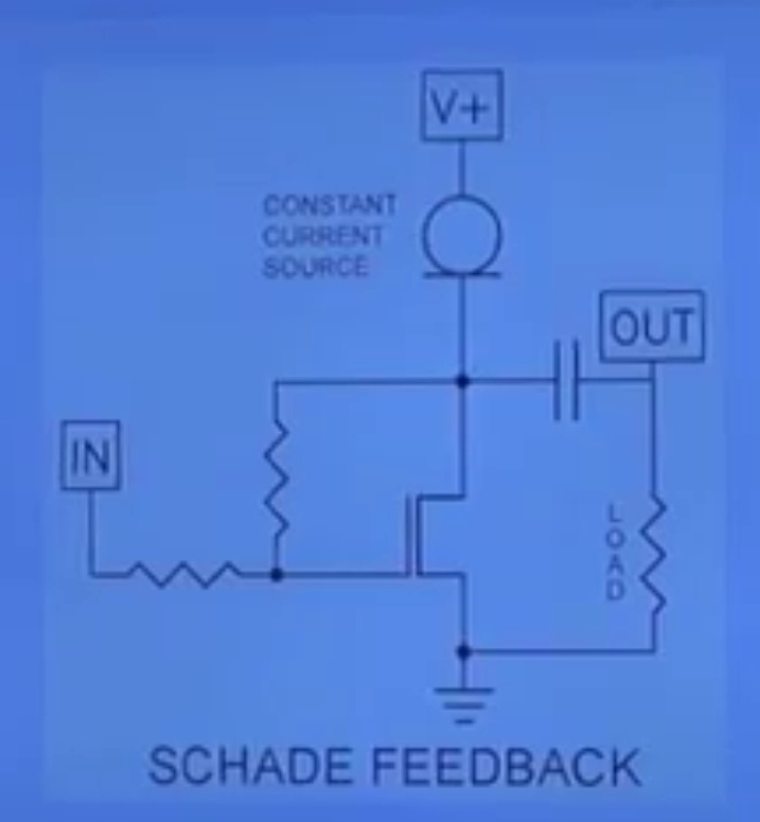

Very interesting, though it will be a challenge to find enhancement P-channels whose Vgs matches that of available depletion parts... The IXYS parts all hang around -2V for reasonable bias (<2A), so maybe the 2SJ201 could work. The USCi and Infineon JFETs all require very negative (<-7V) bias, though. Perhaps, once again, the Semisouth part is just special...
@ Mr Pass
In follower V2 resitors help selfbiasing for unmatched part's
do they resistors other function in the same time ?
Example schade feedback on enhancement IRFP240 for triode like character ?

@ Mr Pass
Hello soundhappy. You made an interesting point. A follower using an N device which has a pentode-like characterisic [R085], and P- device which has a triode like characteristic; be it a Schaded FET or a SIT; say 2SJ28. What will the resultant subjective sound be due to mixing a pentode and a triode characteristics?
