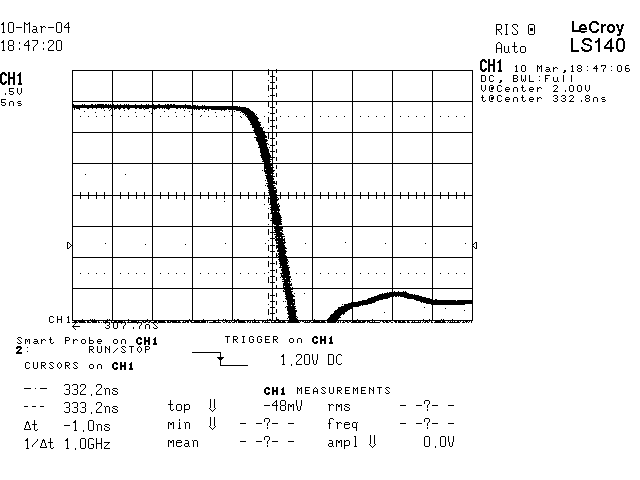

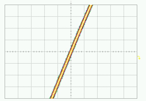

The Jitter of the measurement set up looped-thru (without Optical transmission loop), so Clock source (10MHz or 4MHz), Output 50 Ohm buffer, Trigger splitter and measurement set-up (Agilent DCA 86100A + HP 83484A 50GHz Scope) is 2.5pS RMS Jitter.
Below is the jitter of the complete set-up WITHOUT optical transmission loop.
50pS DIV, 2.5pS RMS Jitter

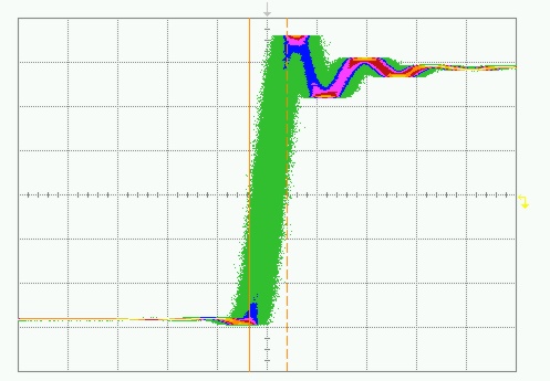

Complete SPDIF optical loop, using the Toshiba TX176 / RX176 devices, 4MHz Clock
Even though the results appear poor, it must be remembered that the Phase noise is HF and RANDOM in nature.
SPDIF receivers have good HF jitter attenuation, and Zero attenuation at LF, so it could be argued that the Ground & RF isolation offered by optical connection is worthwhile due to the reduction in LF Mains harmonic components. Random Jitter is always preferable to discrete components.
While Transformers might offer Good Ground isolation, they offer poor RF Isolation.
1nS DIV, Jitter = 750pS

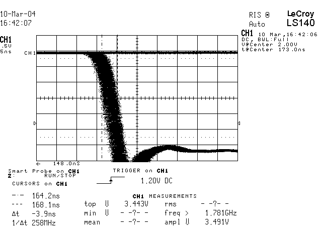

since I was also concerned about toslink jitter i made my own test setup. Results are for TORX173 receiver and Hercules Fortissimo II computer audio card (transmitter unknown). Clock is around 2.8MHz.
It is very interesting that pins 5and 6 (case) of the receiver must be grounded, otherwise jitter is terrible. I also tested Infineon SFH551V receiver, but the results are much worse.
Here are my results: 3.9ns peak to peak jitter accumulated over 10 min of measurement. I am interested what the results will be after DIR1703 receiver (75ps jitter claimed in datashet)

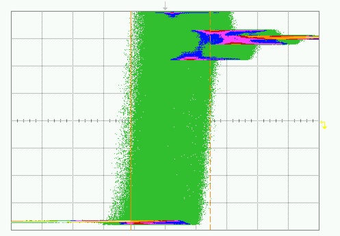

---------------------------------------------------------------------JohnW said:Complete SPDIF optical loop, using the Toshiba TX176 / RX176 devices, 10MHz Clock
1nS DIV, Jitter = 2578pS

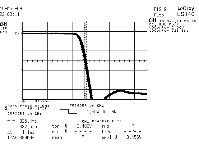

Posted below is measurement with identical setup as in previous post, but this time with 60m of fiber wound in bundle with 20cm diameter. My crude measurement shows increase of jitter from 1ns to 1.1ns., but this could be attributed to other factors (lower optical power in the receiver, different optical transition times of transmitter diode due to increased drive etc).
Your comments on microphonic properties of fiber are very interesting. This is something I have never heard before, but it seems logical. But I suspect that straightened fiber is less susceptible.
