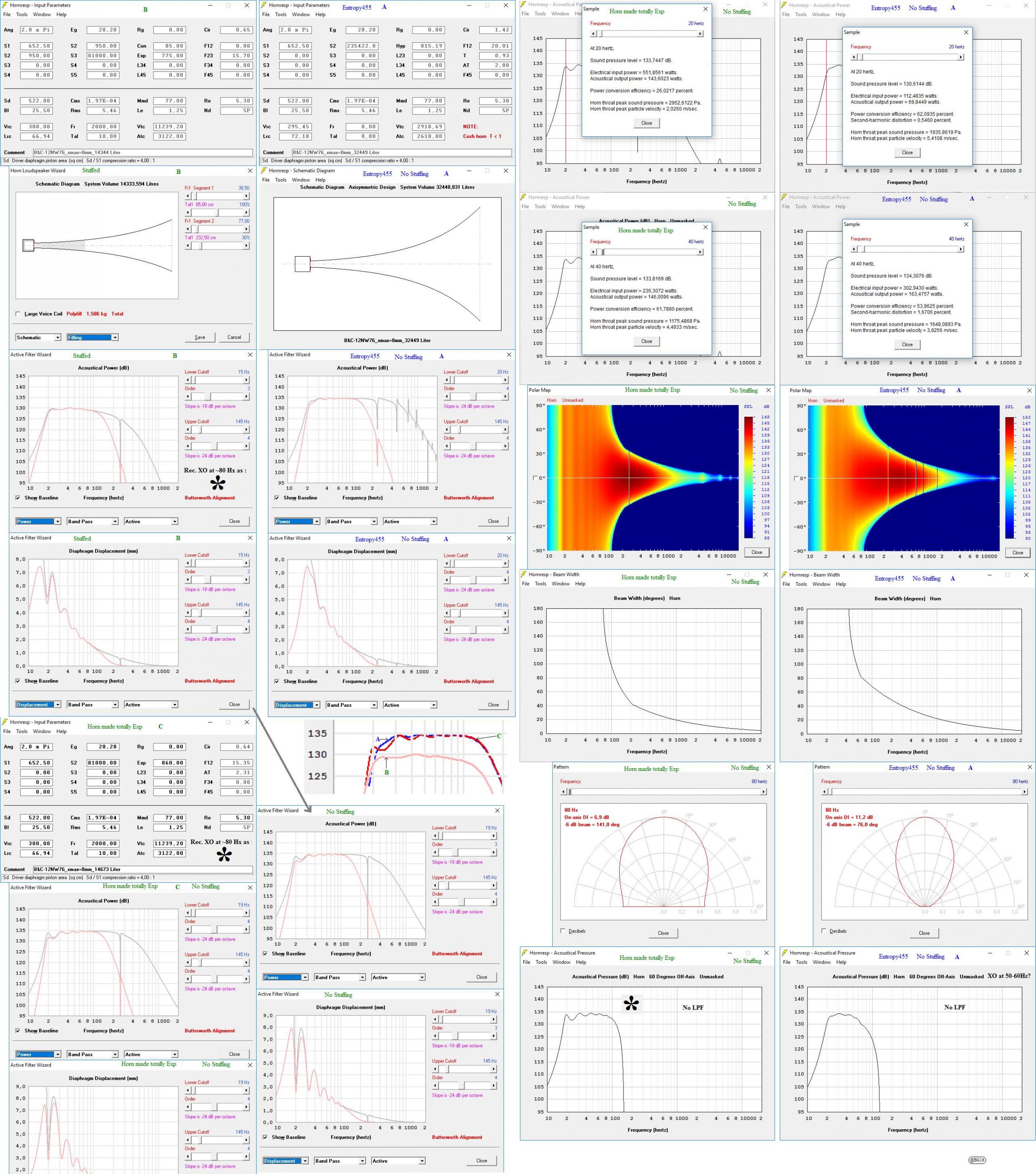

Using a single driver per horn (20 Hz & 160 Hz cutoff frequencies) Hornresp (see above) recommends a 33.5 foot long hyperbolic-exponential horn, with a mouth that’s roughly 16 feet x 16 feet (assuming square mouth). The flair parameter is 1.03, and the horn will supposedly crank out 125 dB down to 20 Hz, without exceeding the 8 mm Xmax. This is good – I can live with that.
But I was tinkering with adding additional drivers (the same B&C 12NW76) – for (qty 5 total) per horn (see above). My thought was a square chamber, with drivers on five of the six sides, all feeding the horn’s throat/chamber. In this configuration (with the same 20 Hz & 160 Hz cutoff frequencies), Hornresp recommends shortening the horn down to 26.7 ft, and increasing the throat area by a factor of five, while keeping the same mouth area - this makes perfect sense to me. What I don’t understand is why the recommended flair parameter changes from 1.03 to 0.93 by simply adding more of the same drivers? Nonetheless, increasing the drivers to (qty 5 total), will increase horn output to about 132 dB, without exceeding the 8 mm Xmax. I can live with that.
Conceptually, am I on the right track here? I've selected a driver with a low Qts, low MMS, and high BL - which is what the old design texts say to do. . . .
The horn throat area S1 automatically changes in the calculations because of the changed driver configuration. The calculated value of T is a function of throat area.

A single driver tapped horn of only 15.5 cubic feet will exceed the SPL of your design, though won't have much response below 32 Hz, generally not a concern unless you want to reproduce earthquakes, mortar blasts, or Osprey helicopter wash at original levels.
While the driver you chose obviously works you can forget about what the ancient texts say about low q, low mms, high bl drivers. That's just a first best guess at getting a decent driver to work in an ancient midrange horn.
If you want to know the truly best specs for your intended application, use Leach's math, specifically the System Design - From Specifications tool. That will design your horn and driver all at once in one fell swoop.
At that point the issue becomes finding a driver with the same specs that Leach's math suggests - in the case of the Labhorn, Tom Danley had to have one specially made by Eminence, hence the new Lab 12 driver specifically designed for the Labhorn.
That doesn't mean that you can't get fantastic results from wildly inappropriate drivers, but the point here is that the optimal driver specs for a low tuned bass horn very likely are not going to have low q, low mms or high bl.

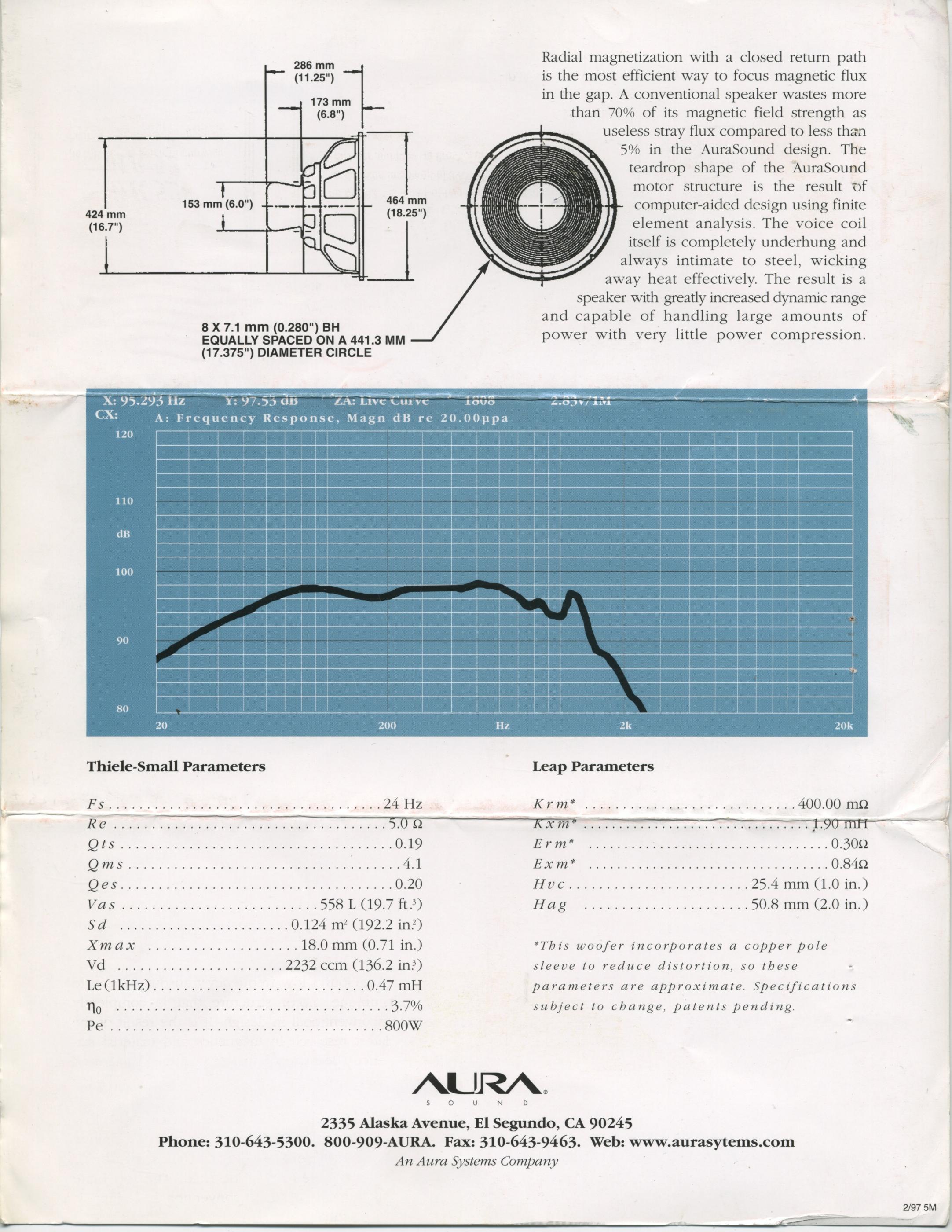

The "new" LAB 12 was designed around the turn of the century, I was late to the party and got my first units July of 2003, my first purchase of a horn driver with such a low FS and super stiff, heavy cone.
Prior to that, Tom Danley's servo-motor belt drive units had far more displacement potential than professional drivers, though by the mid 1990s they had been rendered obsolete by drivers such as AuraSound's 1808, the 1997 spec sheet copy below. Funny, (in retrospect) I was so caught up in driver "sensitivity" specifications back then that I paid little attention to their displacement- the AuraSound 1808 had considerably more than a pair of LAB 12", though the LAB 12 had more displacement per dollar.
I had mostly forgot about how advanced the 1808 was until 2015 when I started scanning old documents to eliminate hundreds of pounds of paper before moving cross country. Although the 1808 has great displacement capability, the mms is/was too low for low distortion in high compression ratio applications, something that does not show up in simulations, but can also result in ripped or kinked cones when pushed to Xmax.
Eminence has not made much advancement in LF horn drivers since the introduction of the LAB 12, but B&C and many smaller companies have, sold off my last (spare) LAB 12 last year.
I was contacted by PM several years ago on this forum by a man who wrote he had purchased the old Aura neo magnet structures, and was planning to re-issue drivers. I was unable to get a response back, and could find no web presence of his enterprise, a shame, as the 1808 magnet structure is still one of the best designs.
I remember when those came out. 18" drivers with huge Xmax and very low Qes. But yes, light cones.
Didn't someone try filling the cones with foam at one point in an attempt to stiffen them up for heavy duty use?
