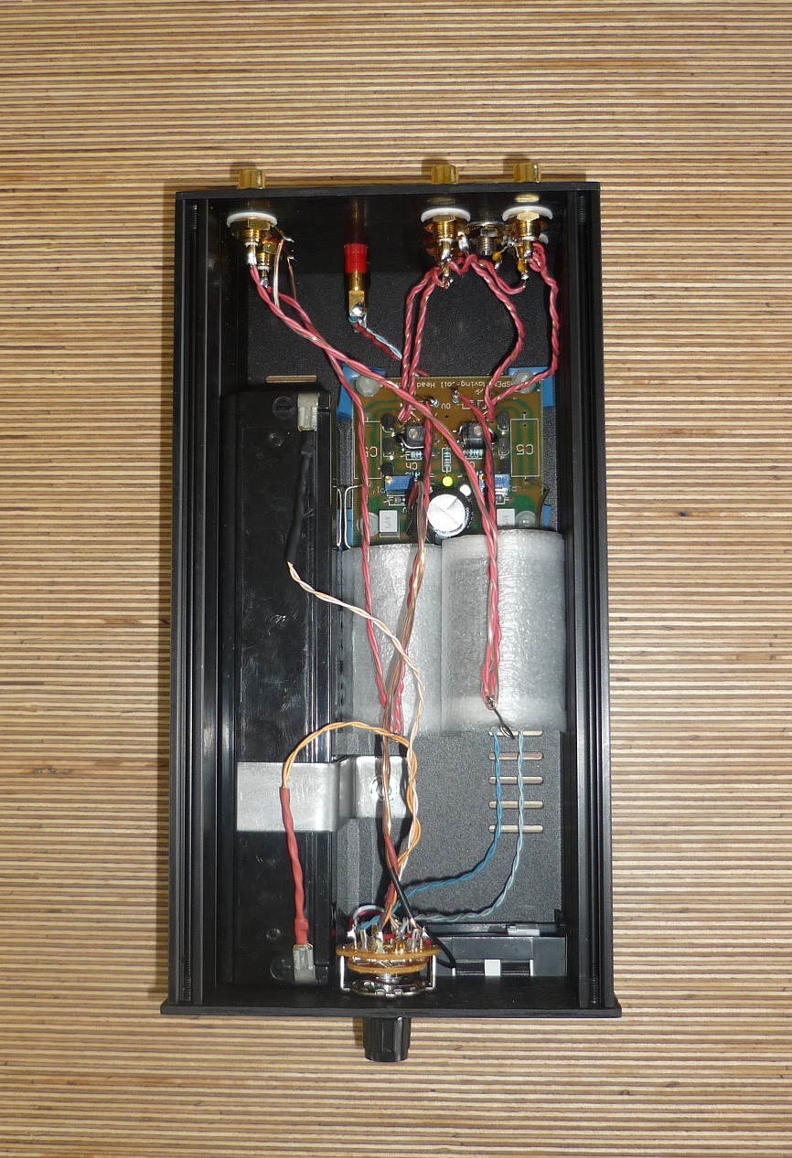

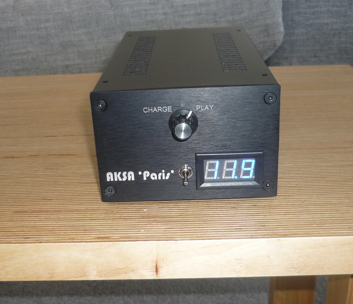

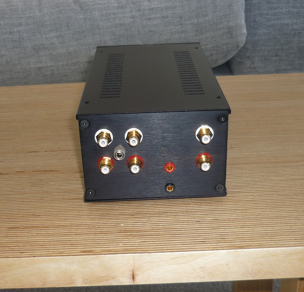

Well, I finished the build last weekend and took some pics, which I thought people might be interested in.
BTW, the output coupling caps that you can see in the 3rd pic are not wrapped up because I wanted to keep the brand secret - simply because these AmpOhms have a metal case, which I didn't want touching the case (or each other).
The 2nd pair of input RCAs on the L of the back of the case (pic #2) is for R-loaded' plugs, to get the optimal cart loading (the default load on the Paris PCB is 47K).
Andy
