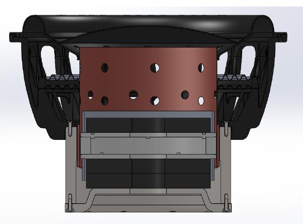

the Peerless STW is not actually a dual gap design,
it's a single gap with single VC winding,
however it is capable of 90+mm excursion Peak-to-Peak.
calculated Xmax is pretty much incomparable between brands, it seems everybody measures it differently,
the results vary wildly for a given design.
Peerless drivers use the most pessimistic (honest) value, and also give the gap geometry to let the user interpret true usability,
other manufacturers tend to use larger numbers which may or may not have any truth to them
the only real way to get an idea of excursion capability is to look at VC winding width and gap height,
anything else is at best an estimate/assumption.
the real advantage to this driver, is that it will allow a much much smaller cabinet for a given tuning.

That is calculated Xmax, and if you look closely, it's a dual-gap setup and really is likely closer to 40mm in usable operation. There is a note below the spec sheet that states this.

Now that I've seen another magnet geometry pic, I agree that it's a single gap. I went back and looked at my saved photo from a year ago. What isn't clear in that photo is the gap area without a physical picture. What is apparent is that there are 2 magnet structures flanking the long gap, and that is what threw me off. Before it looked like two gaps and a spacer ring, with a single coil. I never said it had 2 coils other than being a DVC architecture. The long coil was longer than what I saw as 'both gaps' before.
Again- agreed that it's just a really long gap and longer coil, and 2 tiered magnet structures flanking the gap.

The smaller top magnet in the motor is used to force more flux through the gap and top plate.
