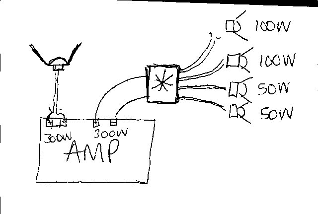

the amplifier is external, plugged into power and wired to the output of the head unit, im not sure what is meant by changing stuff on the head unit, but theres nothing to change on the head uni, the head unit is 50W per channel and is wored to four speakers already of around 50W.
what i want to do, is use one of the 300W (4ohm) output channels and connect it to something that i can make, like a unit with 4 channels... if u know what i mean, i want to convert that one 300W channel so that it distributes two 100W channels and 2 50W channels
what i wanted to know is if this is possible, my theory is, that all it is, is some kind of current, and u can always reduce it... but im not sure how it all works, i dont think i want to bridge anything (the sub is 300W RMS and corresponds exactly to the 1x 300W output channel on the external amplifier) or wire anything in serial unless there are proper electronic components supplying only the current the speaker needs to that speaker.
so basically, what im sayin is, without bridging and changing speakers which isnt what i want to do, i need to be able to seperate the currents to each speaker from one 300W output
using some kind of device that doesnt amplify current or reduce it
ive enclosed a diagram for u guys so its easier to understand what im talking about
thanks again :)

I don't know what your problem is, your question has already
been answered, given that you've not really explained very
well what it is that you want to do.
4 identical drivers wired in series parallel will each get 1/4
of the channels output i.e 75W each.
If you want to vary the power you need to exploit different
inpedance drivers or add some power resistors - always
being mindful of the the total load on the amplifier channel.
Two 4ohm drivers is series wired in parallel with two 8 ohm
drivers in series, the 4 ohm side will receive twice the power
of the 8 ohm side, but it won't split 200W/100W, you'll get
less power, 170W / 85W ?.
(depending on the amplifiers variation of output with loading)

the speakers are all 4ohms ... 2 of the speakers (6x9) have an RMS of 80W which is ok i think if theres 75W coming out of the amplifier to each speaker,
which components would i use to reduce the power from 75W to the other 2 speakers that can only handle 40W rms ?
is there a certain formula i can use that will give me the value of the resistor i need to install the same way u can work out speed=distance/time? thatd be really great

It really isn't just a simple question of matching amplifier
power to the drivers that are fitted, its far more involved.
You have misunderstood the amplifier specifications,
most can handle 2 ohms except when bridged when
most require > 4ohm load.
Theorectically you would add a 3.3R 10w to 15W power
resistor in series to the 2 4ohm 40w drivers wired in series,
this will bring them down to 37W each.
And wire the other two in series in parallel.
Giving a 4.7 ohm load.
But it still doesn't sound like a good idea to me.
:) sreten.

so the resistors are like fuses? .... would it be safe to assume that if any more current gets to it, the resistor will blow and break the circuit and in turn protecting the speaker its connected to? if not, how would i go about doing something like that?
i did misunderstand the instructions, its 4ohms bridged and up to 2ohms unbridged.
as the speakers are 4ohms im thinking of taking ur advice and asking the mr2 man to buy a fairly cheap four channel amplifier... there is a 4 channel 300W amp that gives 75W at 4ohms per channel.
wire in the 2 6x9's to two of the channels and then the two mid range speakers to the other two inputs using the theoretical method u proposed in ur previous post using resistors...
would this be a better idea?
could i wire a 3.3R 15W power resistor to each of the other 2 outputs individually to control the power going to the 40W speakers from each of the other 2 channels
and how do i work out what specification power resistor to use, is it possible to work it out in ratios? or is it more complex than that?
i was thinkin if i took this example
3.3R 15W resistor = reduces 75W output power to 37.5W
would...
3.3R 30W resistor = reduces 75W output power to 18.75W?
is it safe to assume that a resistor at 15W will resist 15W of power? if this is the case could i wire 35W 3.3R resistor and achieve a 40W power supply to the 2 40W speakers? or is it worked out some other way?
