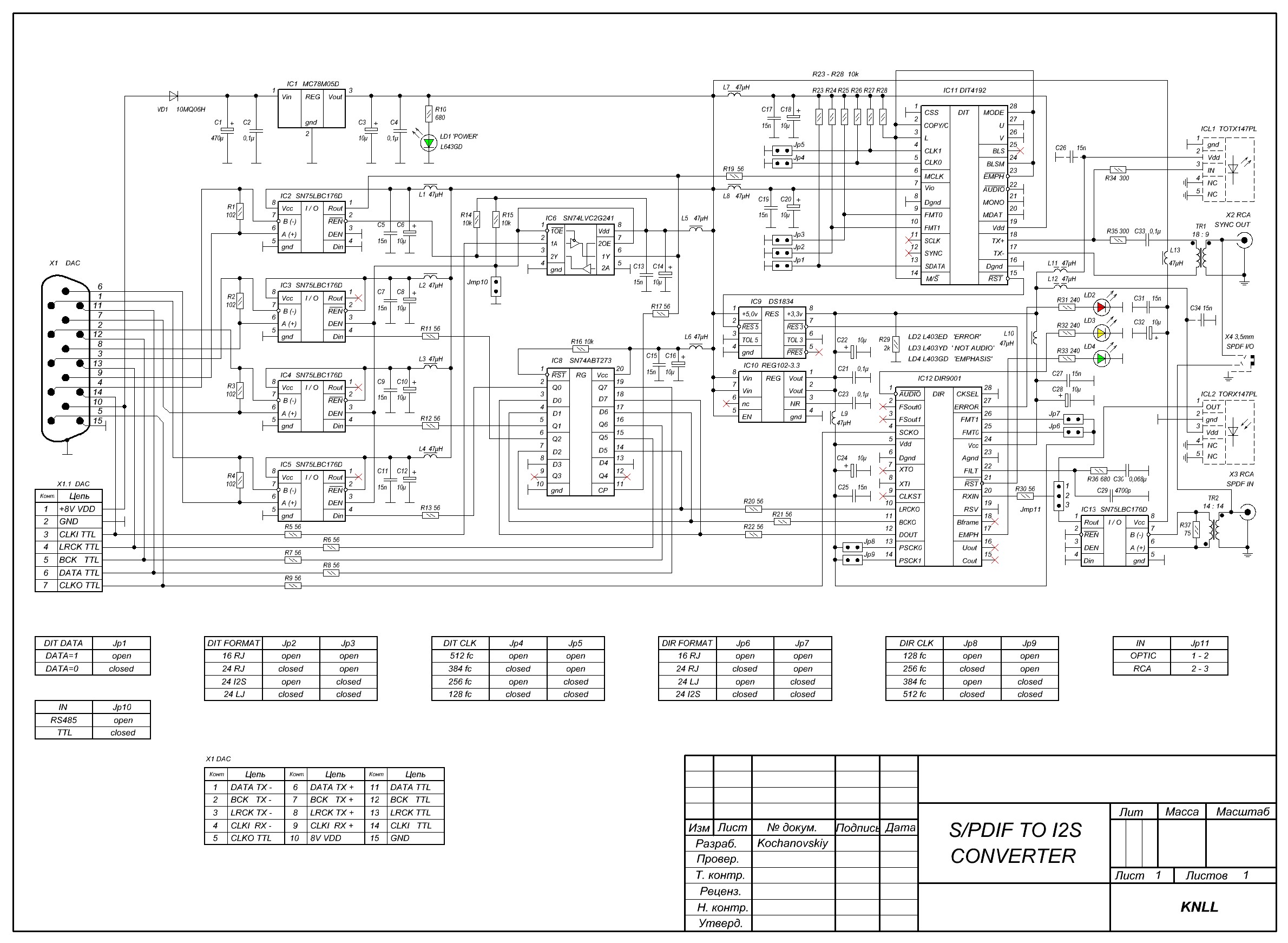

I have been testing an idea of synchronous reclocking whereby a computer sound card is slaved to masterclock in the DAC on PCM-63. I am using an SPDIF to I2S converter to take SPDIF out from a sound card. The receiver DIR9001 in the converter takes SPDIF via SPDIF transformer (galvanic isolation) and breaks it into 3 I2S signals. Masterclock present in this SPDIF is not used at all. At the same time the DAC’s masterclock is transmitted to SPDIF IN in the sound card via converter as SPDIF signal.
The DAC has only I2S connection with the converter and then 3 I2S signals are processed through a digital filter SM5842 and sent to the reclocking trigger whereby all 3 signals are reclocked and sent to PCM-63.
Please note that PCM-63 does not use masterclock. It only uses data, LRCK and bitclock which are reclocked by the trigger synchronised by masterclock in the DAC.
The theory states that in this case computer sound should be of the same quality as that of a CD transport.

The closed clock loop synchronization approach you use does indeed have the potential to deliver minimum jitter at the DAC - if properly implemented.
One potential problem is that the reclocking signal at the DAC may need to be phase inverted relative to the 3 received I2S signals. In other words, should the reclocking instant be triggered when the I2S signals are changing it could increase rather than decrease jitter. You can verify proper reclock phasing with an oscilloscope.
Another potential problem is common-mode (ground loop) noise coupling, especially between the converter unit and the DAC unit. Supply contamination by common-mode noise can induce jitter. You mention an S/PDIF input transformer which protects that interface from power line frequency related common-mode noise. However, I suspect that the I2S interface netween the converter and DAC lack such protection. Which may be whey you find the sound to be superior without the converter, even with a synchronous closed clock loop employed. Common-mode noise protection for the I2S interface would require 3 seperate transformers at the DAC, or a balanced high CMRR I2S interface - which your converter and DAC may possibly already feature.
You really gain nothing by converting S/PDIF to I2S when utilizing a synchronous closed clock loop scheme. I suggest maintaining the closed clock loop scheme (with reclocking at the DAC) but utilize a single S/PDIF link directly connecting transport to DAC via the existing transformer coupled signal input (no I2S converter unit at all). That should provide both low clock jitter at the DAC and minimize ground loop noise induced jitter.
I know about this problem but please note the following. Again in both instances (when comparing the sound of a CD transport and PC transport via DAC) the signal goes through the converter. In both instances the signal goes as follows:
1. CD transport SPDIF OUT – SPDIF IN of the converter – SPDIF transformer in the converter – DIR9001 – 3 I2S signals to the DAC via I2S
2. PC transport: SPDIF OUT of a sound card - – SPDIF IN of the converter – SPDIF transformer in the converter – DIR9001 – 3 I2S signals to the DAC via I2S

Only if both are likewise slaved to the DAC's masterclock. Actually, if the disc transport is not slaved the reclcoking will run asynchronously with rspect to the I2S signals, producing greater jitter than without any such reclocking. Some pepople have reported a subjective preference for this sort of asynchronous reclocking.

If you know about common-mode noise coupling then you should recognize that your system setup is still susceptible to it. A clue is your report of the sound being better when utilizing balanced I2S between converter and DAC. Keep in mind that there are three major ground loop paths in your system, one between transport and converter, another between converter and DAC, and one between transport and DAC (passing through the converter).
While transformer coupled interfaces are very effective at rejecting lower frequency common-mode noise, they typically exhibit degrading CMRR as noise freqency rises - due to parasitic capacitance between the windings. PC switch-mode power supplies are notorious for injecting high frequency common-mode noise.

Okay, I think most all is clear now. You are attempting to compare apples to oranges and yet are wondering why they would taste different. Because you subjectively prefer the sound of asynchronous reclocking doesn't mean that preference is due to it mysteriously exhibiting objectively lower jitter somehow. The reverse is most certainly the case. You have to keep in mind that the spectrum of the jitter makes a difference, just as it does for amplifier harmonic distortion. As I said before, some people prefer the sound of the jitter spectrum produced by asynchronous reclocking, despite it's objectively greater jitter magnitude. It simply becomes a matter of human perception.
Also somewhere in the back of my mind I was thinking that jitter of a CD transport is not like internal jitter in syncronous reclocking systems and many people subjectively might like it more. That's why we came here. But again why on earth the sound signature of CD transport could get through the reclocking circut in the DAC?
Do you want to say that when we connected CD transport to the DAC without slaving it to the clock in the DAC then this type of connection turns out to be asynchronous reclocking? I was of an opinion that asynchronous reclocking is a slightly different thing.
Yes, that's what I'm saying. As long as the reclocking signal is derived from a free running masterclock at the DAC, and not from the recieved master clock embedded in the source signal.

That's just it, asynchronous reclocking does not block jitter contained in the source signal. Only synchronous reclocking does that. Source jitter will be complexly mixed with jitter produced by the asynchronous reclocking process.

Anyway, looking at the schematic, we have I2S coming out of DIR9001, then it is "reclocked" by a flop using the local clock. Even if the source is slaved to this local clock, the phase relationship between the local clock and the DIR9001 clock is unknown, because it depends on the delay in the whole transmission chain (SPDIF transmitter, soundcard, then receiver). It may vary depending on your hardware, soundcard configuration, cable length, temperature, etc. The whole SPDIF chain will add its jitter, of course. Anything that changes the roundtrip delay will change the phase.
Therefore signal edges can come at any time relative to the local clock. If you're very lucky, your "synchronous reclocking" might work. Otherwise, the clock edges will be too close to the I2S edges and the flop timings will be violated, resulting in large amounts of semi-random jitter. Add a bit of timing uncertainty, and you can also get bit errors with this circuit.
The result is random. This is simply not how you cross synchronized but phase unrelated clock domains. A FIFO should be used to do things cleanly.
