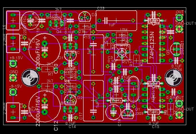

The layout seems pretty OK to me but two things:
1 those 1 uF, why don't choose small 1 uF/63 V polyester? Maybe you chould go for 10-100 nF + 10 uF?
2 The 74HC IC hasn't got a decoupling cap close to pin Vcc.
Maybe you should consider SMD because this is better in almost all resepcts and it's not particulary hard to solder. Go for 0805 parts and SOT23 transistors.
Lyra said:This is my PCB-design as for now.
There might be some faults here and there. Keep in mind that this is my first layout using Eagle.....
BTW: the size of the board is aprox. 50x80 mm.
If there are something that look's not OK, please shout out
Lyra

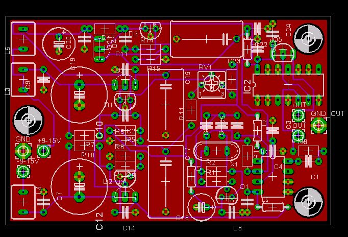

Hi Lyra
one remarks, as my response is limitted as I do not have the schematic at hand
You place the ferrite bead closer to the chips than the decoupling caps. I'd suggest to swop these, the cap should realy be close to the chips
succes
When it comes to traces, always make them as short as possible, cut the corners also. Avoid 90 deg angles. Still I think you really should test SMD because smallness is very positive when it comes to digital circuits and oscillators. Not everything have to be SMD but resistors, < 100nF caps, transistors (regulators), IC's. The crystal can be holemounted.
Mask the groundplane in the skrew holes so the screw and/or the distance not make contact with the groundplane.
Look at the picture below.
