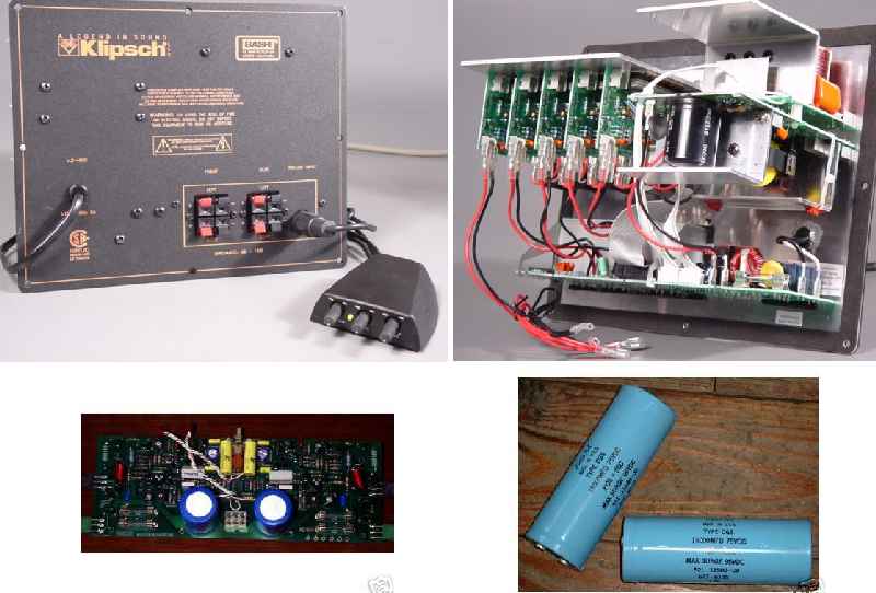

I have bought some stuff that I thought would be good to start with -
#1 - 5 channel amp from a Klipsch computer audio system 80 watts per channel.
#2 - New old stock Hafler factory-assembled dual 60W MOSFET audio amplifier circuit on a single circuit board. This same basic board (with very minor changes) was used in famous "Hafler" model: DH120, Pro1200 and G150 amplifiers.
#3 - Computer Grade FILTER CAPACITORS -- 15,000 UF (MFD) 75V.
(I wanted to combine #1 & #2 into a 5.1 HT amplifier)
But because I really don't have a grasp on the basics and dont want to wast the money that I spent on these, I can't start!?!?

New question. What types of begining tools should I staet collecting (soldering iron, multi meter, hand tools)????
Thats what you should start to collect. + computer with soundcard for measurements, if you can find someday a oscilloscope, and some m^2 shelfspace with electronic parts - resistors, transistors, caps etc. And read everything on www.passdiy.com And build some of the pass amps for educational purposes.
http://www.passdiy.com/projects/zenlite2.htm
Teeny iron for ICs and probably a 1/8" tip on a 35W-45W heater for power terminal strips and fuseholders. Don't fool with $10 irons, but don't spend $100 to start. I still do almost all my work with several $35 irons. (In part because my aging eyes can't see parts small enough to justify getting a teensy iron.) Name-brand rosin-core solder in 0.032" size.
Standard $2 pliers for big nuts. Several $3 screwdrivers in different sizes. Be fussy about your phillips screwdrivers: most are the wrong shape. Needle-nose pliers or forcepts. Actually sticking electronics parts together is not that tool-intensive. You will want nut-drivers etc when working on polished panels, but leave that expense for later when you decide you "need" them and your wallet agrees.
Drills, saw, hammers for modifying or making cases. This is where you need BIG tooling.
Meters: I have everything from a pre-WWII Boonton AC millivoltmeter to an LCD "scope" (and a real scope too). I do 99% of basic checking and check-out on the equivalent of a $20 digi-meter (it was $80 when I got it, and I thought it was a bargain then). The main "flaw" of these $20 meters is the AC Volts frequency response: often limited to "power frequencies" 50Hz-400Hz and drooping badly far before 20KHz. Oh, and the Resistance function is sometimes very upset by high-inductance transformers (sampled auto-ranging never settles). I keep a genuine Vacuum Tube Volt Meter around for purely-analog measurements.
Get a decent signal generator! IMHO, you can't do decent checking with CDs and sound cards. They have a place, but when you get funny results it is often hard to know why. While I have 3 or 4 low-distortion oscillators, my favorite first-check source is a Function Generator (Global 2001). Sure the Sine is ugly. But it is stable, settles quickly, has wide range, a choice of waveforms, and is compact.
Scopes are expensive and I don't trust the affordable digital LCD scope as far as I can throw the Tektronic. But I do think you want a scope. A 5-inch 5MHz is plenty. Dual-channel is a real plus. Used Heathkits and Leaders of this class sell for $100.
