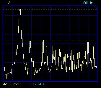

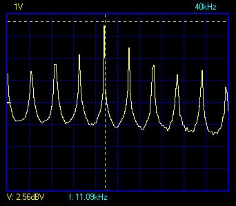

nice reading stuff, nice theory. But imo what counts is how it sounds. I have built few versions with ASRC the last 4 years and these are my 2 key findings:
1. If you do asynch resampling and then apply a digital filter (like 8420 followed by SM5842 or DF1704 for example) you can do almost any rate you want, totally asynchroneous, I have used 46.875kHz, 70,31kHz and 93.75kHz The clocks driving this was also clocking the DAC. All with relatively the same result: more air round instruments, better soundstage pin point. I liked best the last one, but they were all close....
2. I tried this as well with the Non Oversampling dddac1543 and it did not work well !!! Indeed you get the extra air etc, but tremendous amount of IM distortion, brrrrr with female voice you could actually HEAR the extra tones . Then I moved to the Tent XO Clock with 11.2896 MhZ, so in fact this is stays a sample rate conversion, but very very close to the original rate. And yes, I had again exactly the same benefits as described in #1.
The sound improvement is very easy to hear also in blind test (you need only a A-B switch, so indeed very easy, no cable plugging etc)
The practice is already here, so interested to read your theorie now. Still wondering what conclusions you will be drawing and if there is a hand-on part as well. I gues you have been doing some workshopping as well and not only been number crunching ??
doede
ps: as one example (I have some more test pictures) I attach a sinus of 1kHz, ARS-ed with a 47kHz clock in a non oversampling DAC.... clearly this will not sound pretty...
