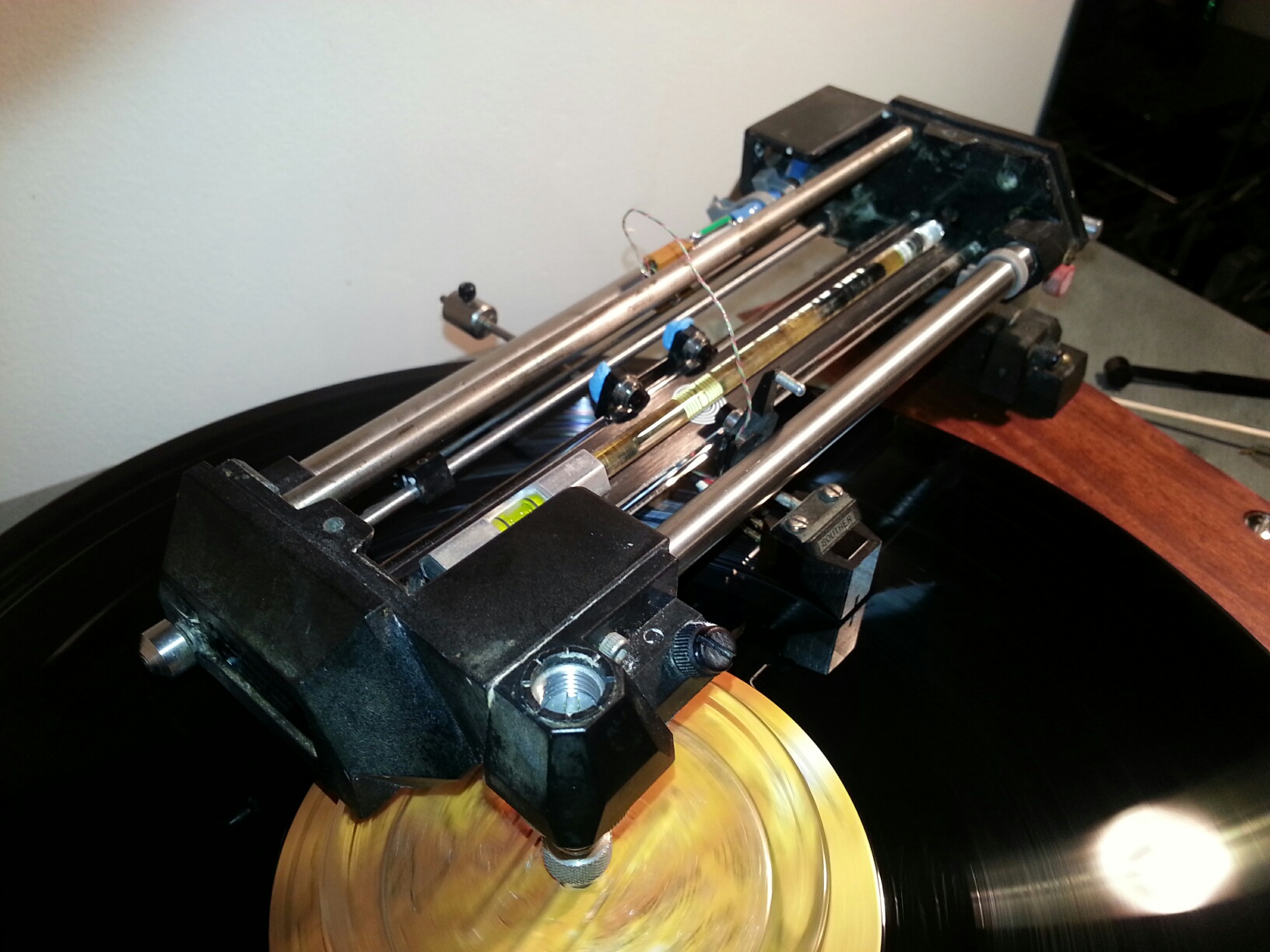

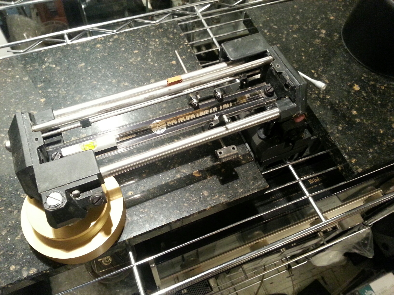

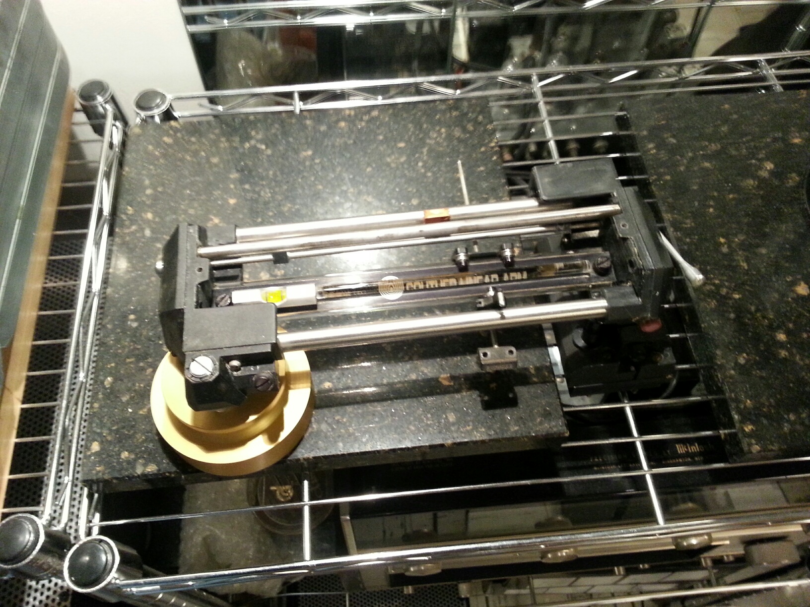

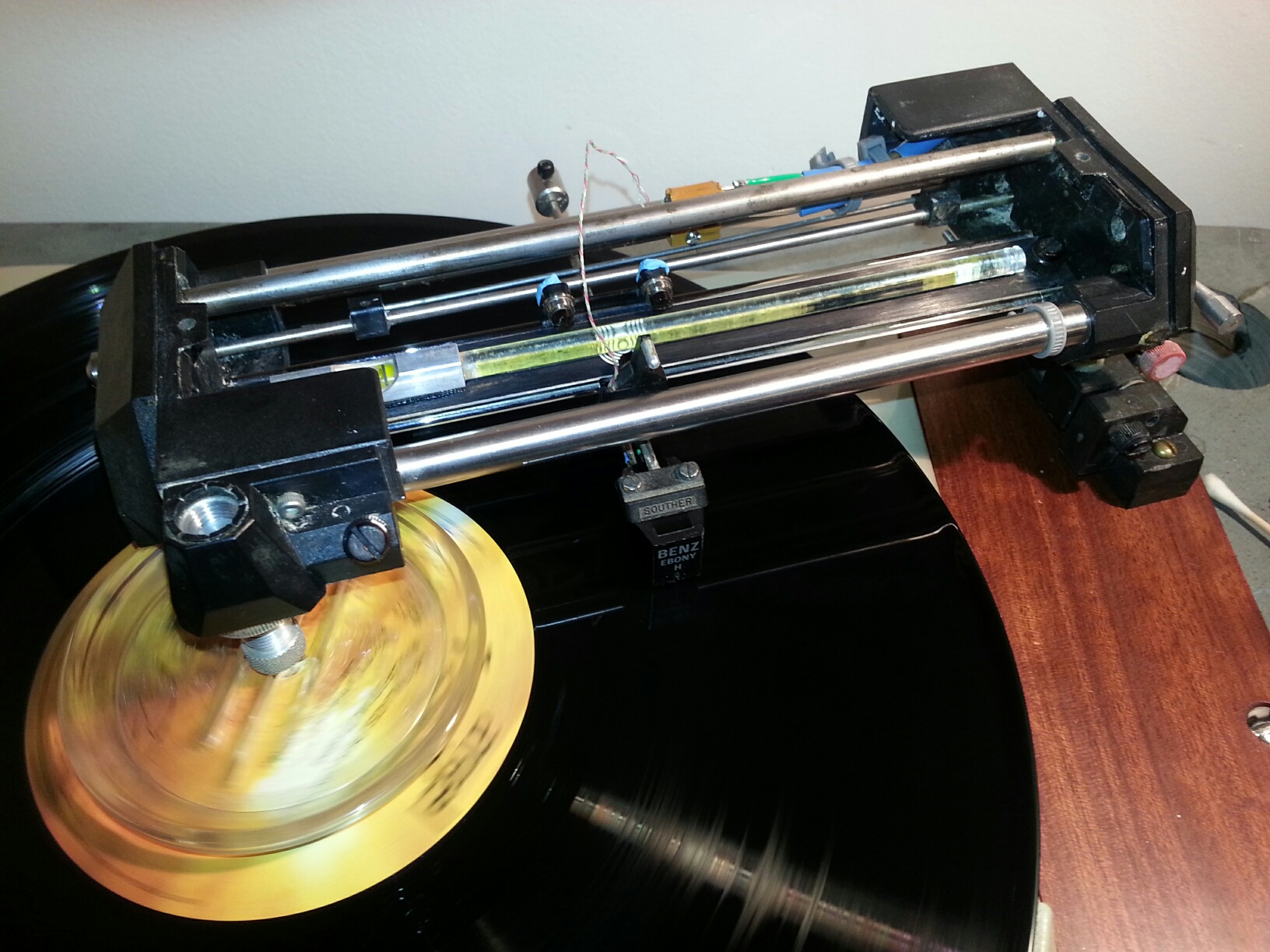

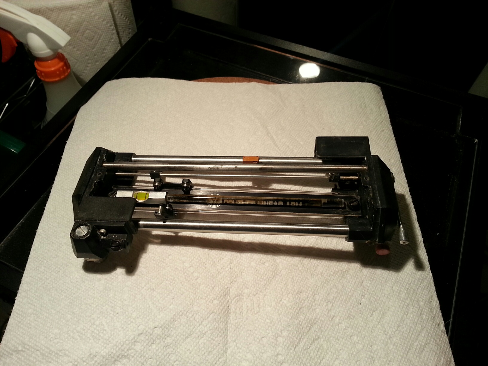

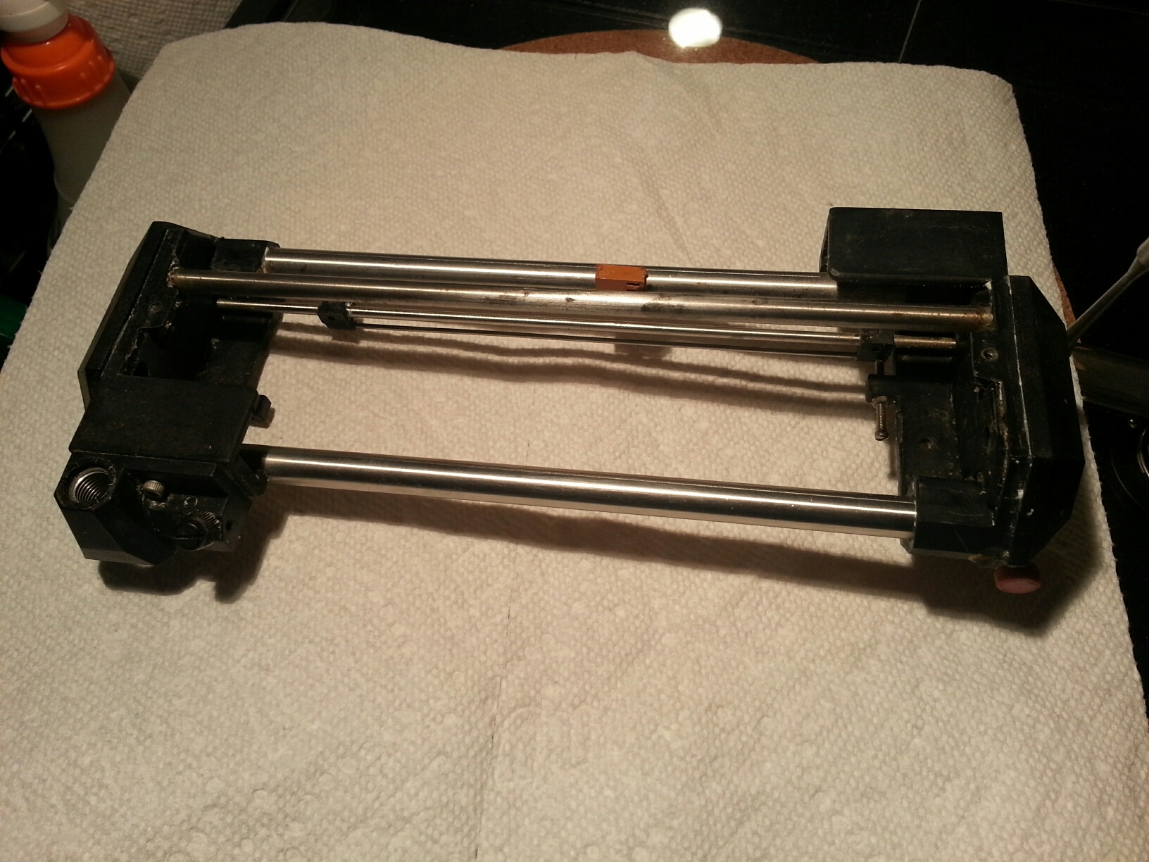

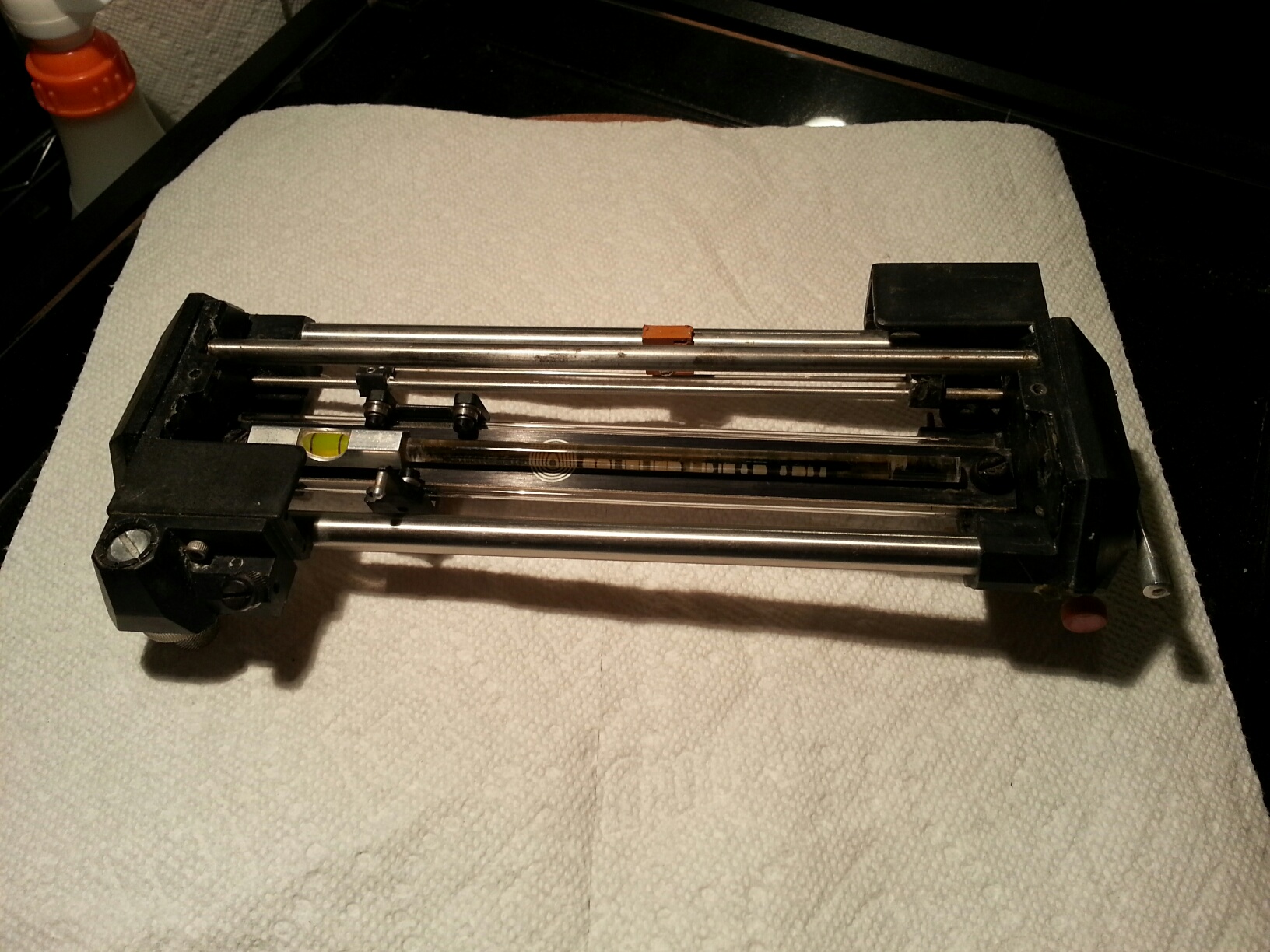

A friend of mine recently gave me his old and disused early Souther Tri-Quartz linear tracking tone arm.
I spent a few hours cleaning and detailing it. This one was built in Canton, Ma. and has a number of modifications recommended by Lou Souther. It does not have the plastic cover - I will need to get something to protect the bearings and quartz guide rods from dust.

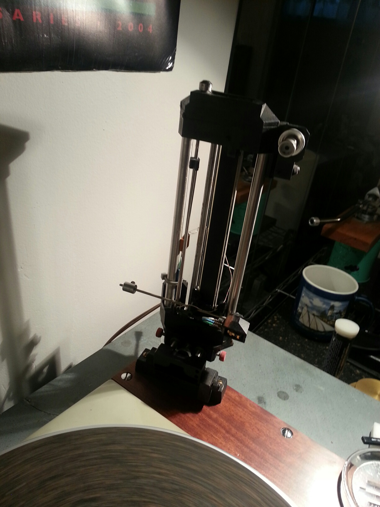

I improvised a tone arm interconnect until I can get something better. The strainrelief interferes with the arm lift and caused an offset in the lifting rod from one end to the other which I will only fix when the new cable gets here.. It works so..
I have a bunch of mounting accessories but because of the arm board height I had to go with the bare bones installation.

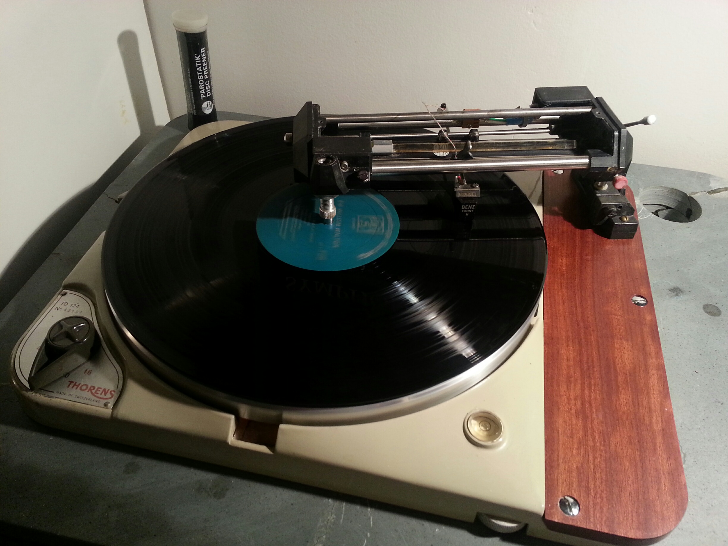

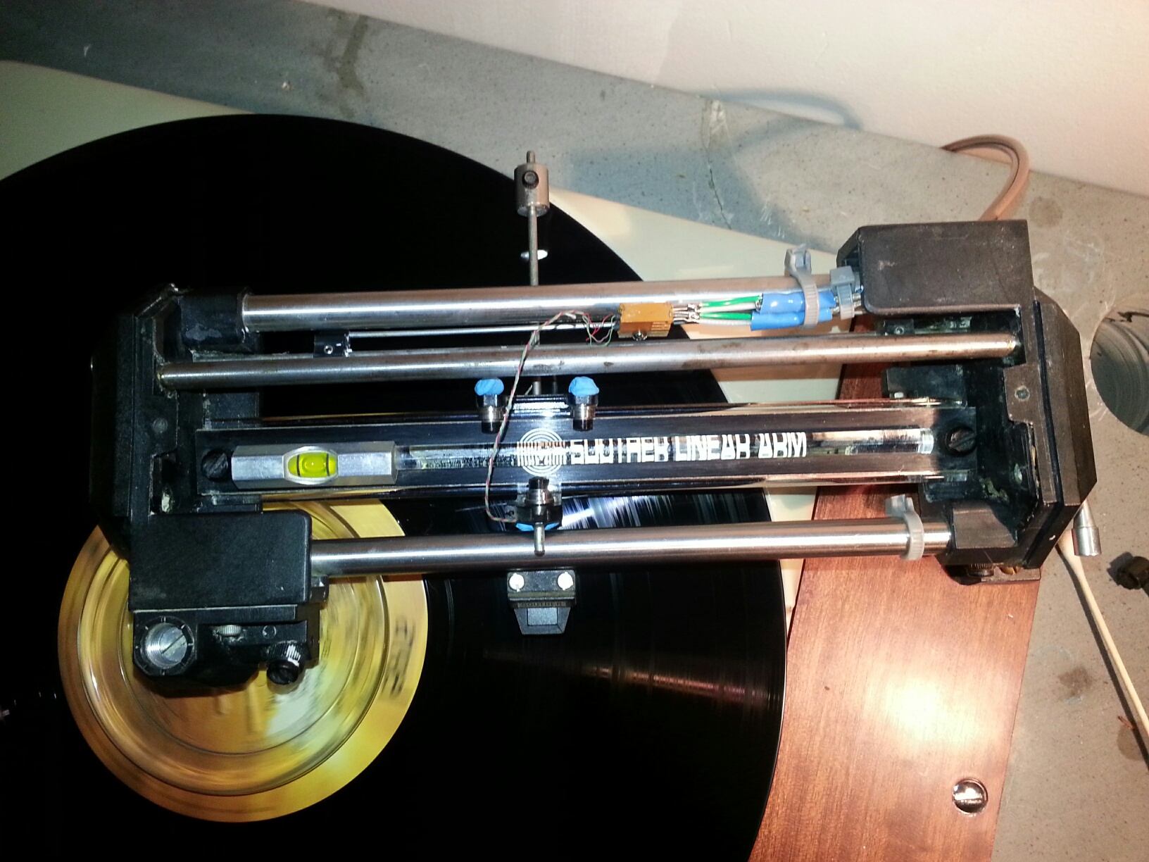

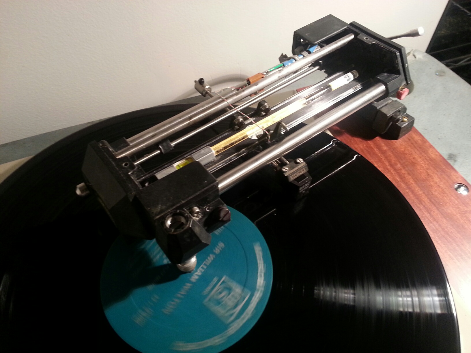

I've installed a disused Benz Ebony H HOMC cartridge on the arm, and have to say it seems to be a very good match to this arm. This cartridge has never sounded terribly involving to me, but on this arm it seems to shine.
I stuck the arm on my TD-124 MKI which is largely restored and will be its permanent home going forward. The combination actually works quite well, finding the space to install this arm is not complicated but there is no room for all of the accessories either. I installed the arm so that it clears the 124 mounting hardware and castings. It's a rather unfussy process to mount the arm, setting it up is another matter, but I did it successfully on the first try.
I'd love to hear from others with Souther LTAs regardless of the TT they stuck it on.

Day 2 and it definitely gets to stay. Surprised to say this combination works really well and I suspect in direct comparision to the Schick/SPU A95 would give it a good run for the money. I am not sure of the outcome either. I've been listening for over 12hrs now, which is a record for this table and electronics combination. (Muscovite Mini III treated elsewhere on this part of the forum) My opinion of this set up has increased significantly. I'm a bit surprised.
Strange as it sounds this is actually a pretty good route to follow from my admittedly limited experience.

A little more tweaking last night seems to have solved the skipping problem. I've not had any skips at all. Carriage movement is smooth and imperceptible except during lead in/lead outs. I reduced the tracking force a little with no issues.
I have a second one on the way for the other 124 and working on cartridge choice, keeps pointing to an Ortofon Cadenza.
The Benz works far better on this arm than it has on anything else and actually shines - enough so that I immediately developed a strong liking for the arm. It was over in minutes. LOL

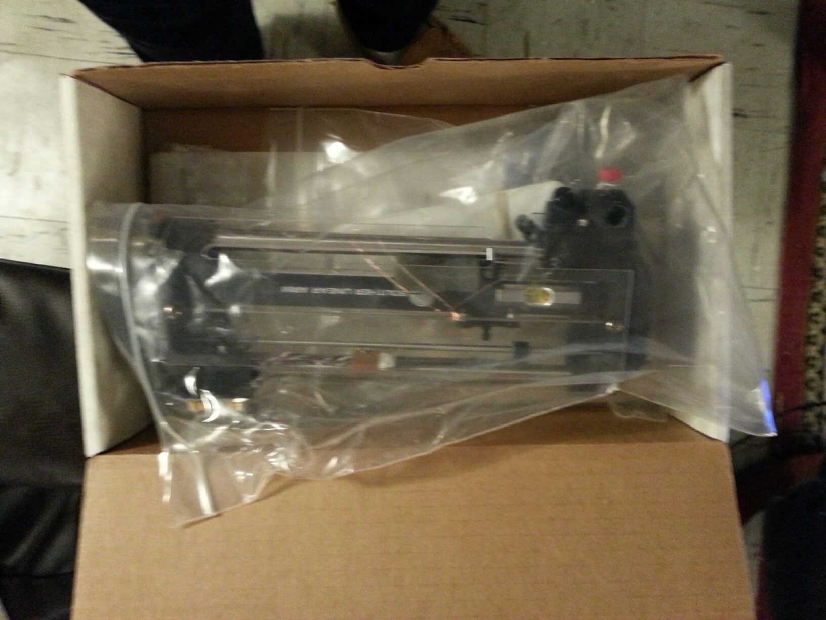

New addition to the family
The NIB SLA-3 I purchased on eBay arrived today, days early. The extended armboard for the other TD-124 is on order and should be here in a couple of weeks hopefully.
I need to give some thought to the cartridge I will run on this arm.

As far as I am aware all SLA-3 and indeed the Tri-Quartz all came with a clear plastic cover right from Souther. Many people remove them because the tonearm wiring hits the cover and causes mis-tracking.
My Tri-Quartz was a gift from its original owner and he related many problems with the plastic cover and its ultimate demise.
My NIB SLA-3 is complete as the factory packed it, and clearly was never used. Came with one of the optional arm wands that is made of bronze and has an extended cartridge mounting plate. I'll photograph and post it one of these days.

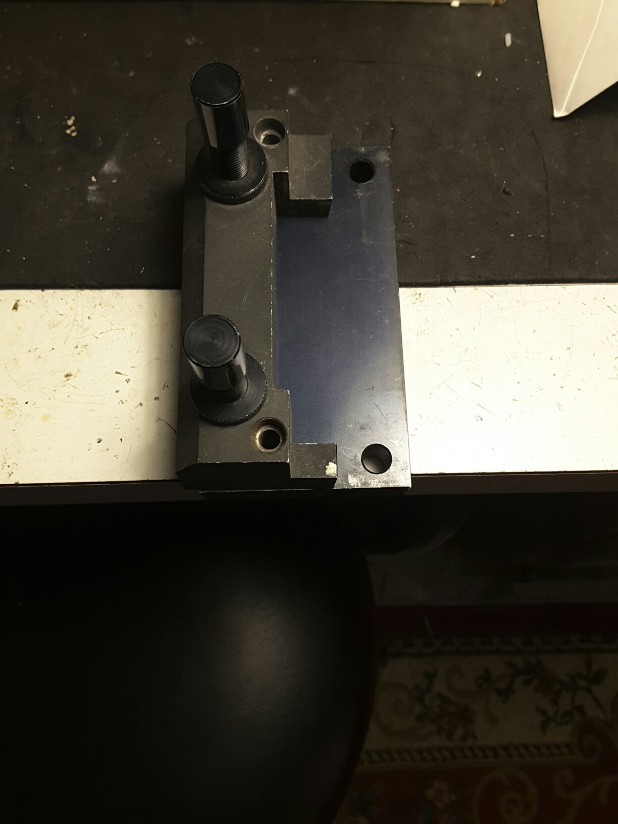

Clear Audio produced a support that gets installed with the base that allows you to support that end of the arm and disable the spindle support. I did not have the space to install it with the current set up. I will install on the other table with the new arm board. There is a support block that goes with the whole thing, but it is too thick to use on a TD-124 so I will have a friend make me one.
All of that said I have not been able to determine that there is any problem noise wise with the spindle support on the Tri-Quartz. I will note that it is quite a bit different from that on the SLA-3. Note that the Tri-Quartz is not an SLA-3 and the third quartz rod is one of several things that set it apart from the SLA-3.

An entire afternoon of playing records without a single skip, anyone who owns one of these arms might recognize that as a significant landmark.
Arm looks pretty rough still, some work required to fix it up, but it does sound really good. I guess I've never heard an arm as free of resonances.. I am rediscovering old and very familiar vinyl; what? I never heard that before moments are frequent, and not expected.
There is some bearing noise at the lead out, not sure whether further cleaning will address that issue or not, but given the age of the arm I think I will start looking for a replacement set of bearings.

Still no skips, so this seems a resolved issue. As I have become more familiar with the arm it does appear that the mechanical noise floor of this design is significantly higher than a good pivot if for no other reason the carriage bearings are in very close proximity to the cartridge.
In the case of record eccentricities I can very occasionally hear noise that is clearly from the bearings on silent passages. On the lead out where velocities are high it is pronounced.
I am going to look for replacement bearings and have contacted Clear Audio's U.S. distributor about replacement bearings amongst other things. (Should that not work out there are a number of flanged bearings available, one of them ought to work.)
I have applied three small blobs of blu-tack on the carriage behind the bearings and this seems to help a little wrt to bearing noise, more interestingly the noise floor dropped audibly on the lead in and between cuts. Also in audiophile speak there seems to be somewhat more "air" and a quieter background. Note this could all be placebo effect, uncontrolled experiment, yada, yada, yada. Very subjective, and because these are the sorts of improvements I would expect to hear, I might just be hearing them whether or not they are in fact real.
Regardless I am still pretty impressed that a freebie arm and cartridge on the clunkier of my two TD-124s is able to acquit itself well in direct comparison to the Schick. Sighted or not, this isn't what I would have expected. It's clearly a very good if quirky arm in the right hands and with the right cartridge, all installed on the right table.
There are obvious trade offs, I think to some extent you trade distortion for more background noise with this design; that's my impression after considerable listening.
All things considered it's pretty brilliant, and improvement is possible. I see a lot of experimenting down the road..
