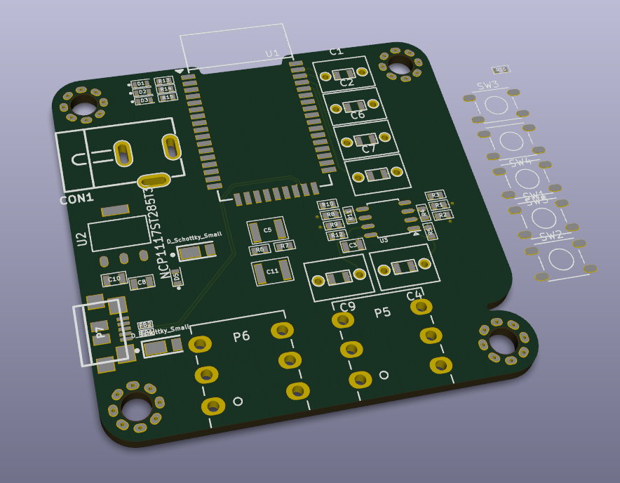

Actually arranging parts..
attachment.php
To me there are actually no (cheap) sources for CSR8675 boards available, so I'll stick with the CSR8645.
Most/All additional features from the 8675 aren't needed in a boombox setup and would need further programming.(6 microphones, 120mips DSP)
I want to keep it simple.
I'll look into power supply isolation and I2S. Dunno if I2S is available on the PCM header.
So i talked to my colleagues, psu isolation isn't an easy problem solver here, as the audio is still (for SE) ground referenced and this might/will break the concept.
Possible solution would be step-up + 2-stage regulator design to rise PSRR and seperate bt-current from the rest of the system.
Beside this, I2S is available on the PCM header, need to check what power domain this runs from.

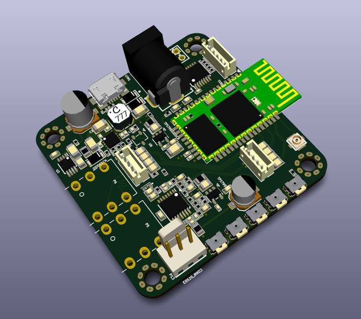

It actually is a bit "overengineered".
Front left is USB input for data with USB-connect-detection via voltage divider to GPIO as the USB-bus-voltage is not used here at default. (And maybe never will) Then there is a POR-circuit for the BT-module to delay power-on until the voltage is stabilized and coupling caps are charged. The stuff around the inductor footprint is a 1.25Mhz buck converter with a coupled inductor layout to provide a second isolated voltage for the analog section which mainly consists of an R2R low-power dual-opamp. So the buck converter is bringing down 6-36V input voltage to 4.5V intermediate voltage. Both the digital and the analog part gets their own LDO to bring the voltage down to regulated 3.3V. On the rails there are several filter implementations.
As said, the analog stage is doing differential to single-ended conversion, but there's a header to get the differential signals as well. Secondly, the Mic/Line-in is brought out to a header via ac-coupling. Also there is the PCM/SPI interface which also contains I2S at the top left. This is feed through a 24Mbit/s bidirectional level-shifter. (1V8 -> 3V3)
Finally there a 2x 3.5mm jacks for output and external switched (bypassed) line-in.
So yeah, thats it. :D

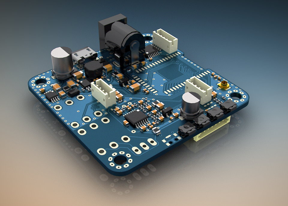

Pretty much final.
attachment.php
2Vrms Line-Driver (TI DRV603) with MFB-Filter (25kHz passband) and cap-free output
Ground-Loop-Breaker-Resistor implementation
5 buttons
GPIO-Extender/Breakout-Connector on bottom side
I2S/SPI with 1.8V -> 3.3V level-shifter
USB-Audio
Diff-In
Diff-Out
SE-Out
Power-Options:
Option1:
Flybuck 950kHz (6-42Vin -> 3.3Vdigital + isolated 3.3Vanalog)
Option2:
Flybuck-bypass via HV-LDO (5-36Vin -> 3.3Vdigital + nonisolated 3.3Vanalog),
USB 5.0V
Reactions: 1 user
Yeah, the board actually features different options to populate, as I haven't evaluated what level of clean power and isolation is really needed. So half of the stuff is optional. There's also a lot of capacitance which may can get consolidated. But better having all options first than doing 3+ iterations of the design, being always behind the demand. I'll surely do a small 10 PCB batch.

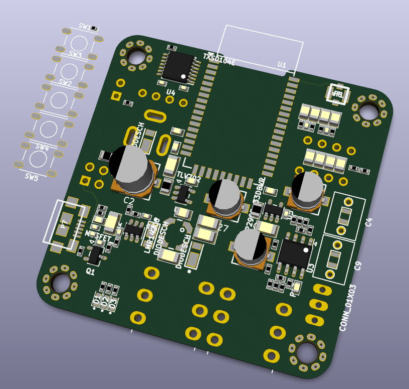

Hey. Can I connect the module csr8645 via i2s for external dac? So what to do?
Haven't tested yet, but it is supposed to work like so.
That's really a fine job with that PCB for CSR chip. Got luck of testing the board yet?
One question, if you allow, doctormd - what is the value of R4 and R11 resistors on your diagram in the LM358 input?
The resistor where meant to symmetrize the inputs and are optional. The concept is skipped in the actual implementation as i use a diff/se linedriver.
