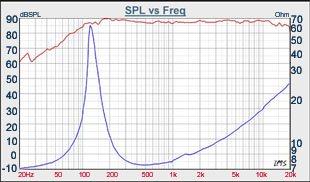

For reference, here is an image of the impedance curve, resonance is obvious.

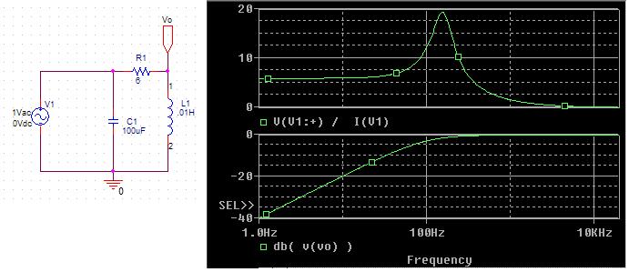

The math is not the problem.
I'm a analog/digital electronics engineer. I've read some articles on modeling resonances as LRC circuits because they behave similarily so I was trying to use my circuit knowledge to better understand speaker behavior.
I'm trying to understand how to go from fig 1 -> fig 2. In a standard resonance circuit, the transfer function (and therefore freq response) slopes off on either side at the same rate (dB/dec). However, putting a speaker into a box produces some kind of high-pass like response. I can't find the theory/math behind this.

azira said:
My first problem is I don't understand how the impedance curve for a speaker gets translated into a high-pass filter kind of curve of a box (sealed enclosure for example).
It doesn't. They are related, and have the same origin, but one does not cause the other.
Let's take the response curve first. Lets set up a few need-to-know things for this:
-Sound pressure is proportinal to the *acceleration* of the cone.
-The force from the coil acting on the cone is proprtional to the current running through the coil.
-The moving system of the driver consists of a mass, a spring, and some resistive losses.
-These mechanical impedances dominate in different frequency regions.
-At high frequencies the mass dominates, at low frequencies the spring dominates.
So, at high frequencies, the movement will be controlled by the mass, mainly, and since the force acting on a mass is proportional to the *acceleration* of the mass (F=ma), we will have an acceleration proportional to the driving current. Since sound pressure was proportional to acceleration, we get an essentially flat response for frequencies above the resonance frequency.
At low frequencies, the movement is controlled by the spring. Using the same reasoning we realise that the *cone excursion* will be proportional to the driving current. Now, acceleration (which was proportional to sound pressure) is the second derivative of the excursion. The second derivative of sin(wt) is -w^2 *sin(wt), we see that the response is proportional to the frequency squared. This is the same as a tilt of 12 dB/octave, and this we see below the resonance.
Now to the impedance curve. The impedance originates in two parts, one from the electric impedance of the voice coil, and one impedance corresponding to the mechanical load on the coil.
The electric part is the easy part. It is a resistance (the DC resistance) in series with a (lossy) inductance. This inductance is responsible for the raise of the impedance towards higher frequencies.
On top of this, there is a resonance which coincides with the mechanical resonance fs=1/(2*pi*sqrt(Mms*Cms)). This is harder to explain, but one way would be that at resonance the mechanical system is particularly easy to move. This will cause the coil to move a lot, and a lot of EMF is generated by the coil moving in the magnetic field. This EMF counteracts the driving voltage, and this makes the current drop. This is equivalent to a high electric impedance.

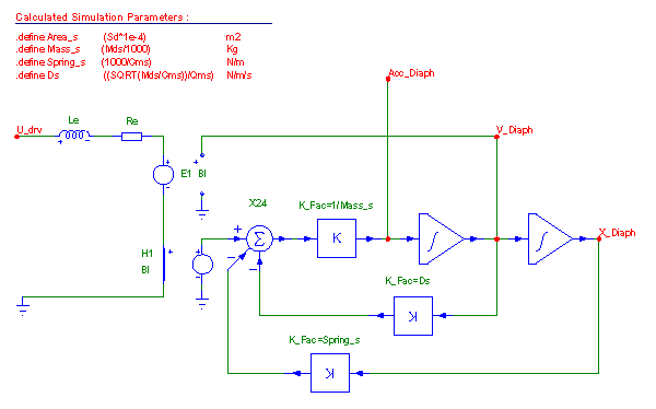

azira said:
I just did a sim...
Try to simulate the circuit below instead. All parameters are T/S parameters, RML is the mechanical radiation resistance:
RML=(Ss*w)^2 * rho0 /(2*pi*c)
Note that it is dependent on the frequency squared.
Simulate this and you should see the driver impedance as the impedance connected to the voltage generator, and if you can find the *power* dissipated in RML, you have the HP function!

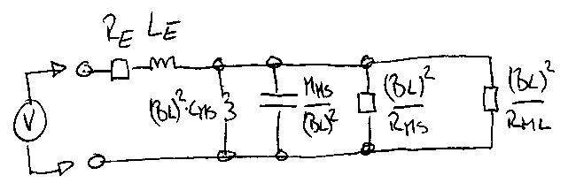

If it helps to understand a loudspeaker unit, long time ago I made an electromechanical model to simulate in Pspice. Basically it is a second order mass-spring system. The acoustical output is proportional to the acceleration.
For a closed box, the springiness of the air in the box acts in parallel to the springiness (compliance) of the speaker itself. For a BR the speaker is coupled to a Helmholz resonator formed by the springiness of the air in the box acting on the BR-port and the air-mass in the BR port.
Cheers ;)

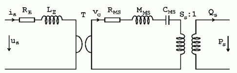

Nice simulation! This is the Physisists way of doing it.
The electrical engineer might do it like this, using electric-mechanic-acoustic analogies. To the left currents are flowing through the cables and voltages appear over the components, in thew middle velocities "flow" through the components and forces appear over them, to the left, volume flows flow through the components and pressures appear over the components.
The diagram is the equivalent of a loudspeaker. We feed it a voltage (us) and a current (is) in the electric domain, and out of it we get a volume flow (Qs) and a pressure ((Ps) in the acoustic domain.
T=Bl and the symbol below the T is a gyrator, Ss is the cone area and the symbol below is an ideal transformer.

Svante,
thanks for that info. Just out of curiosity, Qms would be the Q of the mechanical RLC circuit (Rms, Mms, Cms), right? Then what would Qes be? There is no capacitor on the electrical side (left of the gyrator). Or have I got it all wrong?
