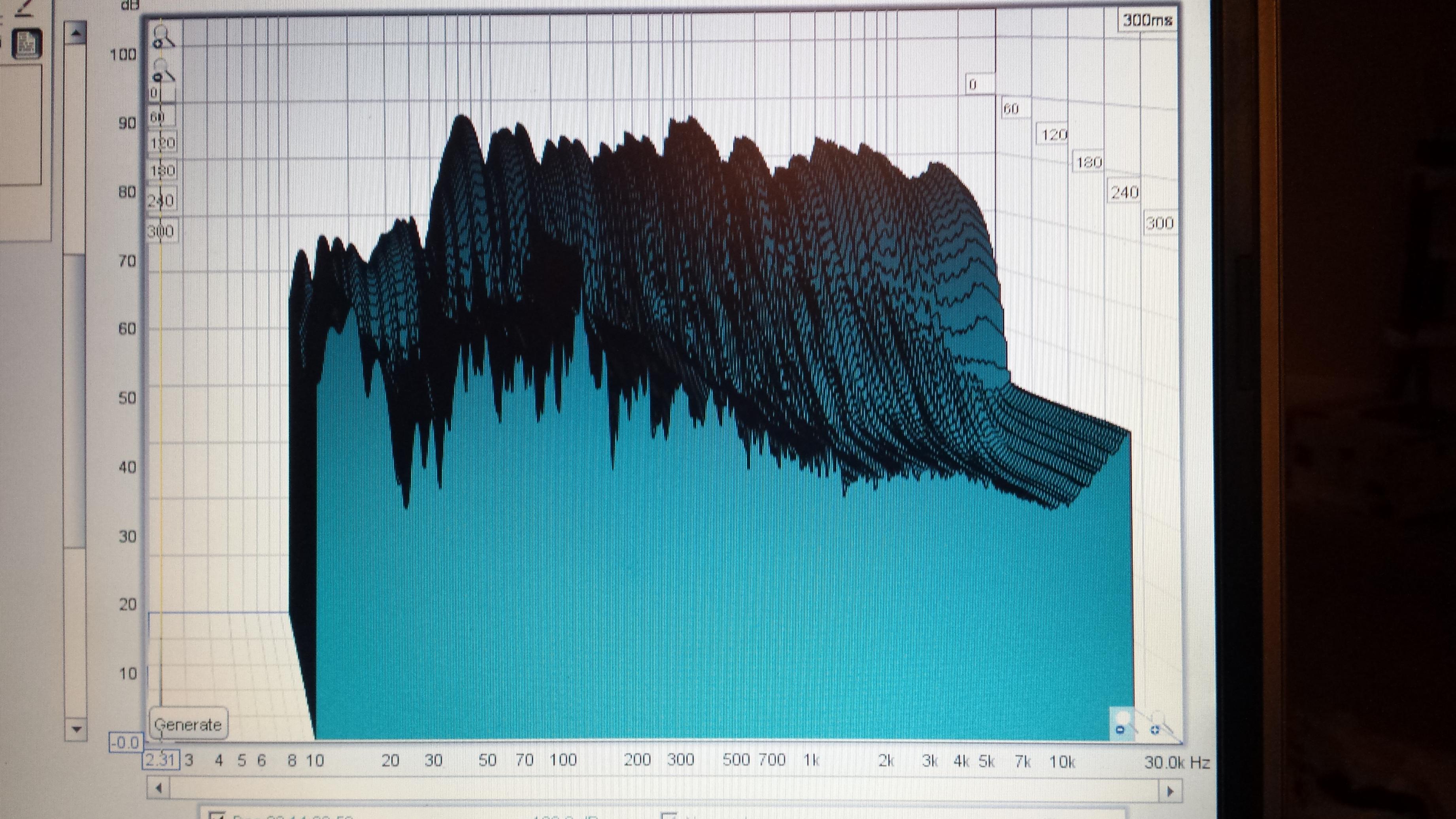

Subwoofer may very well ''smooth the FR'', but any Professional acoustician will tell you that the FR is much less important the the ETC response. You need to reduce decay time in LF and thats where bass traps cannot be replaced by subwoofers. the only way to reduce decay time is by absorbing the LF bouncing around the room.
Earl method of adding multiple subs may very well help for comb filtering, but id personally like to see the ETC. Low Freq must be absorbed and without bass traps, it seems that adding subwoofer will help the FR response but the ETC will show a very different story. Bass traps is absolutely necessary to reduce decay and since you have many subwoofer, bass traps is even more critical.
it seem that while smoothing the FR, earl method (multiple subwoofer) do not address decay time. I know that acoustician find ETC much more informative about the room response then the FR especially in LF
Do you have the ETC measurements at the listening position?
In any room, you must have as low decay time below the Schroeder area as the rest of the frequency range. Basically, you need many bass traps no matter the room if you want to have even decay across the frequency range. This is where most hobbyist give up but theres no replacement for absorption of LF.

Acheiving a flat LF response is far from resolving bass problems in a room. the ETC is as important and many will say that its even more important the Flat response.
More subwoofer means more LF resonance bouncing in the room. Resonance needs to be absorbed via absorption.

I Google "ETC response" but could not find anything audio related.
ETC is the waterfalls graph that show your decay times: http://www.gikacoustics.com/understanding-decay-times/ the aim is to have even decay times across all the frequency range: within -10db to -15db at 15ms ideally.
