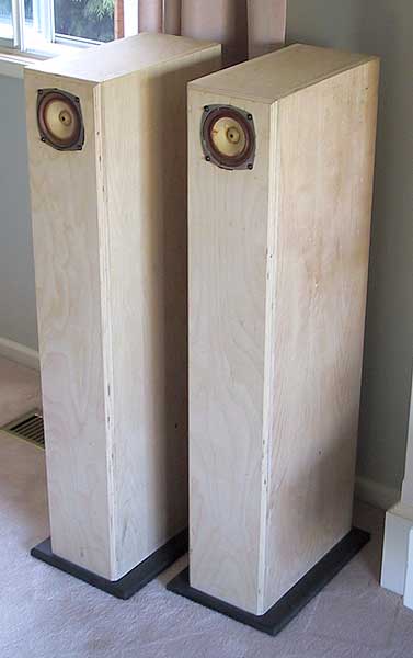

My buddy Chris built a set of Buschorn IIs (he took more care with corners & voids than the plans show). They have had RS40-1197s & FE103As in them (picture of FE103A before the phase plugs were added).
In any form they took, they were good. In their current form -- FE103As, rweaked with phase plugs -- they are quite stunning.

Are those 103's, uh, rusting? Or is that Damar varnish (yet another tweak I know nothing about)...
Those are FE103A. They are at least 30 years old, and commonly have a problem with the glue that holds the surrounds down to the cone migrating down on to the cone (usually requires re-glueing the surround). The other tweaks are a coat of puzzlecoat and ductseal on the baskets. Yet to happen are inside basket leg anti-reflection damping and maybe some felt to help with reflections off the spider.

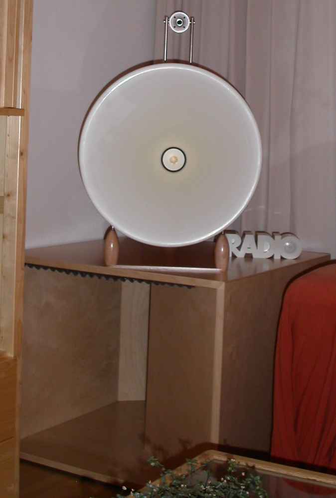

Guys,
I've tried FE103/FE103Sigma/FE108Sigma in the backloaded horn I posted yesterday in another thread, something about 'cool Fostex horns...'
At the moment I'm using FE103Sigma's in a 200Hz Oris103 fronthorns, these are prototypes from Bert Doppenberg. I'm using sand-damping on the plastic horn. On top is a modified Audax PR120i, below is a JBL K120 in a 50Hz horn.
The result is in no way comparable to a single backloaded 103....
reagards, Peter
