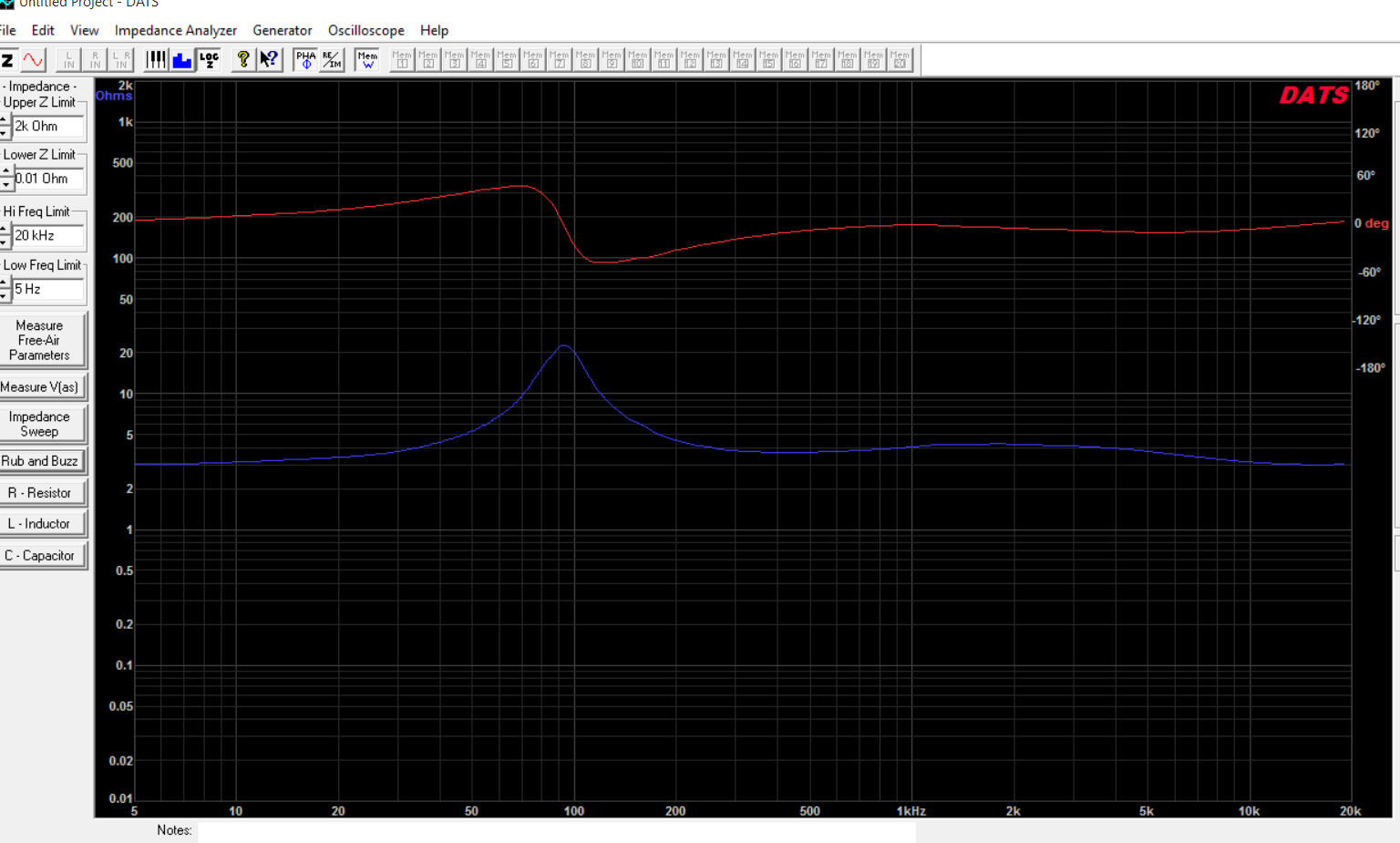

Update:
I ran only the single top midrange (MT instead of MMT) and problem is less pronounced but absolutely still present. I think it's so noticable to me because of using 4 drivers)
Hooked up the 12MU's full range fed right off my CD player to power amp. (eliminated the crossovers and all other electronics) Running the drivers full range with no crossovers the same problem is very much still present. This rules out any crossover problems which I was already pretty sure was not the case.
Played with the DATS'2. Doesn't really show anything and I didn't really expect it to. No voice coil or issues at all on any of the four driver with Buzz/test. The impedance sweep looks very flat from about 200 hz up. No irregularities to that.
Resonant frequency in the cabinets approx.90hz (doesn't really matter I measured it so thought I'd list)
I'll play with my OmniMic V2 more when I get some time. As I reported earlier though the frequency response sweep actually looks pretty damn good after playing around with various crossover and level settings.
I think the drivers is a bad design with that wide/flat ring completely blocking the back wave from the cones back. It's bouncing back to the cone at certain frequencies between that gap. I really think these are bad driver design and it's less pronounced when using only one so it could almost go unnoticed and chalked up to driver colorations.

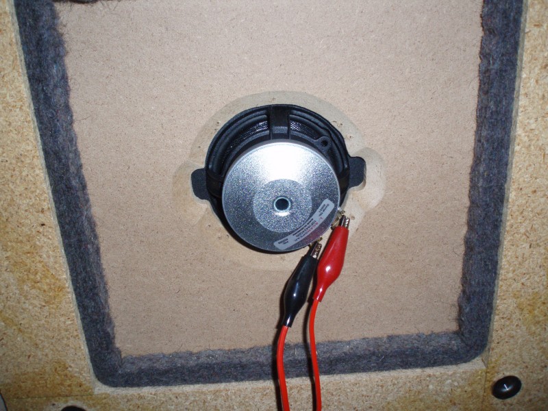

Most spider designs are similar - it's almost certainly not the spider (at least when compared to almost any other driver).
What it might be however is a reflection off of the spider's support ring (driver frame) - which is a bit large. Consider applying a lossy ring of felt on it and see if that makes a difference.
I would be very surprised if it was cabinet related or reflections from the driver's own basket. It's far more likely to bee the xover.

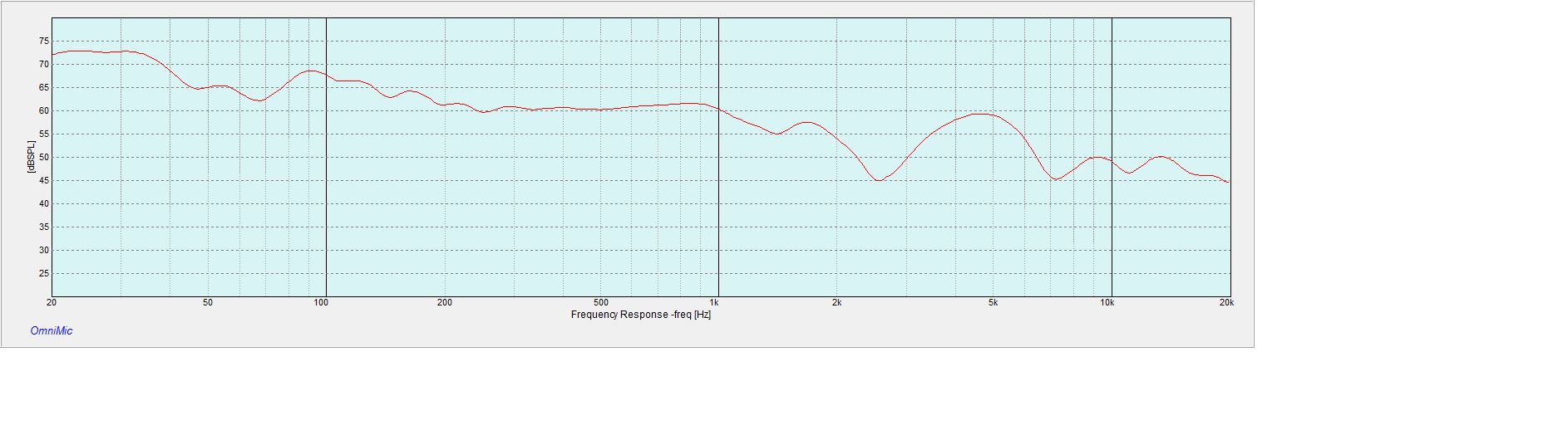

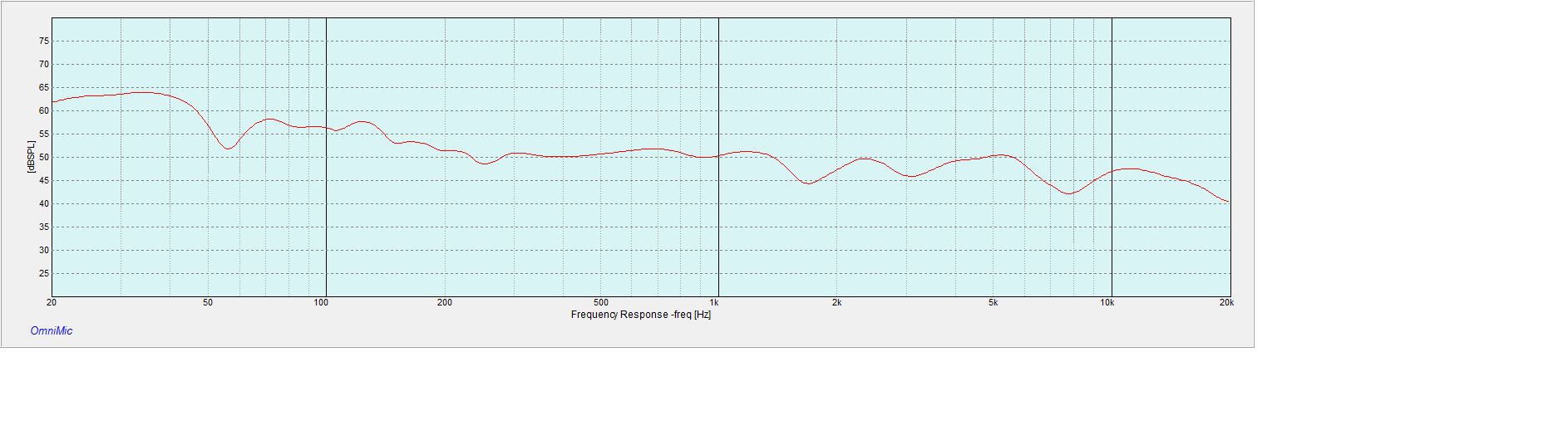

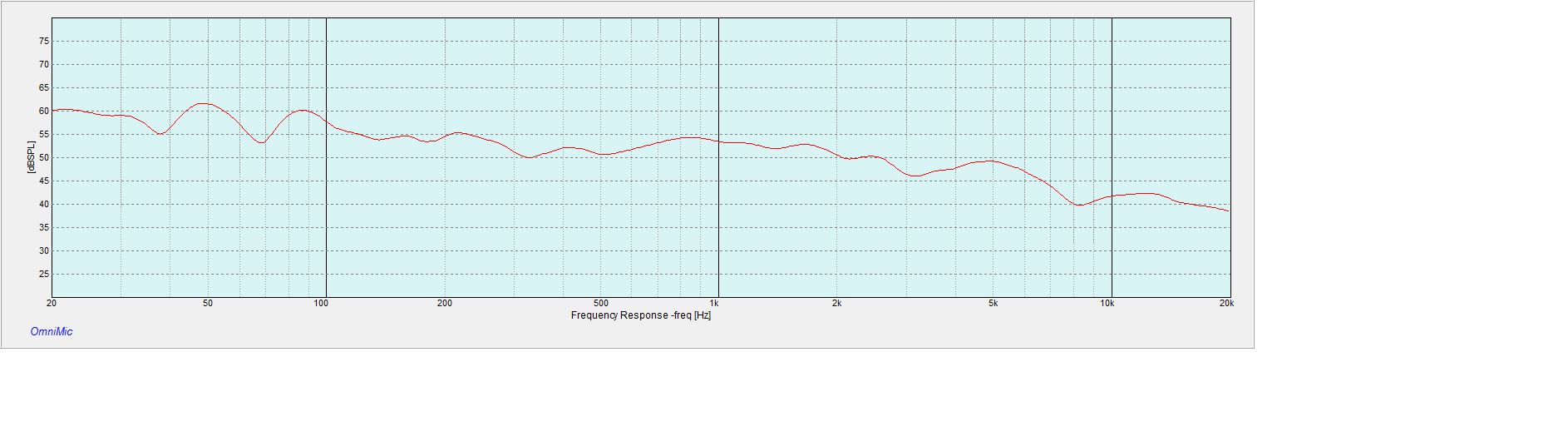

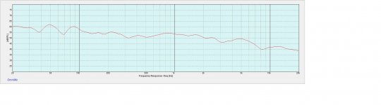

Adding impedance curve (X-over frequencies: 290hz & 2500hz @ 24db)
Left Channel Sweep
Right Channel Sweep
Mono Sweep
Does anyone know why the Mono curve looks kind of mess up? (last one)

I wonder if this could be a weird ringing in the active filters themselves. Try listening to the outputs of your crossovers with a pair of headphones or another speaker altogether to eliminate that as the problem.
I don't think so. All the electronics is exactly the same used in my prior tri-amp setup in which I had a Focal 5k4411 & an Eton dome tweeter. (same 12 inch woofers) No hint of any issues in that setup.
I'm pretty sure I got bad drivers. Something is resonating/ringing it isn't a response peak I'm hearing. It's less detectable with 2 midranges and I can see how it could almost go unnoticed or chalked up as slight driver coloration. The fact I'm using four magnifies the issue.
The above curve is bad at the midrange/tweeter crossover but it doesn't matter because it does it only driving the midrange with or without crossover full range. (I tried it again today)
