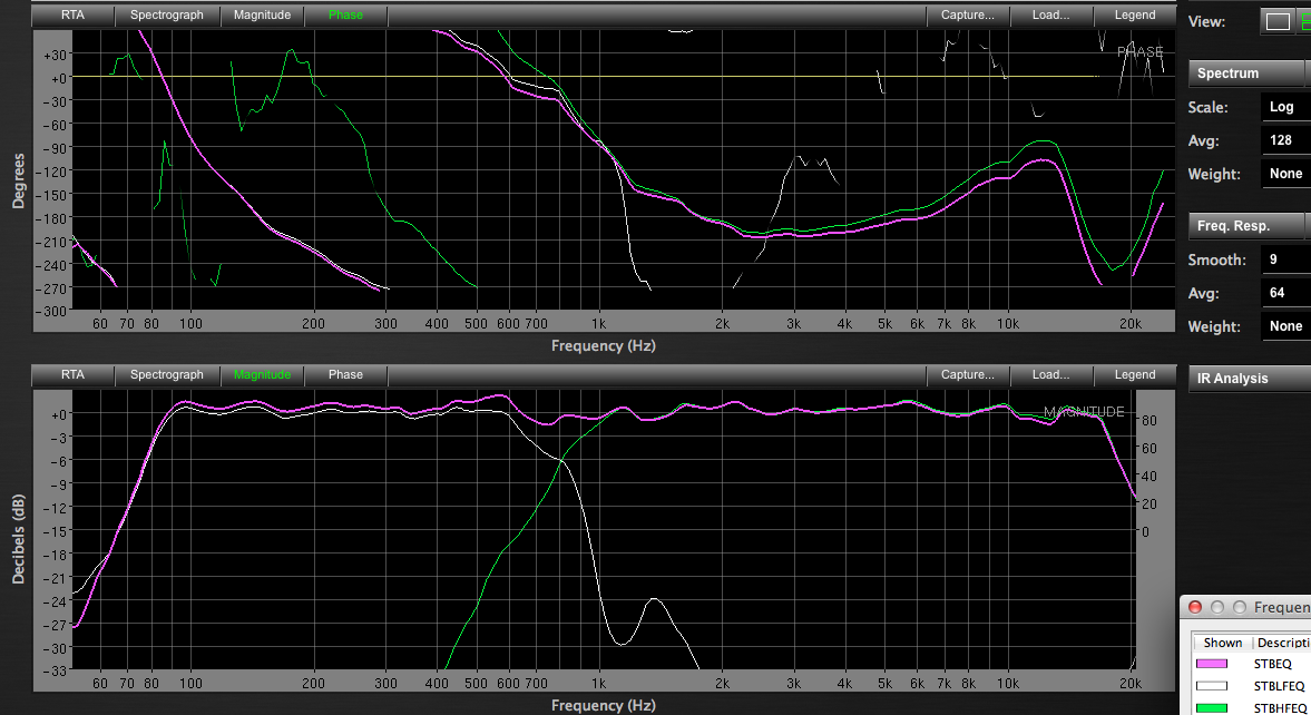

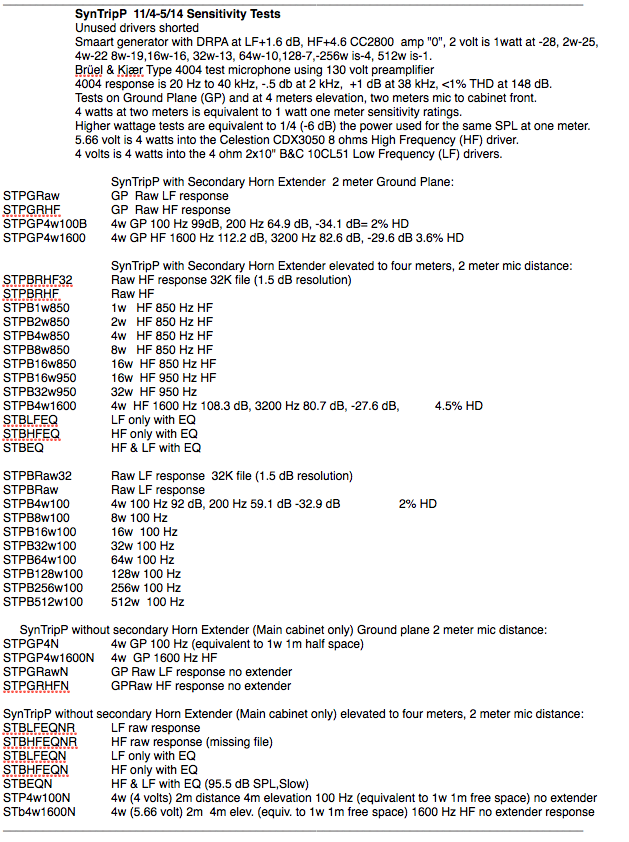

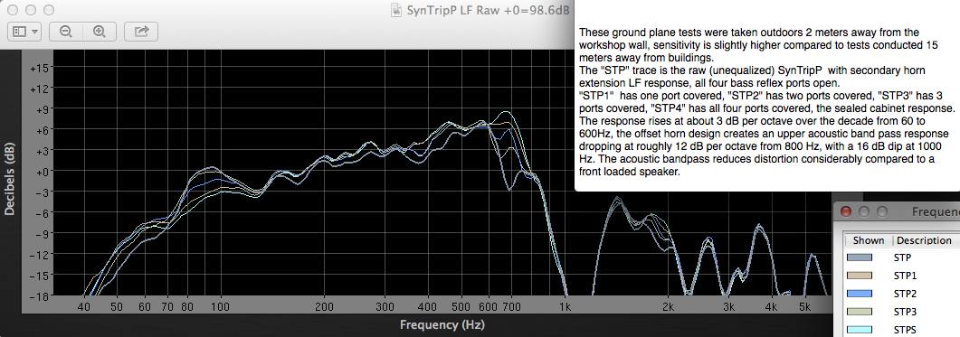

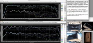

SynTripP 4m (free space) Raw FR, Phase, & Sensitivity.jpg329.3 KB · Views: 13,696

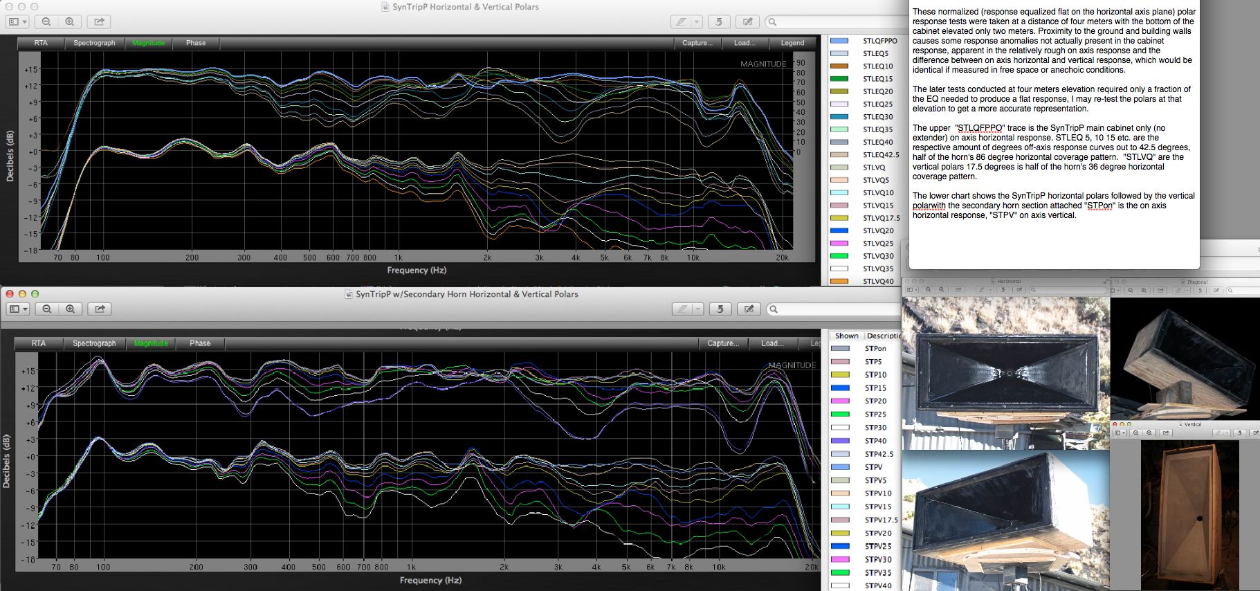

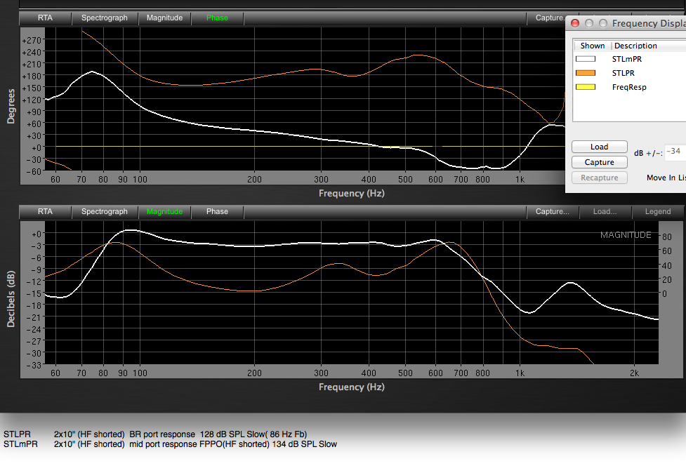

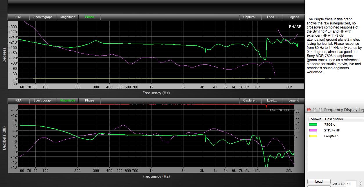

SynTripP raw combined response, Sony MDR-7600 Headphones.jpg134.8 KB · Views: 3,320
Ernie,Very rewarding project Art! Always look forward to your posts. Even liked the history

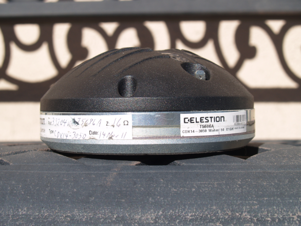

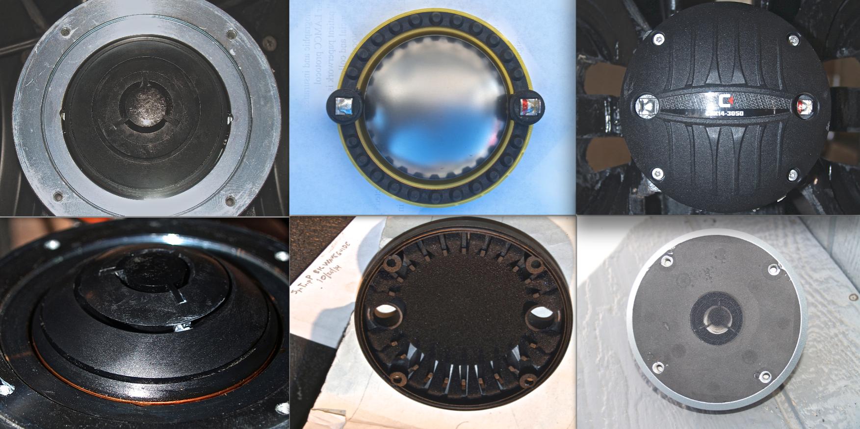

How does the Celestion hold up to the EV's you were using?
I have been using EV DH1AMT drivers since 1992, they hold up great, and nothing i have tested or listened to has been any better for the parameters I find important.
The Celestion CDX14-3050 has less sensitivity than the DH1AMT due to the plastic surround, but may have a bit less distortion in the SynTripP HF pass band.
A friend gave me the CDX14-3050 16 ohm production sample (unavailable in less than an order of 96 drivers) which resulted in the unfortunate problem that getting a matched pair of the standard 8 ohm CDX14-3050 required me to purchase an extra 8 ohm diaphragm to replace the 16 ohm production sample.
My usual diaphragm replacement protocol starts with a thorough cleaning of the magnetic gap, but the CDX14-3050 gap has Ferro-Fluid (a ferrous metal impregnated oil that wicks heat from the coil to the magnet structure) in it.
The replacement diaphragm was not accompanied with any replacement Ferro-Fluid, removal of the 16 ohm diaphragm reduced the FF level (some came out on the voice coil), and to maintain the reduced FF level little cleaning could be done. Disgusting, like changing a car's motor oil and leaving in the old dirty oil filter.
FF affects damping and Fs (resonant frequency), I need to inquire the manufacturer as to how critical the FF volume is to the CDX14-3050 frequency response, and what removing the FF may do to frequency response and power handling. Power handling is not my primary concern, as HF drivers generally distort so badly at a fraction of their rated power that I won't use them near that level.
"Classic" HF drivers do not use FF, if operated in clean air (no floating ferrous metal particulate) they will last almost forever. FF, like any oil, will be contaminated by airborne debris and eventually "go bad".
The 8 ohm replacement diaphragm does seem to be a bit smoother than the 16, but either it is reversed polarity from the 16, or (more likely) I installed it backwards.
After completion of the second SynTripP I'll find out which is the case.

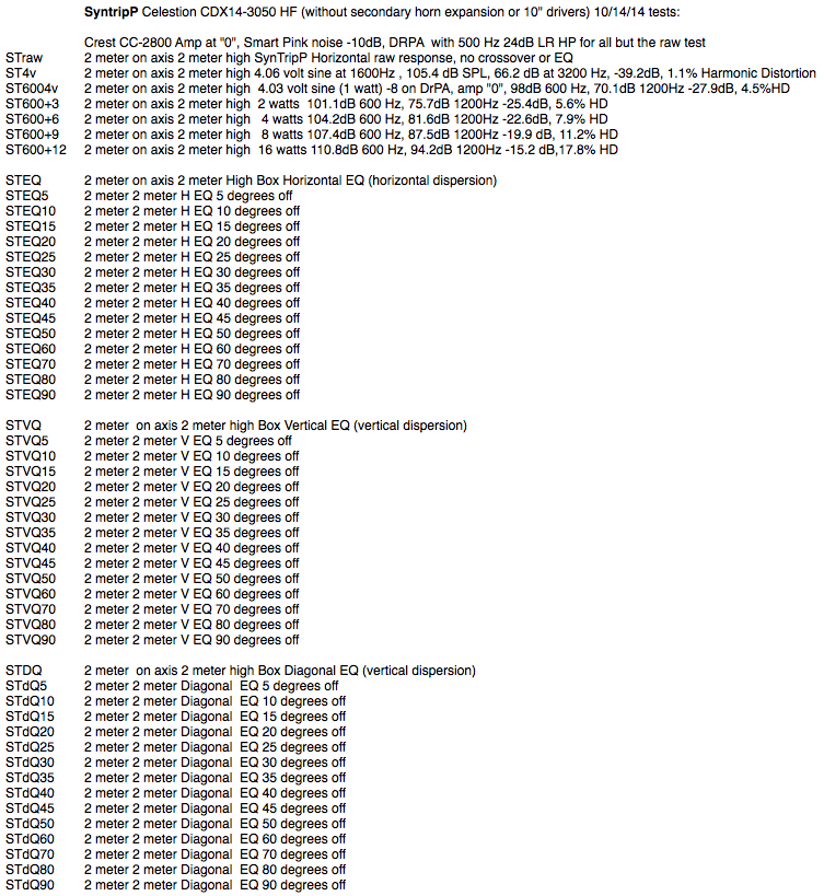

Tests, tests, tests...

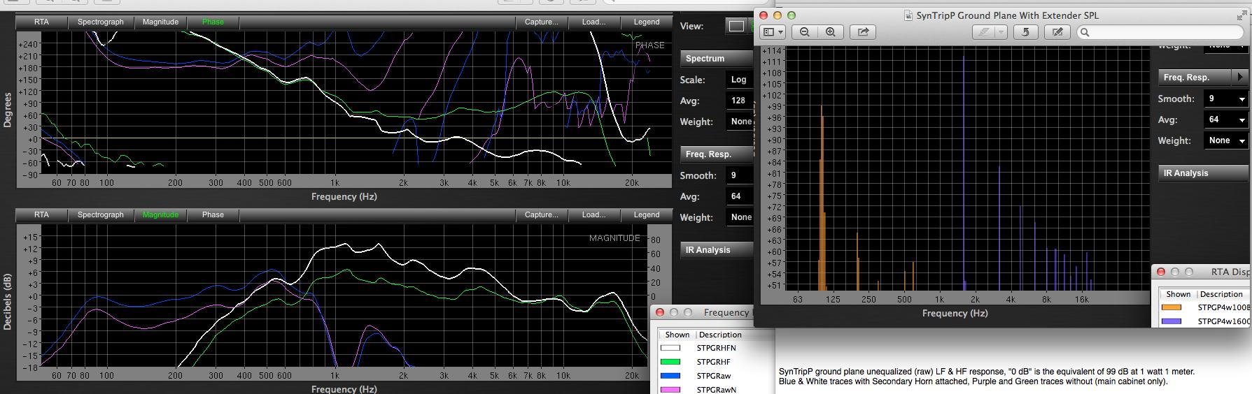

WoW, that's a LOT of thought/time/energy etc etc you've put into this, which has obviously paid off. So you should be rightly proud of what you've achieved. It's a shame we can't hear them ! I liked the history too
I know what you mean about riders. A lot of people who should know better, just take the urine on purpose, just because they can I've heard about some really crazy ones over the years. If more venues had told them to eff off years ago, it wouldn't be as stupid as it's got !
Nice work Art - that is one flat freq response curve. Do you have a plot that shows both woofer and tweeter on same plot to see the XO behavior? Is the XO pure DSP bi amp or have you managed to make a passive XO? I like how the extension turned out - almost looks like a fiberglass molding.

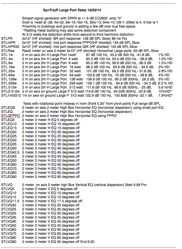

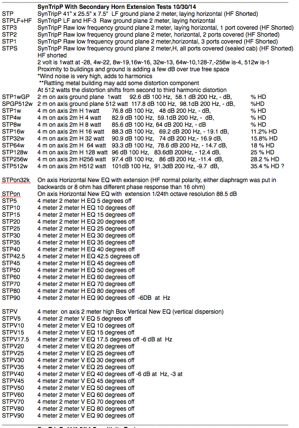

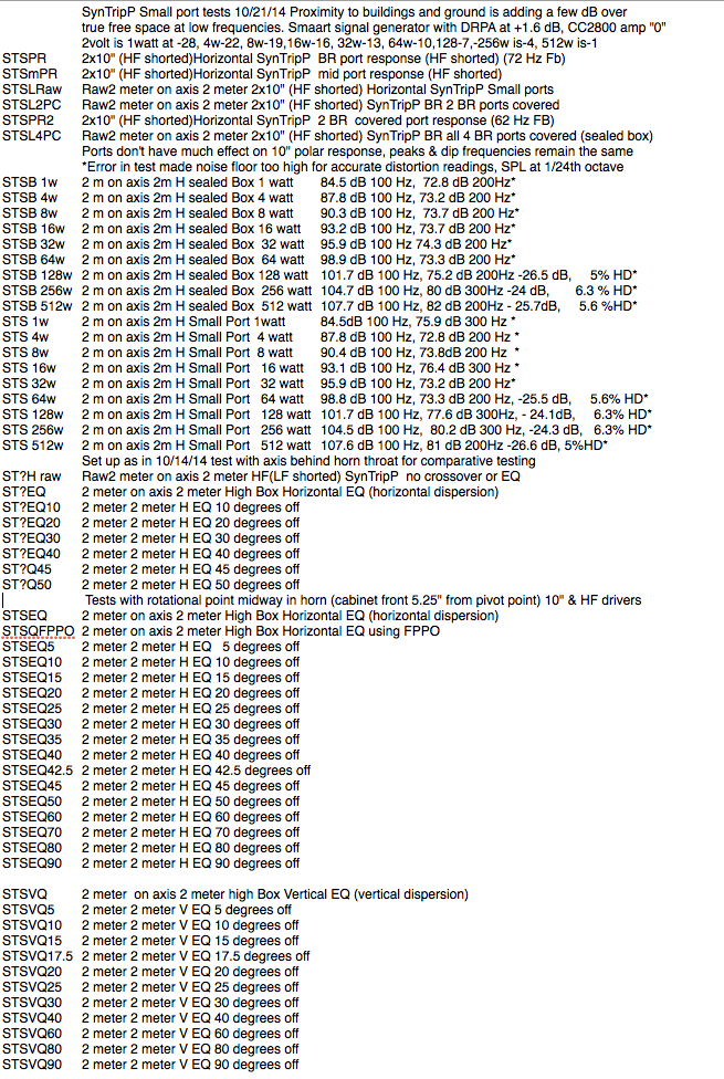

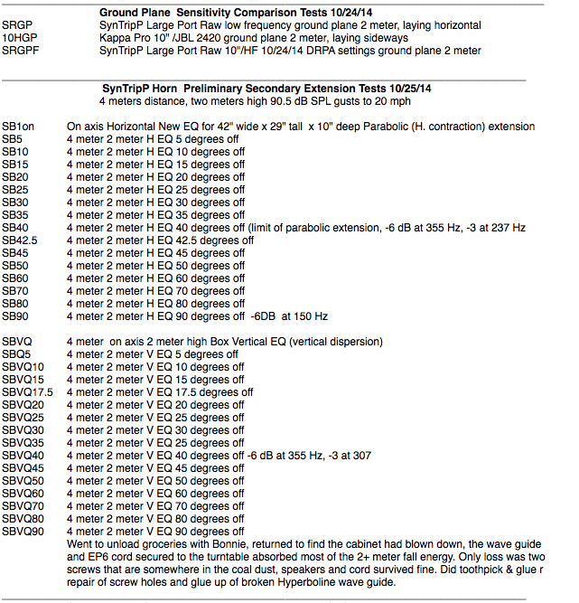

I will be developing a simple passive crossover, but have not yet. Other than the plot in the OP that shows the combined response with no processing, all the crossovers have been DSP. Of interest, the crossover EQ settings created for the tests at two meters high were quite different than the 4 meter high settings below, they were correcting for ground bounce.Nice work Art - that is one flat freq response curve. Do you have a plot that shows both woofer and tweeter on same plot to see the XO behavior? Is the XO pure DSP bi amp or have you managed to make a passive XO?

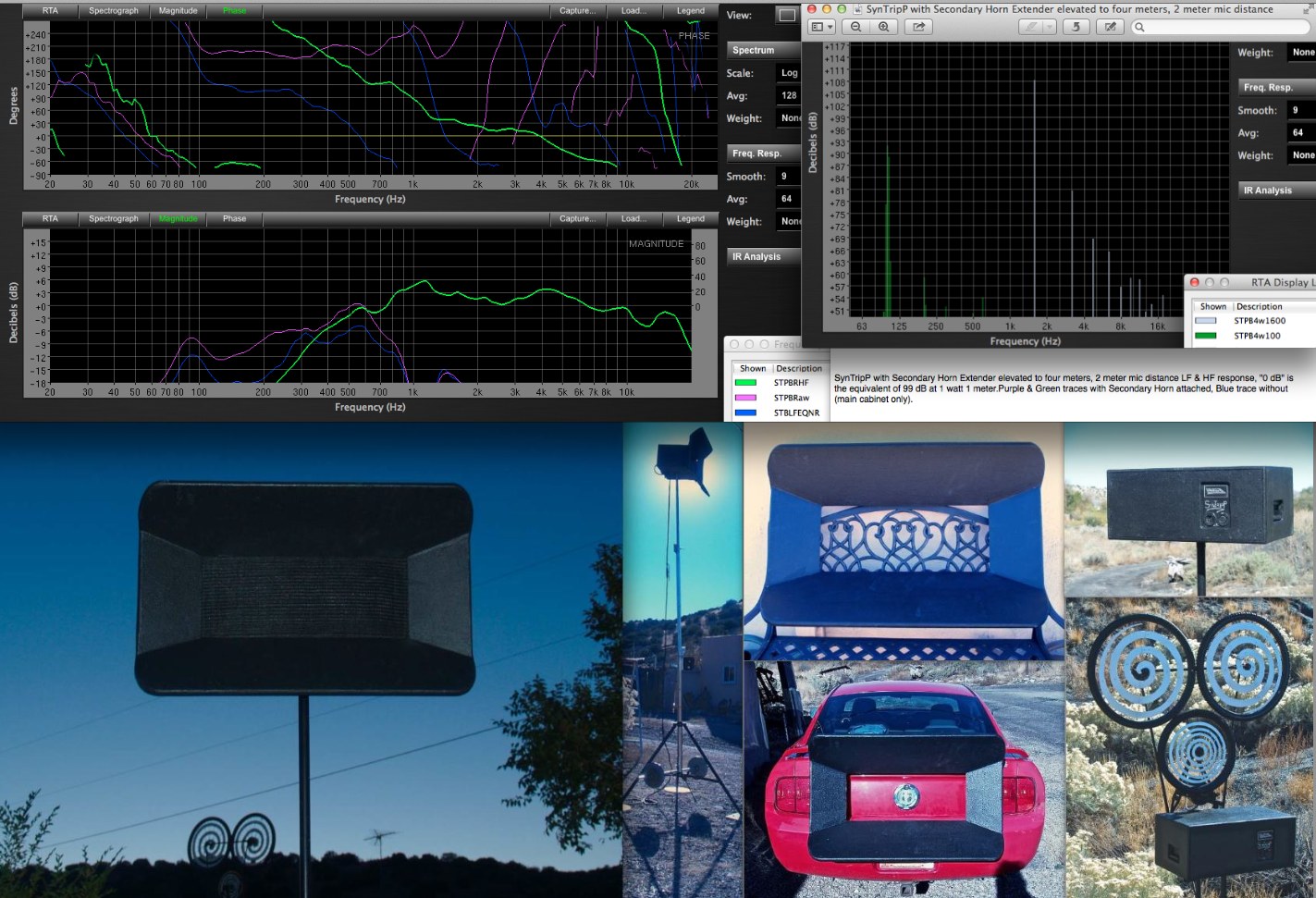

After completion of the second cabinet, I'll conduct new polar tests at 4 meters high.
The build came in at 59 hours, I expect finishing the second cabinet will come in at a fraction of that time. The real time "black hole" is all the testing and review/write up process, 155 hours. Between design and build, that's an average of 5.8 hours per day for the last 37 days.
The lists of the tests is quite extensive, the files total 18.1 mega bites.

SynTripP With Secondary Horn Extension Tests 10:30:14.png138.7 KB · Views: 821

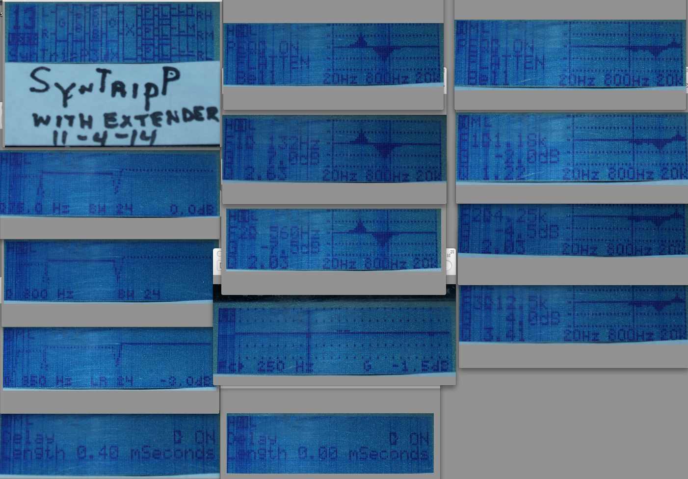

XO and filter data studied
LF section
HP 75Hz BW24dB gain 0dB / LP 950Hz LR24dB gain -3dB
PEQ 132Hz Q2,63 +7dB
PEQ 560Hz Q2,03 -7,5dB
HF section
HP 800Hz BW24dB gain 0dB
PEQ 1180Hz Q1,22 -2dB
PEQ 4250Hz Q2,03 -4,5dB
PEQ 12500Hz Q3,41 +4dB
More unshure parameters:
A parameter says 250Hz gain -1,5dB, guess could be a high shelfe in LF section.
A parameter says delay 0,4mS the other 0,0mS, quick guess LF delayed 0,4mS because of physical placement but don't known if the acoustic bandpass for LF section would take time and demand the HF section to wait fire and the delay placed here.
The 10" "mid" is using a 800 Hz BW (Butterworth- sharper cutoff at the crossover frequency) and the 1.4" exit "high" is using a 950 Hz LR (Linkwitz-Rieley, softer cutoff at the crossover frequency), the high output is delayed by .4 ms. The 10"s have more clean output potential at 800 Hz than the HF driver, raising the HF crossover point to 950 Hz reduces HF THD (total harmonic distortion) by quite a bit at high drive levels, the electrical "underlap" (gap between mid and HF crossover points) results in a smooth acoustic frequency and phase response in the crossover region.Art,
Thanks for posting the XO plot - looks beautiful. Is that 800Hz -24dB/oct?
Previous tests had used a production sample of the CDX14-3050 HF driver with a 16 ohm diaphragm, for best phase alignment the output polarity had to be reversed when wired with the positive (+) signal to the right hand side red terminal.
The 16 ohm version of the CDX14-3050 is only available to OEM (original equipment manufacturers) in orders of 96 units or more, so to get a matched pair required purchase of a standard CDX14-3050 (8 ohm) and an additional 8 ohm replacement diaphragm.
If anyone is looking for a spare 16 ohm CDX14-3050 let me know!
After replacing the old 16 ohm diaphragm with a new 8 ohm diaphragm, the polarity now had to be "normal" with the positive wire to the right terminal. This particular diaphragm is self aligning, the terminals go through holes in the compression chamber back cover, the back holes align the diaphragm so the flexible lead in flat wires are properly placed in two "divots" in the magnetic gap.
There are three possible reasons for the change in polarity:
1) I accidentally installed the diaphragm upside down, then plugged the spade connector to the right terminal, which had become the negative terminal.
2) The 16 ohm production sample I received is wired opposite polarity to the current 8 ohm version.
3) One of the two diaphragms was labeled incorrectly at the factory.
#1 is the most likely, I'll find out when I finish cabinet #2 and check it's HF polarity, and will probably have to open up the box for the fifth time to flip the diaphragm.

Hi Art;
Nice result!
I'm intrigued by the fact that your measurements showing response with 1,2,3,4 mid vents plugged showed the response changing at both the low and high ends. The change of box tuning is of course expected. Why does the response change up near crossover? Is that simply evidence that the holes are too large too hide in the corners, so to speak? (assuming that is where they are, they aren't visible in the photos)
Jack
Nice result!
Jack
Jack,Hi Art;
Nice result!
The upper 10" response changes because the BR (bass reflex) port has a pipe resonance peak that is out of phase with the woofer's offset horn output, causing differing null depth depending on the amount of ports used.
The 10" offset port holes also affect the HF (high frequency) response slightly, they don't completely "hide in the corners", but that is a different issue than the BR (bass reflex, AKA phase inversion) port response pipe resonance, a "feature" any BR design shares to a lesser or greater degree dependent on the length of the BR port.
As mentioned in the OP, the slight HF response changes the 10" offset port holes cause in the SynTripP are more than offset by the smooth vertical polar response that can't be achieved with LF and HF drivers located with a vertical separation distance near the wavelength at the crossover frequency.
Art
How is it possible to mount diaphragm upside down? Isn't concave?
I wonder if Art meant that it was rotated 180 degrees, so the 'top' of the diaphragm was on the bottom, and the terminals were reversed...?

Correct, diaphragm reversal left and right, "upside down" in reference to the driver's orientation in the cabinet.I wonder if Art meant that it was rotated 180 degrees, so the 'top' of the diaphragm was on the bottom, and the terminals were reversed...?
Are the SynTripP speakers completely unnecessary for home use?
Have not listened to the SynTripP indoors yet, after the second is complete will compare them with my home stereo speakers, and report if they then become a necessity .
I've known drivers, LF & HF, to have their magnets reversed by mistake during manufacture. Famous makes too Something to be aware of !
Never thought of that possibility. Maybe VC windings are clockwise vs counter clockwise or vice versa?
