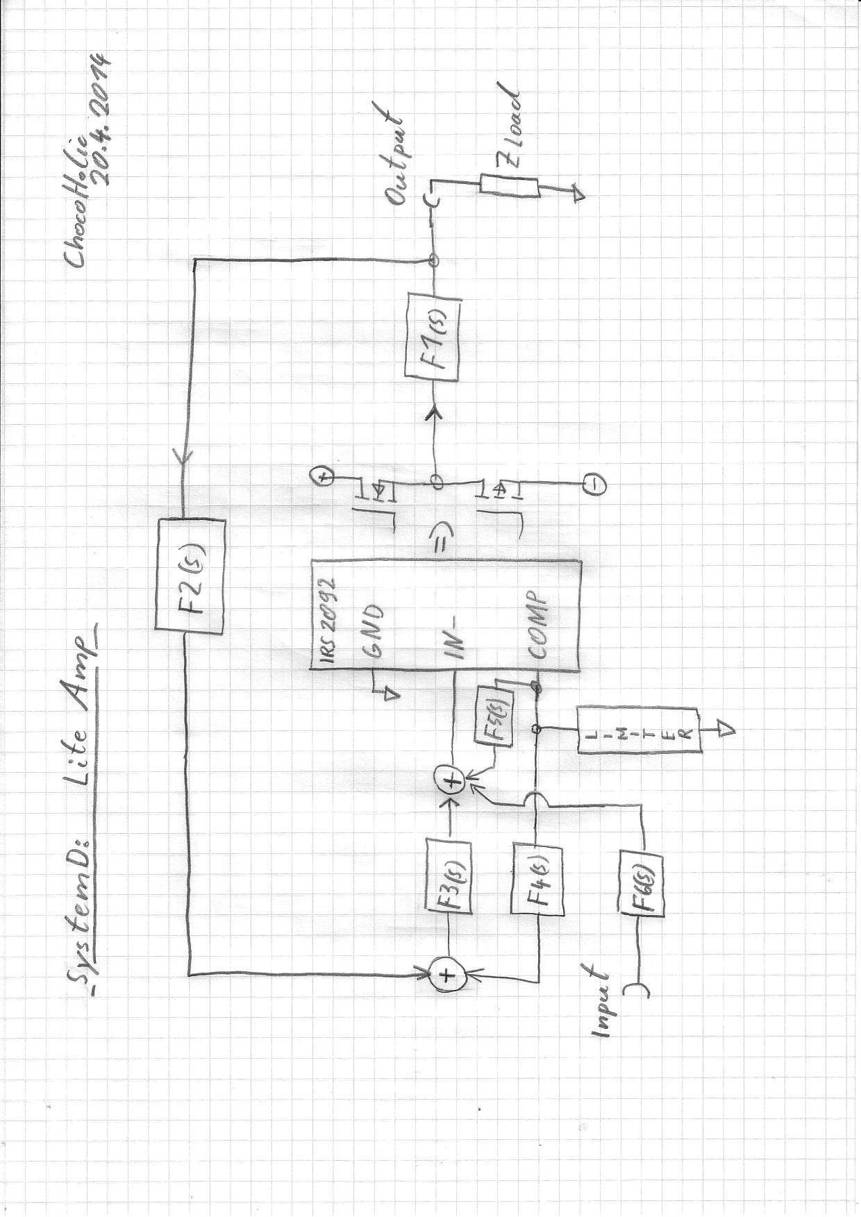

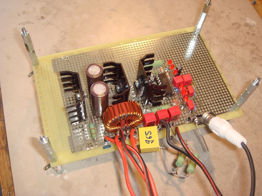

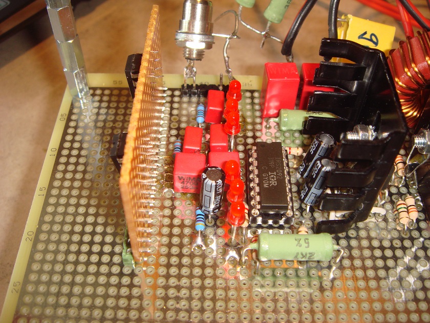

In March a friend asked me if I would like to design something simple
with the IRS2092. First I was not enthusiastic, because I had doubts that
it would work to achieve something better than the IRAUD7 and its clones.
Better means: Improved speaker control (==> post filter feedback), less noise and at least not worse distortion.
Nevertheless I had look into the topic.
My first attempts were fitting more or less to my expectations.
Good control of the filter and speaker, blameless step response, but harmonics in the -70db category all over the place. Ugh..
Also the gap between simulation and reality was to big for my taste.
Operating frequency and distortion figures did not fit sufficiently.
I digged deeper into the non documented weaknesses of the IRS2092.
Key points:
Transfer function of the OTA
Noise of the OTA
Jittery / ambitious flipping of the comparator
Internal delay times
After all this I updated my simulation model of the IRS2092 and soon came to
a changed structure, which behaves fine in simulation and reality.
Can't tell an official name for the structure.
With a good portion of phantasy we could call it a post filter feedback sigma delta modulator.
Above 60kHz F1(s) and F2(s) together are acting like an integrator for the 1Bit data stream coming from the half bridge...
In the mean time the results by far surpass the IRAUD7, but the complexity is very similar.
Step response is blameless with rise times below 5us, output noise is below 100uVrms, very low THD and nice dual tone behavior.
It is promising enough that I intend to go for a proper PCB.

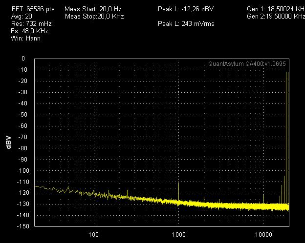

Attached a scheme of the control structure and some measurements at 10W into 4R.

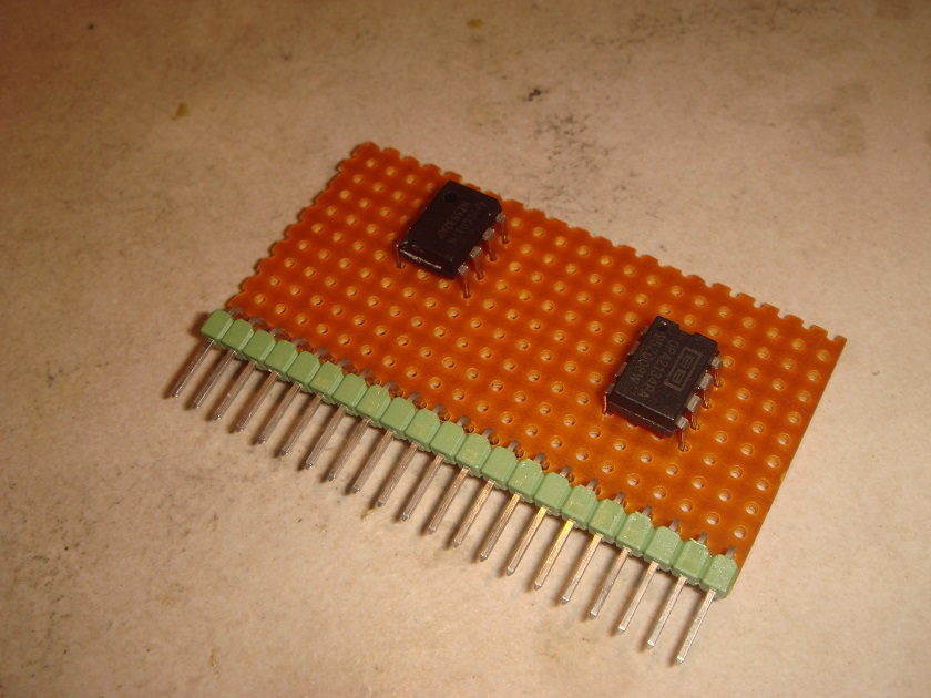

So I am considering to provide kits of key components + BOM to hobbyists on a non profit basis. Depends on forum resonance.
The shown breadboard is a low power version using two paralleled IRFI4212, running from +/-40V and providing 250Wrms into 2R or bridged 500Wrms into 4R.
Originally I intended to stick to this, because the 100V MosFets have great body diodes, while higher voltage types with poor body diodes for sure will degrade the achievable distortion level to some extend.
But seeing the nice results it would be worth to dig into a version with two paralleled IRFI4020, running from +/-70V and delivering 400Wrms into 4R or bridged 800Wrms into 8R. Should be possible with still reasonably good results, even if not as extremely low THD like the small one.
Which version would be of higher interest?
Using IRFI4019 instead of 4012:
In order to avoid increased idle losses and worsened idle EMI you will need to readjust DT and live with slightly higher distortion (some more advanced options for additional adjustment of the gate drive in order to reoptimize distortion...)
Also you will have to accept the fact that the current capability of the IRFI4019 is not sufficient for reliable operation into 2R (or bridged into 4R) at high levels ==> shut down expected when pushing hard.
Mostly pin through hole components:
Agreed. Some few SMD in key positions, but just few of them and nothing smaller than 0805.
IRS2092 is clearly planned to be DIP.

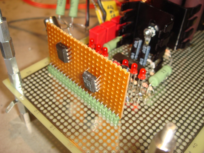

I have designed a discrete opamp and would like to be able to use them as they have very good distortion figure at high output levels. Of course these opamps need more space so it would be nice to know more of the connector sizes and mounting space/holes.
The design of the daughter board is still in the status of a preliminary idea so far.
It should be easy to fit with your needs.
Attached some visualisations.
Vertical mounted. Dual sided PCB with GND plane. The pin row will have lots of GND in order to achieve sort of an extended GND plane.
Signals/supplies: +/-40V & -GainInput & + GainInput & GainOutput.
GainInputs and GainOutput close together, so that a jumper can be placed if the mainboard is used without the optional gain stage.
Note: The OP amp supplies have to be derived from +/-40V (or even +/-70V), so we might need a heat sink back plate (1.5mm aluminium) behind the soldering side, not shown in the pictures.
Size of the daughter board not yet freezed, i.e. 35mmx55mm.
What do you think?
What do you think?
The size of the daughter board seems to be OK and has enough space for the instrumentation preamp. To add a heat sink back plate is a cool idea as we get a hf-shield too. Using a 2 row connector would give more stability. What do you think?
Maybe i need a bigger daughter board as my discrete opamps are huge but think would be no problem to design a daughter board using these 2520 sockets.

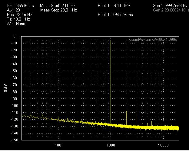

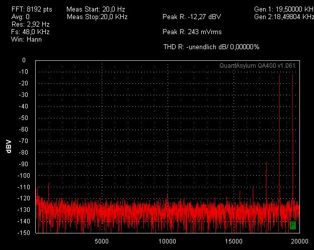

My VP7723D audio analyser has 2 different 20kHz filters so it would be possible for me to tune to best performance...
T106-2 with 30 turns of 1mm CuL solid wire is what I am using on breadboard in the moment.
VP7723D:
Fantastic! Somebody with proper equipment :cool:
On one hand my QA400 seems to be fine as well, but I am not sure if it is still reliable at such low distortion as the LiteAmps shows at 1W into 4R.
(Don't wonder about the rms values displayed, I have buffers and filters in front of the QA400 and always run the QA400 at levels which result in 700mVp, where it has its sweet spot.)

Can you show your measurements?

Well, the basics of loop control are like in the well known buck converter.
For fast regulation you either need an underlaying current mode regulation or a derivative portion in the global voltage loop gain structure.
In fact I have already disclosed in this forum a silly amount of post filter feedback informations for clocked and self oscilating designs as well.
The main difference between clocked and self oscilating is that for self oscilating we are using the same feedback loop to achieve the switching oscillation by any sort of phase shift delay oscilators, or hysteresis oscilators, or if you wish sigma delta....
In UcD the derivative portion is achieved by C_lead.
In my 2kW project I am feeding the derivative portion by two caps into an intermediate I/V conversion stage in order to avoid feeding the large HF amounts through the OP amp.
For an example of loop control see posting #375 here
http://www.diyaudio.com/forums/class-d/224052-systemd_2kw-any-interest-open-design-38.html
The simulation file in said posting contains a modeling of the feedback structure using an averaged modelling of the switching stage.
==> Loop control structure without carrier generation.
It covers everything you need for experimental learning of the pit falls of the loop control. And you can also modify it and feed the derivative portions through the OP amp...
But of course this experiments cannot substitute all the ugly things one has to learn in school book control theory. In order to achieve proper adjustments you need to know the linear control theory and some more headache about non linear effects like clipping of various stages and integrators running into nirvana...
Structure in the lite amp is again slightly different. Given by the structure of the chip I have to run the derivative portion through the poor OTA. And I added some guts for carrier shaping, the errors of the IRS2092 demand for a non fully triangular carrier to achieve best THD.
