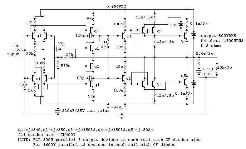

Has any one built this 1KW amp?

Here is a Schematic for u

Ampman,
The CF diode is missing in the lower half of the amp. Is this O.K?
Everyone else,
Any comments on the schematic presented by Ampman? Will the driver stage provide sufficient base current to the output stage of will there be driver pulling?
And what, no short-circuit protection for an amp of this magnitude?

The CF diode is CURRENT FEED diode which does balancing of driver stage current .
As this is Quasi complementary stage the CF diode will remain as it is at upper rail.
The output stage is formed by TRIPLET CURRENT GAIN STAGE
which has a current gain of approximately 125000 times, therefore it doesnot pose a problem on driving low impedance speakers.:devilr: :bigeyes:

Thanks for your reply and yes I'll work on your amplifier. I'll try my hands on it after am done with some few projects down here. If you can, please post the complete schematic for all (supply, protection, and having output transistors in parallel so I can be sure of what am doing). :D :D :D ..... Again, thank you!!!

To get sufficient voltage swing for the power of 600WRMS @ 8 OHMS , the supply rails must be somewhat near at +-120 VDC
I can design the amp using this criteria i.E
Supply voltage=+-120VDC
OUTPUT transistors=MJL21196 DEVICES
Drivers=MJE15032,MJE15033
Pre drivers=MJE340/350
Filter CAPS rating 4 X 10000MFD 150V atleast
Heatsinking Aluminium + 2 X 4.7"cooling Fans rated at 220VACor110VAC (which is applicable)mains operated fans
IF the above mentioned Specs are in ur range than I can proceed further
IF not, Then WE have to bridge 2 amps to get desired power at supply rails @ +-75VDC
