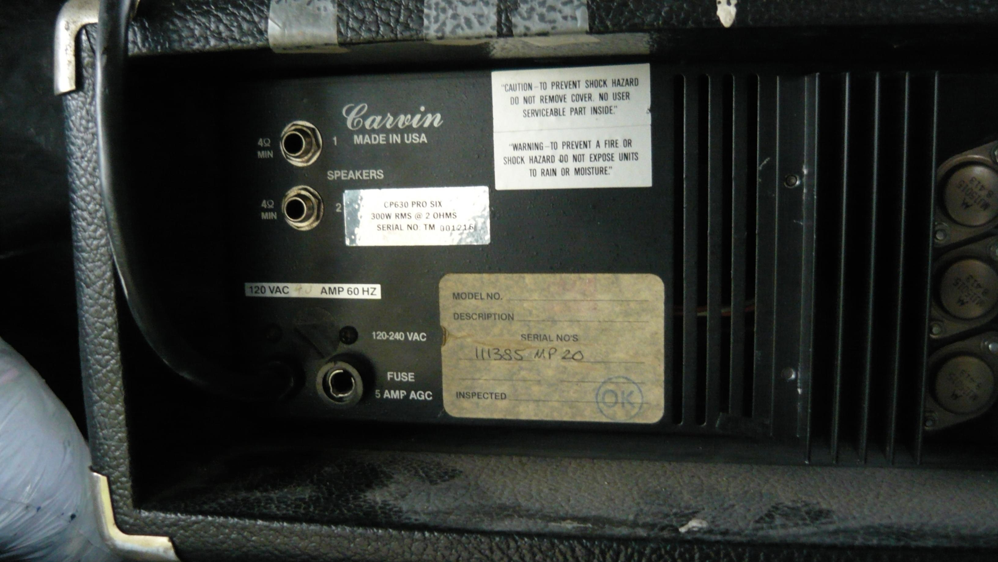

I found/trashed pick a Carvin Mixer CP630 Pro Six i wann a fix it. Problem is i don't want to f@#% it up (cause i tend to do that often). So i was wondering if anyone would give me some headers before i start screwing around with anything.

i forgot to add some pictures and info about the unit.
it says on the back one of the written fuse types is a 4.0 amp?
and the other from the manufacture is 5 AMP AGC?
oh and what holds the fuse?

whats weird on the back of the Carvin Mixer CP630 Pro Six
the fuse types are 4.0 amp and 5 AMP AGC?
oh, and what holds the fuse?
the part that you are missing
a small plastic lid you turn/twist when inserting the fuse, probably with a screw driver or a coin
you said cP630. Jazbo's table is for cX630. go with the 5acg. the fuse holder is missing the cap. I believe Radio Shack sells the whole fuse holder (cap and body) for a few bucks. they keep them in their parts bin (if they're not out of stock). hurry in to your local RS to get one before they discontinue it.

When the 5A fuse rating is printed on the amp next to the fuse holder, I see no reason to think it needs something other than that.
Caps get lost. People pull a blown fuse out and then nothing keeps the cap from falling out. Also people swipe them. A cap is missing somewhere else, and they grab one out of this to use elsewhere. I never gets returned. In music stores, amps regularly get fuses and caps stolen.

your cap looks like a bayonet type.
Thanks for all the support,
I bought the cap at radio shack great fit and 5amp agc fuse but when i turned it on it immediately started to smell like wire burn. So i turned it off and started a closer look
(opened it) i come to find that one of the wires is burnt (exposing the wire it self) and one of the mosfets are loose big time weird. Now i got a fixer-upper on my hands i will post pics as soon as i buy a soldering iron.
