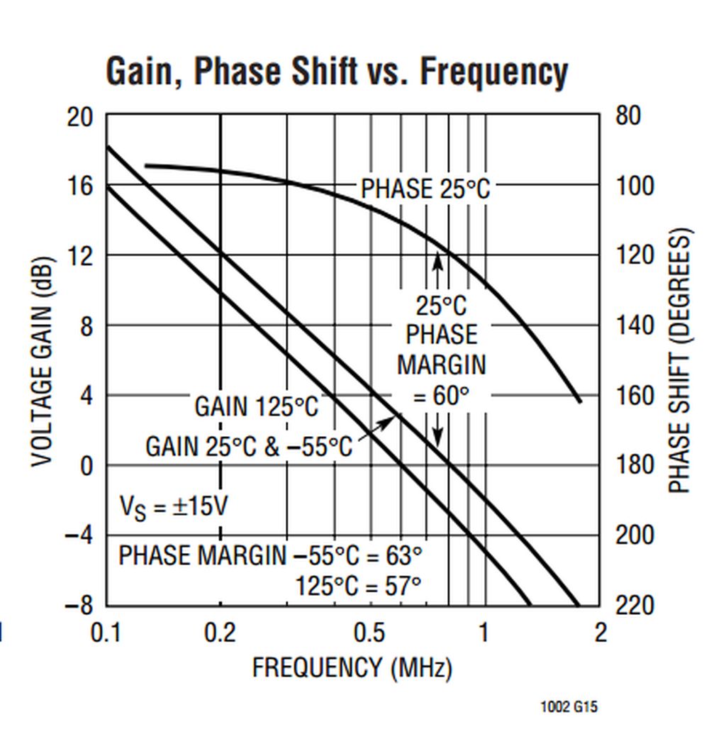

What is great about the OP07 is its enormous phase margin: 80 degrees. See attached image. It is one of the most forgiving, unity-gain-stable opamps around. And cheap too! (Link to price at Arrow)
Thanks, I have thought about using the OP07 several times in other projects, but I can't seem to find the Phase Margin rating in either AD's or LT's datasheet's.
However LT's spec sheet does suggest to use a LT1001 or Dual matched LT1002 for improved performance.
There is a graph on page 6 that shows a 60 degree phase margin for the LT1002,
http://cds.linear.com/docs/en/datasheet/1002fb.pdf
I have some LT1001's but I can also get some LT1002's as well for this project.
Below I have include Phase charts for both the LT1002 and the LT1007.
Thanks for pointing that out to me!!

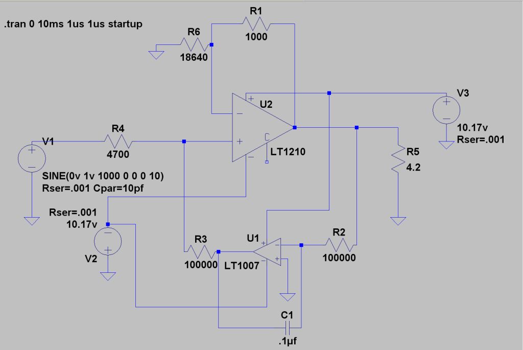

I just finished the design of a suitable unity gain buffer for using a LT1210.
The LT1210 is an incredible little buffer chip and it delivers everything that the spec sheet says it will.
Since my Signal generator can only go to 1Mhz that is the highest that I have been able to test it too.
And, it will deliver that into the 4 ohm load resistor that I am using and with square waves as well!!!
It is rated for as high as 35MHz and it was picking up the signals coming off of my mouse at 27Mhz with ease when it was within a few inches from the protoboard that I have it on right now.
It is also spec at 1.1 amps of current but its maximum as about 2 amps according to the data sheet.
It has the sharpest square waves that I have ever seen an opamp produce as it does have a 900V/us slew rate!
I did employ a LT1007 as a DC Servo to keep the Offset under control of well under 1 mv and better than below .1mv (100uv) with no signal.
Since my meter is not accurate enough to me give such data of that level reliably, by using my scope I have verified such performance.
I have it running off of a +/- 10.2V power supply that I made at of a 16VA wallwart.

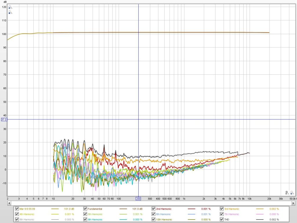

It easily produces a 10V p-p signal just before clipping that is ruler flat in to a 4 ohm load resistor, with only the power supply being the limiting factor at this point, clear up to 1Mhz.
It shows a THD of about -90db or .003% across the audio bandwidth.
This is a great little chip and it has been known to be used in a parallled power amplifier design and headphone amplifiers as well.
With the parts I have in the schematic it has a gain of 1 that is matched to within better than, less than +/-2mv at 2.828Vrms at 60Hz measuring frequency.
The 18.64k resistor is the one to be adjusted to match the gain of the circuit.
I used a 15K and a 3.9k in series out of my part bin for the value shown in the schematic.
The data sheet shows to use a .01uf capacitor on the Comp pin.
Since I have no way at this time to measure its performance at that end of the scale( 10-40Mhz) I don't know if it needs it or not.
It makes no difference in the performance of this circuit up to 1 Mhz.
So, the Comp Pin is just left open.
This is a great little amplifier should you need a buffer to be used in testing components with frequency's higher than the audio band.

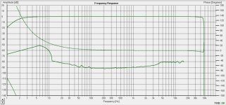

Below have screen shots of its measured performance using REW and HOLMimpulse as well as the schematic and the LTSpice file.
If any one can make any improvements to this I would be very welcomed to see them.
Even Though it is quite impressive as it is, I am going to hook it up to a speaker and a bigger power supply and see how it sounds as well.
Cheers!!!!
jer
P.S. Once I finish this interface, I will present it in its entirety in the "Exploring Visual Analyzer" thread
