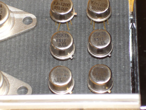

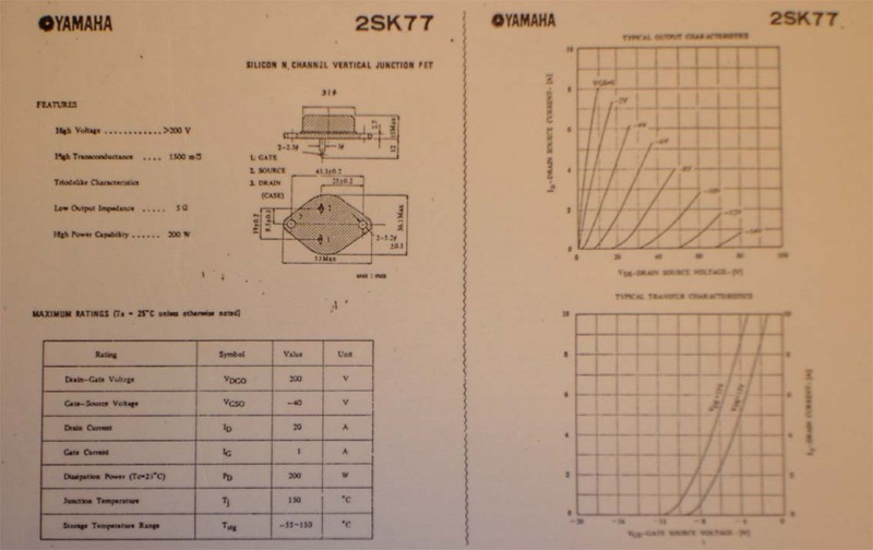

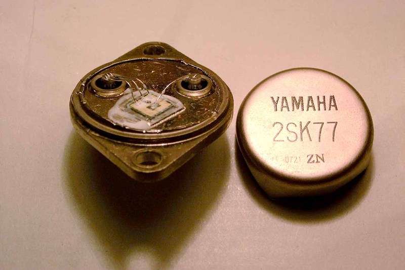

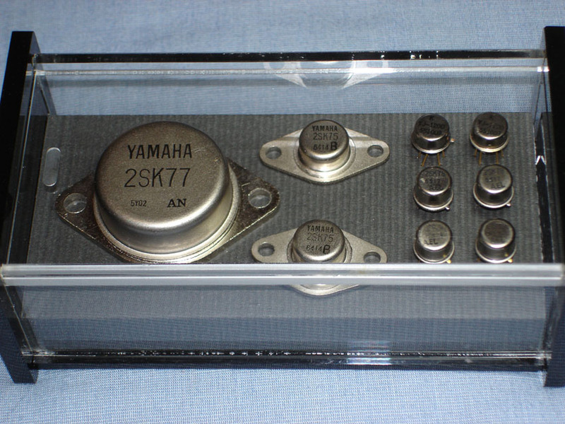

this is pretty much all I have
blur :clown:
though , I think enough for first tests

Keep the 2SK77 for the B1. They were ever only used in that amp and it's near impossible to find them in case the amp fails.
Besides, they are NOT suitable for L'Amp unless you can provide really low impedance drive, since the 2SK77 has ~1.5mF input capacitance, almost 10x more than the 2SK82.

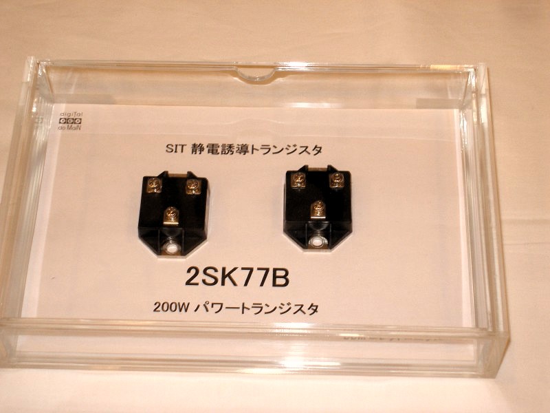

I did receive a nice present from a company in Japan named FAL, which included
a small quantity of 2SK77B, the parts used by Digital Do Main.
They are rated at 300 watts, and I have built one prototype single-ended amp
which looks a lot like the SIT-2 but with 40 watts output. It is quite
spectacular, and the circuit will become public a little later this year.
