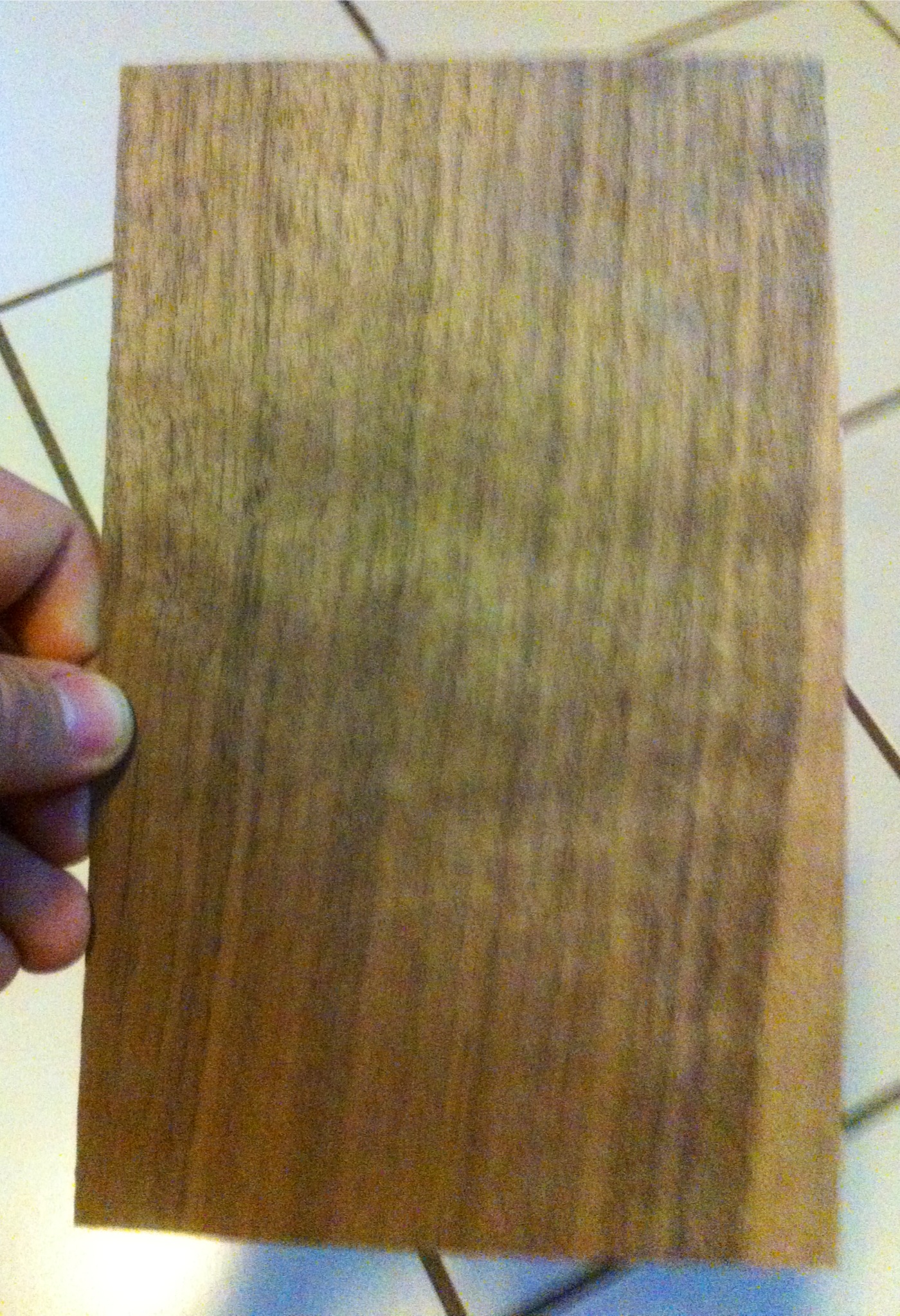

Sbrukow, thanks for making this beginner's thread. I am watching it carefully, as I want to veneer 2 speakers that I just made out of MDF. Enclosure size is 5" Wide x 32" High x 6" Deep with a 3-1/4" round opening for the driver, a 2-3/4" round opening for the binding posts terminal cup, and a front firing rectangular vent.
Before people start suggesting this and that type of venner or wood, be advised that in Puerto Rico everything is available, everything is only a few minutes drive away, but all the wood veneer is extremely expeeeeensiiiiive. I have some leftover raw (not paperbacked) gorgeous veneer that a friend of mine gave me, leftover from a job done refurbishing the inside of a private jet. So, that is what I will use. It is bare, not paper-backed. I have a router, which I will not use, as I am still trying to figure out how to control it. I would adhere using the iron method or the cold press method, and trim using a very sharp utility knife.
I will veneer a scrap piece of mdf to get the feel of it. If Sbrunkow doesn't mind the slight "hijack"...Any recommendations as far as finishing the pieces? Stains, clear oils, varnish, poly, lacquer, etc.? I would like a glossy finish, but would hate to be sanding 5 times. Also, what is the best tool to apply the protective coat (varnish/poly/lacquer)? A foam roller maybe?

I've had better results using cold press / vacuum bagging than iron-on with the 2-ply, and while the thicker material is easy enough to cut with power tools (saw / router), it's harder with scissors or utility knife, and certainly trickier to trim out around the shallow recessed cutouts that I described earlier.
Guangui - practice particularly on the cross-grain trimming on edges ( I personally use a thick blade 2" wide chisel in a series of short downward rotating strokes when trimming cross grain). The bonus to using solid raw veneer flitches is that they're generally more than thick enough for any small tooling marks from router trim bearings or chisel marks to sand out. On paper backed, the paper is often thicker than the veneer - you find out the hard way how much so.
Re finishing top coats / application techniques - if the surface area is small enough, you can get very decent results with aerosol spray lacquer such as Deft, Mohawk, etc. , or hand rubbed oil etc.
As mentioned above, I'm a lazy bugger, and have access to commercial shop spray booth, so I tend to use a 2-3 coats of pre-catalyzed nitro cellulose lacquer, with a light sanding between each.
I'm not at all a fan of polyurethane finishes on wood - even the best tend to look like plastic laminate.

Here is a picture of the Walnut Veneer I will be using.
