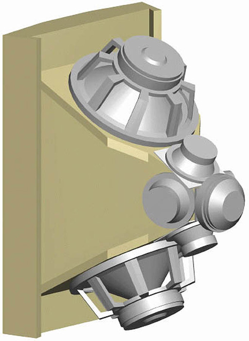

Ding,
You may want to investigate the Unity Horn from Tom Delany. A two way 60 x 60 constant directionality Unity horn will reach down to 300Hz, and a 3-way could reach down close to your 50Hz target. One time coherent constant directionality horn with very modest room interaction.
Your current thread mixes several radiation patterns which may be difficult to integrate.

Linesource,
Thanks for your input, I have the following queries.
By this do you mean the radiation patterns are different in shape from the 3 sources or that the sources are not coherent because they are originating from different positions.
If you mean the latter then that is correct. If you mean the former I tend to disagree. The polar radiation of a second order gradient is very close to that of a 60 degree waveguide and ofcourse the radiation from to 60 degree waveguides will be very close. Can you explain a little further.
How big is the mouth of a 50Hz unity horn. If I use conventional horn theory and place it on the floor I get a mouth size of 1.4x1.4 metres. Or against a wall and the floor 0.97x0.97 metres. This is pretty big and does not allow me to position the speakers where I wish (against a wall). Something which I consider important. I would have thought that introducing the low frequencys that close to the mouth would forfeit any control over directivity the waveguide has at that frequency anyway. Do you have a link to the page the 50Hz model can be found so I can read up on it a little.

Ding,
The 300 Hz 2-way 60 x 60 unity hors is 16.5" x 16.5" and aboout 14" deep.
A 65 Hz 3-way 60 x 60 unity horn would be about 29" x 29" and about 23" deep. A 40 x 40 horn about 19" x 19"
