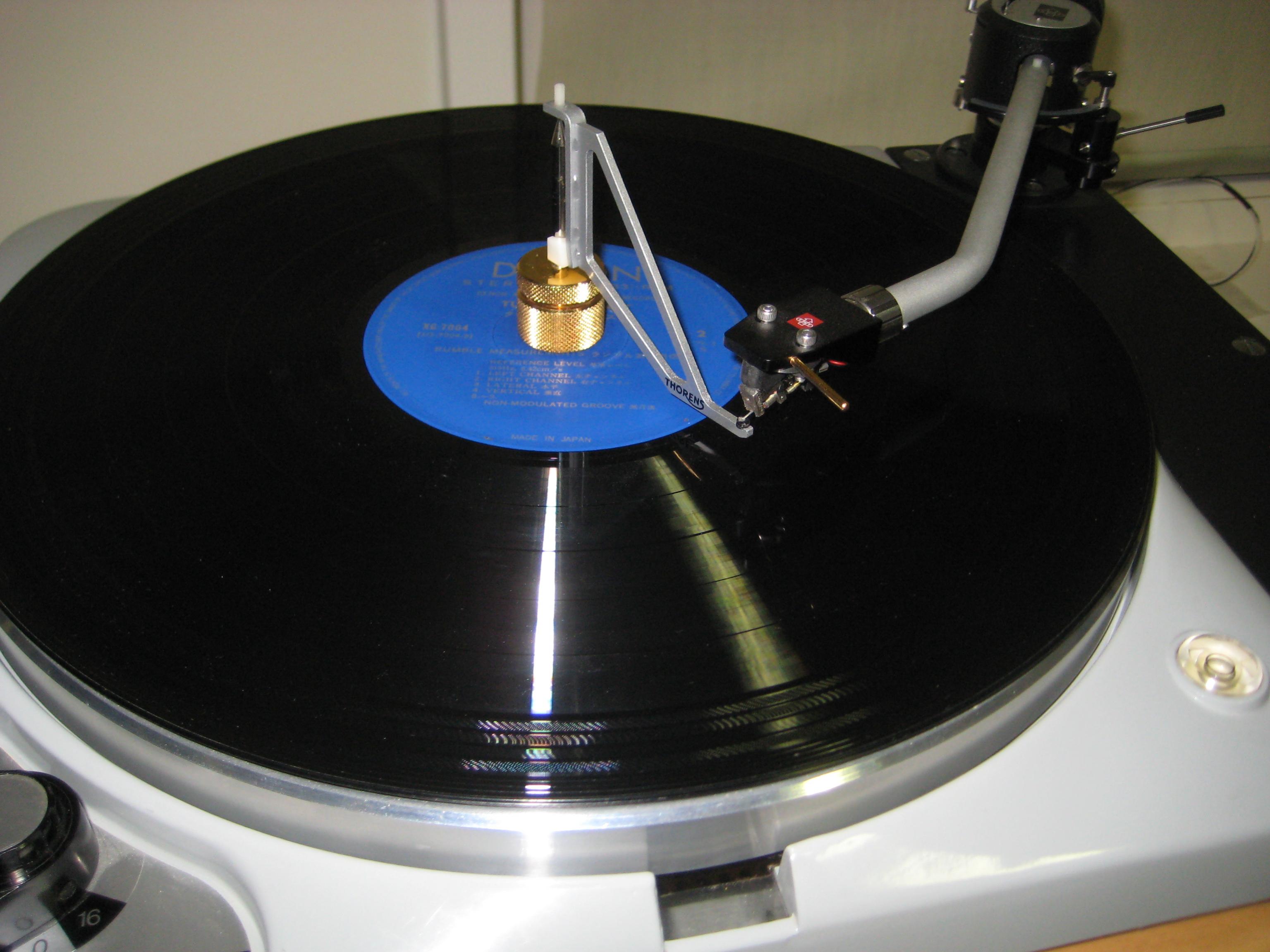

In this case I am measuring for rumble on my Thorens TD124. SN 2729.
The TD124 has been refurbished by yours truly some years previously and listening sessions told me that I had greatly improved the player in comparison to what it had been when I initially bought it. Now, however it seems appropriate to put a number on that performance.
Rumble is an important figure because it largely determines how much detail the player will be able to reproduce from the record grooves without being masked by the mechanical noises of the player. The quieter it is mechanically, the more pure clean music you hear.
With this in mind I considered a simple way to come up with a valid measurement. Here below is what I think works.
Above photo: Tracing the "blank" between tracks of HFN001 test record.
It seems important to choose a "blank" space that does not have a lead-in groove that will guide the stylus between tracks; like on a regular record. That is why I chose this test record. by recording this blank I can be sure not to be measuring any rumble that may have been imparted onto the test record by the cutting lathe that mastered this record.
The recorder:
I used my 2nd hand Masterlink 9600 to record a 24/96 file of the "blank" space. And I had it burn a CDR of this file.
Taking the CDR over to my PC, I used Audacity to analyze this sound file.
And it was the Spectrum Plot that gave me the above images. Frequency and Amplitude of the noise. The number (in negative dB) shown is closely in agreement with published rumble figures for the TD124. Probably closer to what a TD124 mkII will do, thanks to its improved motor mounting scheme. the algorithm shown was Spectrum. Whatever that means.:D

The first thought is gee, is the record blank truly flat? Just looking at the top photo I see that images in the blank regions of the disk do not reflect background as a truly flat surface would.
My first search for "turntable rumble measurement" brought me to this link, which on page four brings up very same topic of "subsonic surface irregularities".
They go on to mention that these are typically much greater signal source than motor and bearings, and that they excite resonances of tonearm system.
So, perhaps instead of record, optically flat surface is needed. Apparently when you are riding the grooveless blank region the anti skating mechanism is set such that stylus remains in smooth grooveless region.
Rumble in real recordings is dependent on smoothness of master cut by lathe, smoothness of lathe travel, and then further by smoothness achievable in pressed records.
In your frequency analysis picture "size 1024" refers to number of samples used for FFT used in transforming time domain into frequency domain. This only has marginal resolution for the frequencies of interest.
You should compare your result with using 1kHz test tone.
Otherwise, yes, your test methodology is apparently very similar to that used in the industry, at least back in the 70's.

thanks for all of the replies...
To respond to some:
1) Method: Yes, this process records the subsonic signals generated by the less than perfectly smooth uncut vinyl. But keeping in mind that under the best of conditions, this vinyl can be as flat and will tend to mirror the surface roughness of the stamper die that pressed it. With that considered the HFN001 copy I have appears to be a very flat record,..... as far as records go.
2) Right. This method can not be compared directly to any published "weighted" values that turntable manufacturers used to reference back in the day when rumble measurements were actually taken. As I see it, its' only repeatable reference will be within the scope of my own listening room while using the same group of equipment. Example, using the same test conditions while recording from a different turntable. then comparing the spectrum plot generated between them. Or, better yet, same turntable after refurbishment has been carried out.
I have to admit that I thought I'd see a "noisier" decible figure from this TD124. something around -40 db weighted would have been appropriate. And my spectrum plot is, I think, unweighted raw data. Even that is useful provided the same conditions of the test are adhered to from one player to the next.
3) The Masterlink. It would be possible to feed the line level signal coming out of the phono preamp directly into the sound card of a suitable PC. Thus eliminating the need for the ML9600. However, not all PC sound cards are created equal. Some are more agreeable with audiophile pursuits than are others. In my case, I just have standard issue sound cards on the computers in my care. The Masterlink, on the other hand, was designed to record high quality sound. So, on that general assumption, I presume it to be as good a bet for getting the "unpolluted data" into Audacity as any other available to me. also, this particular model is long out of production. It was expensive when new. but now, 2nd hand samples may be found and purchased for around a few hundred usd. And that is how I got mine.
4) known signal. The test records I have are rather limited. Two of these offer tracks with unmodulated grooves. The HFN001 record calls this track system residual noise. An older test record I have, Allied Radio, calls their unmodulated groove track a rumble test. but when you look at that track in good lighting it can be seen that there is some very slight modulation within those grooves. Rumble from the mastering lathe. But the HFN001 record does not show any visible evidence of modulation within its residual noise track.
It has been suggested that I use this method to analyze a 1000hz signal. Unfortunately none of the test records I have offer this. Although the HFN001 does offer a 300 hz signal at various different amplitudes. I suspect that a steady tone signal could be used to examine more than the mechanical noise of the turntable. But it could be used to determine performance in the domain of time. Like wow and flutter. So it does seem like a good idea to get a test record that does offer a 1000hz track. Fwiw, the Allied Radio test record (actually 3 records) does offer some wow/flutter tracks. These consist of a single piano note being sustained. This is probably useful for computer analysis. I'm just not certain what software would be the best choice for this test. (wow/flutter)
