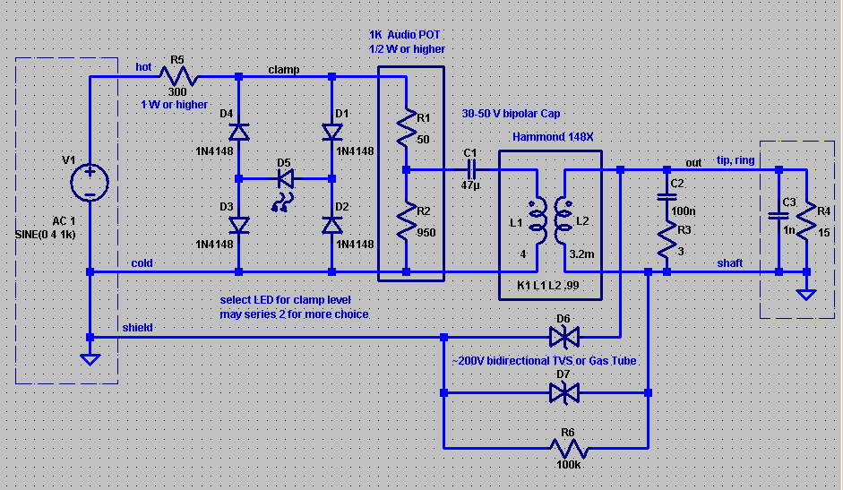

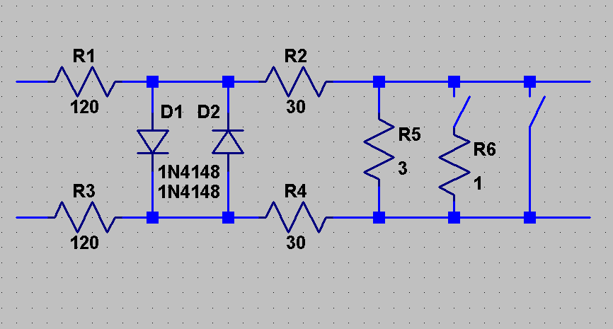

a pro xlr output could go up to +26 dBu (pro line level units are weird to EE types - but basically is saying the output could produce 400 mW into 600 Ohms)
the iem only need 1 mW to give deafening 122 dB SPL in your ear
so you are starting with over 100x too much power/Voltage (yes not the same but lets not overload the op more than I am already) from a pro mixing board output for the iem
deliberately wasting power in a R divider is the cheapest solution
30 Ohm iem probably are "well driven" from ~< 3 Ohm source
so a divider with 3 Ohms in parallel with the iem and say 300 Ohms in series probably puts you in the right ballpark for adapting these sensitive iem to pro audio outputs
other questions are whether the monitor mix aux setting should be the only volume adjustment needed - or if you should have one or two local stepped attenuation switches (and probably mute that you can get to quicker and than yanking the iems from your ears)
the actual V needed by the iem is low enough that shunt diode clippers tapped into the 300 Ohm series R is an option
the pics seem to show a TRS connector for the iem - which means the R,L ground returns are shorted together - but good pro output is balanced - you may need to have the stock TRS connector replaced if you want to plug into balanced outputs
this can all be done without amplifiers, power source - any small project box, Altoids tin or even inline in a XLR inline cable connector shell depending on switching options (local attenuation, mute)
quick sketch - values need to be worked for your exact monitoring drive situation

hello again and thank you all for your input. words cant express my gratitude for your willness to help me. god bless you
ill answer Avro Arrow's question first, as the answer is easier.
no my friend i do not want to use a wireless iem system. first of all it is too expensive. and second of all since we 9 out of 10 times, have our own sound engineer, it is easy for him to send me my monitor mix through a cable. and then i somehow hook up my iems. (how i do that, is the reason i started this topic though).
bottomline line is i am trying to immitate the function of a wired iem system, without having to amplify anything, since jcx clearly states that it isnt needed!!!
now to jcx's amazing post
i would be lying if i said that i understood everything you said.
i understood really well that we need to have the voltage dropped. and that i dont need a headphone amp!!hooray!!!
i liked what you did with the schematic my dear friend, (though it isnt all clear to me). i really liked the idea of a mute. what i would also think that would be awesome, would be a volume switch, so that i can adjust the volume by myself. this is a must have. i suppose that it is achievable right?
about the balanced and unbalanced signal, i got half of it. i wouldnt want to screw up the jack of my iems, but i guess a little diy box that can transform between balanced and unbalanced signal would be the right way to go,am i correct?
so, to put it in simple words, in order to use the iems for the job i need (aka gigging), i would need 2 boxes. one that dropes down the voltage and watt to one mwatt approximatelly and also has a volume switch, and one box that can do the balanced to unbalanced and vice versa transformation. is that correct? (i forgot to say that if i correctly recognised that you put 2 diodes in the schematic to be used as a limiter, this is wayy cool!! thank you)
my last question about this, is if the quality of the signal, my iems will receive, is quality enough. i hope that no hiss or distorted sound is created through the 2 boxes my bassist will create. thats the reason i will buy the iems in the first place!!!
if i understood everything well enough, if there is a link or schematic i could use for the balanced unbalanced box, it would be really appreciated!!!
as i said before, my bassist will create the box-boxes for this diy project.
i gave him the url of this thread, he read it carefully and has some questions. i will copy paste them here, i hope you can help him.
since the audio signal i will be receiving from the mixer will be balanced, do i have to put a balanced to unbalanced conversion before the schematic you sent? As far as i have understood the bottom rail in the schematic is the ground rail. Also R6 could be swaped for a pot - volume control?
Finaly, the signal i will be receiving is usually in mono. What is required to duplicate it to both iem.

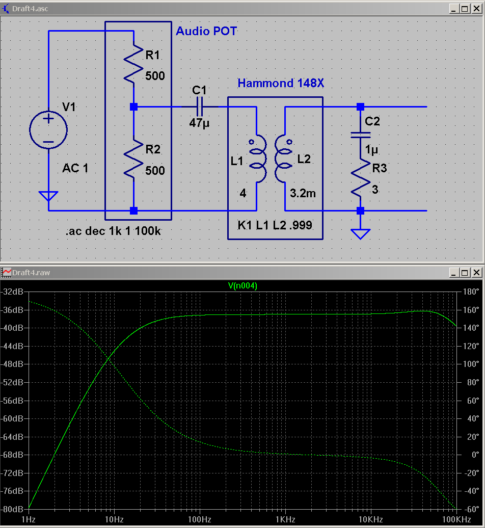

A volume pot complicates things – they just aren't made at such low Z
putting the volume pot in front of a audio step-down transformer looks do-able
it turns out Hammond makes small low Z audio output xfmr
Hammond 148X is 4k:3.2 Ohm, 300 mW output – since you need <<1 mW this xfmr will go way below its 200 Hz spec at the reduced operating V level
these apparently ship from the factory whoever you buy from - 5 in factory stock
http://www.digikey.com/product-detail/en/148X/148X-ND but Newark promises 3 days from factory
next would be locating a low Z log taper volume pot – preferably plastic element but with the power rating to plug into a pro line level output
to keep the low frequencies when driving the xfmr primary you really want low Z, << 4kOhm xfmr pri impedance rating – a 1K pot would be nice
http://www.digikey.com/product-detail/en/91A1A-B28-D10L/91A1A-B28-D10L-ND might work
another option would be to parallel both sections of commonly available duals, paralleled dual 5K probably is easier to find
other things to toss in, play with with actual xfmr in hand:
DC blocking C, maybe a Zobel load to flatten high frequency response to get to the spec'd 15 kHz without peaking
and the mute switch, maybe a level pad
need more info (measure real part) on 148X xfmr to be accurate
low frequency extension and distortion should improve as drive levels decline
really an't say much of anything about leakage L, winding parasitic C that sets the high frequency limit without having the xfmr on the test bench
this may be a start for topology/values:

I might add a couple of TVS or Gas Tube Surge Arrestors and a charge draining R across the transformer pri-sec since the transformer pri-sec insulation is only rated to 250 V and the iem could serve as ESD antenna - probably best terminate to the shield of the XLR
my 1st thought would be to go with near 200 V surge arrestors to give the most use of the xfmr isolation rating while still protecting it from insulation breakdown
the volume pot makes it harder to find a good place for diode clipping since a goal is to keep the drive Z to the xfmr pri as low as possible and a simple passive clipper needs added series R
higher drive R increases low frequency distortion from the cheap core material
but since the application is only Rock and Roll maybe the clipper is more important - you tell me - what max SPL level would be expected in a clipper?

more complete drawing
the parts in the dashed boxes are just for the simulator
the clamping level is set by D5 - can be a LED or 2 in series
my sim shows for ~ 120 dB SPL the clamp LED should have ~ 4Vfwd, ~50 mA peak - lots of options, easy to select from Digikey tables
but the peak current is higher than many "indicator" LED ratings so can't just use junk drawer parts - must look at datasheet
LED Vfwd varies with color, type of semiconductor material - for 4 V probably would be bule or "white" - which is a blue LED with some phosphors in front
make sure the surge arrestors are bidirectional - equal clamping V both directions
hello my dear friend. we thank you so much for your contribution to our project. finally we are in the process of ordering the components from mouser!!!
our bassist has the basket almost ready for order. but before he finalizes our purchase, he has 2 very important questions to ask you, so that we can order the right parts. here they are
question 1:
The input and output jacks should be plastic so that the sleeve does not touch the metal enclosure? Shall this apply to both input and output or only one of them? (our sound engineer told us that he will send us balanced TRS)
question 2:
We have trouble narrowing down our choices concerning the TVS. The 200V you specified are the breakdown voltage? What about the other two specifications - operating and clamping?
thank you so much, you are definitely the ultimate diy guru!! we would be lost without your guidance! god bless you
question 1:
question 2:
carrying the chassis/shield gnd through from input to the headphone common output is an option - then the surge arrester and charge drain R aren't needed
I suppose 1/4'' TRS balanced patch cords are commonly used - but I dislike the idea, would rather see XLR
at least the iem headphone out can be 1/8" TRS jack/socket so there's no way to plug backwards
except for the 1/4" - 1/8” TRS adapter that comes with the iem - lose it if you go for a 1/4" TRS balanced line in jack on your box
the Mouser page for the Bourns 91A1A-B28-D10L has the power rating wrong - the single section conductive plastic Audio taper is 1/2 W
